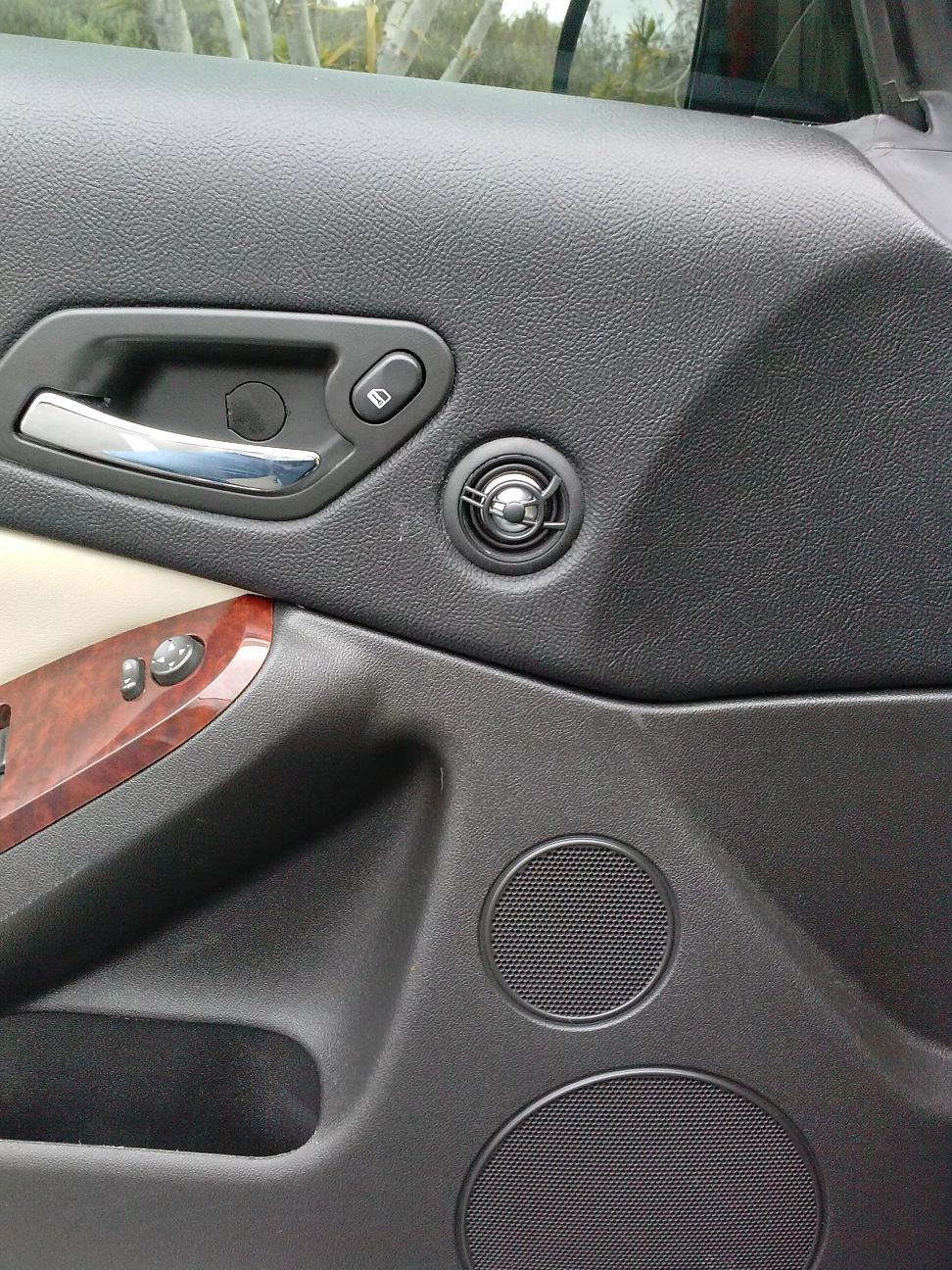

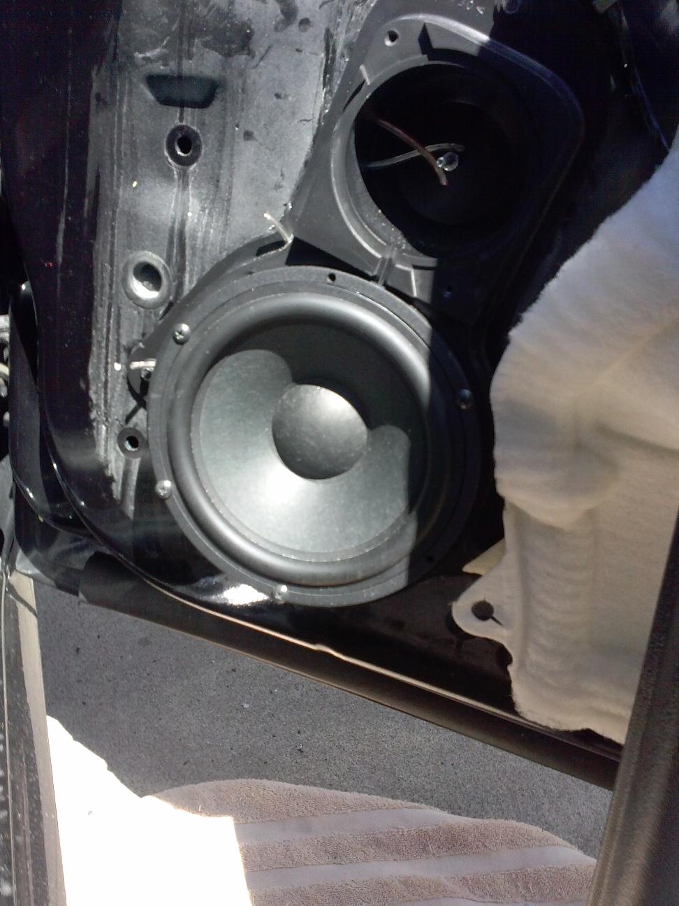

So far I've done the front doors - which have the Silver Flute W17RC38-04 6.5" 4 ohm woofer and the SEAS Prestige 27TAFNC/G (H1397) tweeter (Zaph/Linkwitz).
The woofers were a perfect drop-in in the factory location, with a few extra screw holes needing to be drilled. The tweeter presses into the slightly (and carefully) enlarged factory tweeter door panel cutout, and just looks cool.
The factory system is 2 ohm, bi-wire, and I used no crossover components - not ideal of course but with a factory crossover of unknown specs I'm not going to try to measure and calculate filters - not my area of expertise and they sound awesome anyway - excllent pairing of drivers.
