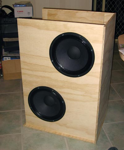

Here's a couple of progress shots.
Mark

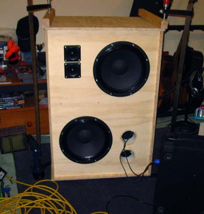

And another.
Tweeters haven't been connected yet.
So far I'm very satisfied with the sounds it makes.
The neighbours probably aren't quite as thrilled.
Especially considering how badly I play!
Mark

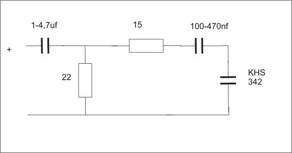

Here is the schematic for piezo crossover. Firs C and 22R are high pass filter. 15R is your resistor which you wanted to put. The C2 (100-470nf) is for lovering piezo if it is louder then bass. That KHS342 ignore, that is some no-name brand piezo.
All resistors have to be at least 10W, i put 17W.

Try connecting piezos parallel and listen if they are louder then bass drivers. If they are louder then you have to lower them with cap connected in series with piezos. That cap is on schematic marked with 100-470nf. With 100nf they will be quieter then with 470nf. If you have to use this cap it has to be MKT, MKP, type. Don't use ceramic (those round yellow-orange colored one)
To recap all this: In the schematic the most important elements to use are first cap and R, like i have mentioned previously, it is high pass filter and it uses to prevent damage of piezos. Like it's name say it passes high frequencies to piezo so less voltage will go to piezo.
You can connect piezo directly without filter but it will not last long if used with loud volume 🙂
