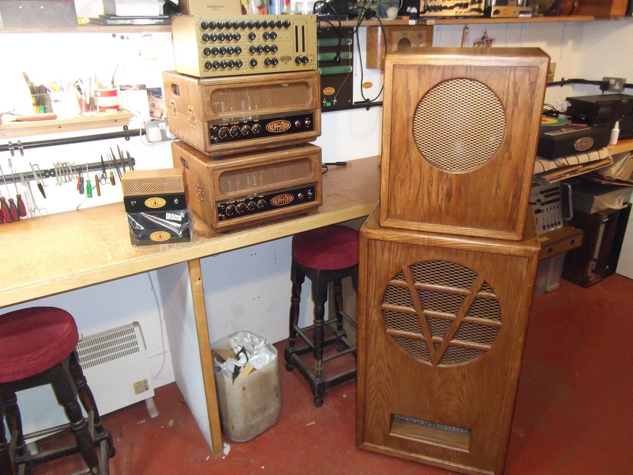

I actually know somebody in the UK who build vintage high power soundsystems with tube amps. His name is Paul Axis, and in the UK and the rest of Europe, he is very known in the reggae scene with his Axis Valv-A-Tron soundsystem, wich is a custom build full vintage tube amp driven soundsystem that plays old reggae. But he does build for others also. He has a few predesigned systems that he builds on order, and works sometimes on full custom stuff also (speakers, amps, preamps, ...). I was a few years ago at a festival where he played and did overpower a 40kW modern (line array) system with his 3kW system.
Your rooms is in metric 9x20m, so i think that a stereo setup of his predesigned system (one or 2 towers on each side) could fill your room aquedate. It's only 200w for each tower, but it goes very loud. Maybe talk to him and see if he can do something for you. He's surely one of the best in Europe for building full tube high power systems. The system he did build seen in the picture (1 tube phono stage, one dub preamp/mixer/crossover, 2 100w tube amps and a top and bass speaker) was recently sold for 8500£ + transport.

And if you don't want tubes (wich i can undestand because it's not easy nor cheap to maintain), you can replace those with class AB amps with mosfets as amplifing device and a linear power supply. That is how high power amps were untill class D came availeble in high power in the 80's. And using dual concentric and horn subwoofers is indeed a good id like some suggest above. Altec Lansing, older JBL and older Turbosound are those top brands to look at then if you ask me (to buy or to clone).
But i would avoid class D, line arrays and dsp. Those give the modern sound that you don't want. The least disturbing of those 3 would be class D amps for a vintage sound.
For mics, i would stay dynamic for a vintage sound, no condensors but for the drum overhead. Shure, Senheiser, EV, ... are brands to look at. An exception on this is for jazz singers, they can benefit for a condensor or a ribbon mic but in most cases something like a dynamic Senheiser MD441 does the trick also. I'm a former soundengineer (before my back killed that carreer) and when used right, dynamics are mostly better live than condensors or ribbons in my opinion, even in a studio that is often the case.
