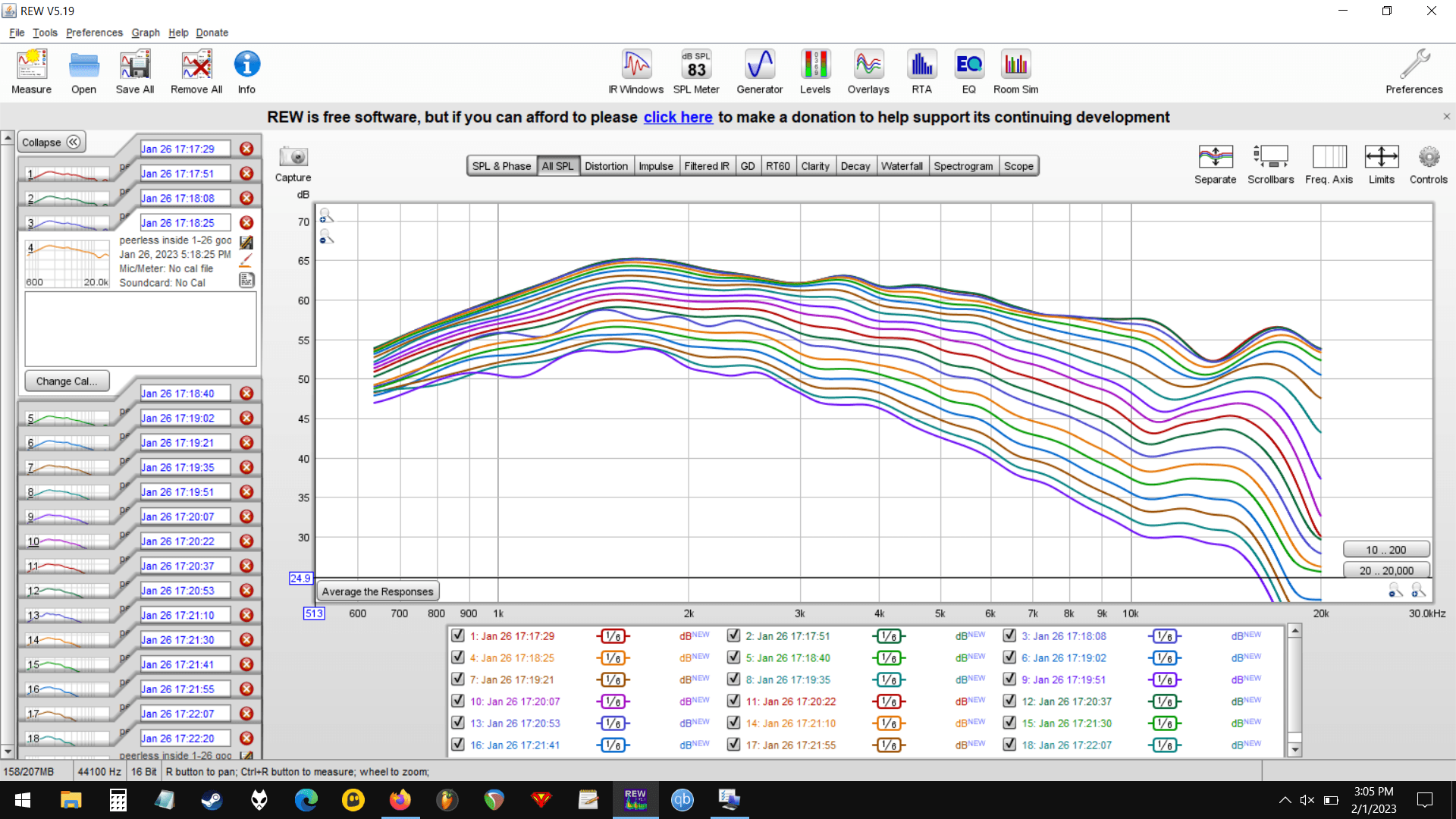

This is what I got with a dx25 on a typical 7-8" baffle. Looks great, but sounded really narrow in the top end, like the sweet spot for the stuff around 10k and above was very tiny. Also noticed a lot of change when moving vertically.
