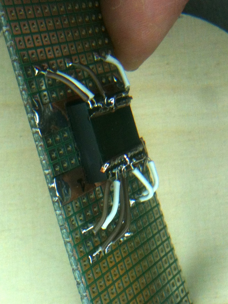

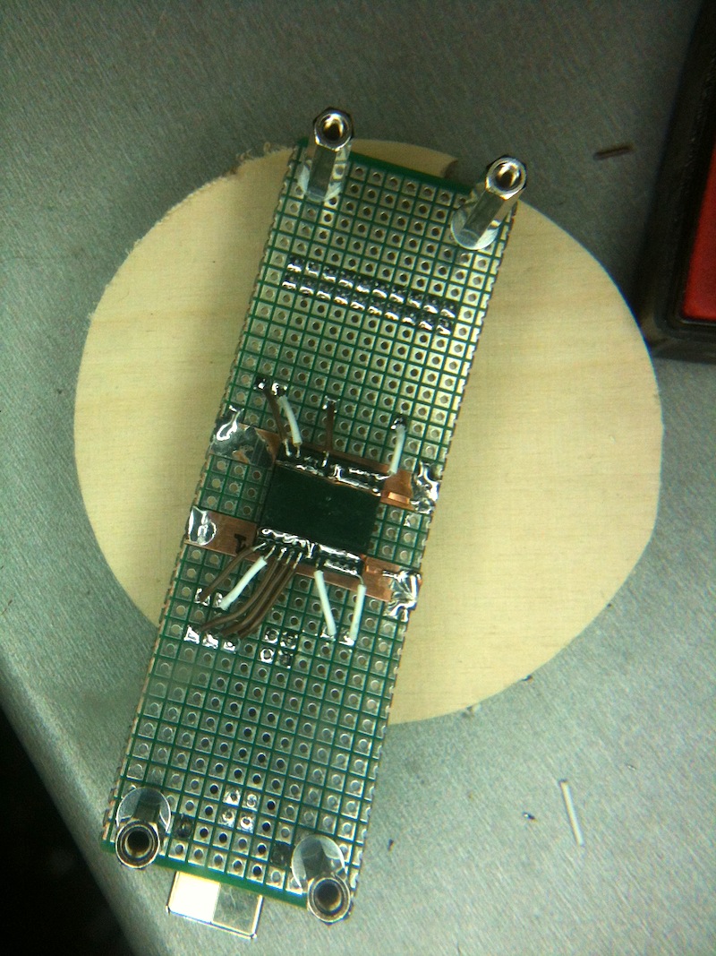

I have been tested LTM2884 in a simple quick board.
Mac OSX platform.
I tryed with USB power and external power.
The power isolator working good all test poins showing right value from datasheet. BUT.
Flash USB drive 32Gb WORKING. Detected on the desktop.
Usb mouse - NOT.
Amanero usb audio - NOT
(I will try with USB HD)
So I can say that LTM2884 is not working with audio usb interfaces.
On OSX it is not detected as present device in audio-midi settings panel... 🙁
I dont know why these USB isolators simply does not want recognize USB audio interfaces?

If it works with a flash drive and not a mouse it could be that only bulk and control endpoints are working properly, not interrupt or isochronous.
I didnt add the pull down resistors at input and on pull up R at the output.
Because they said that it has automatic speed detection?
But I will try...
