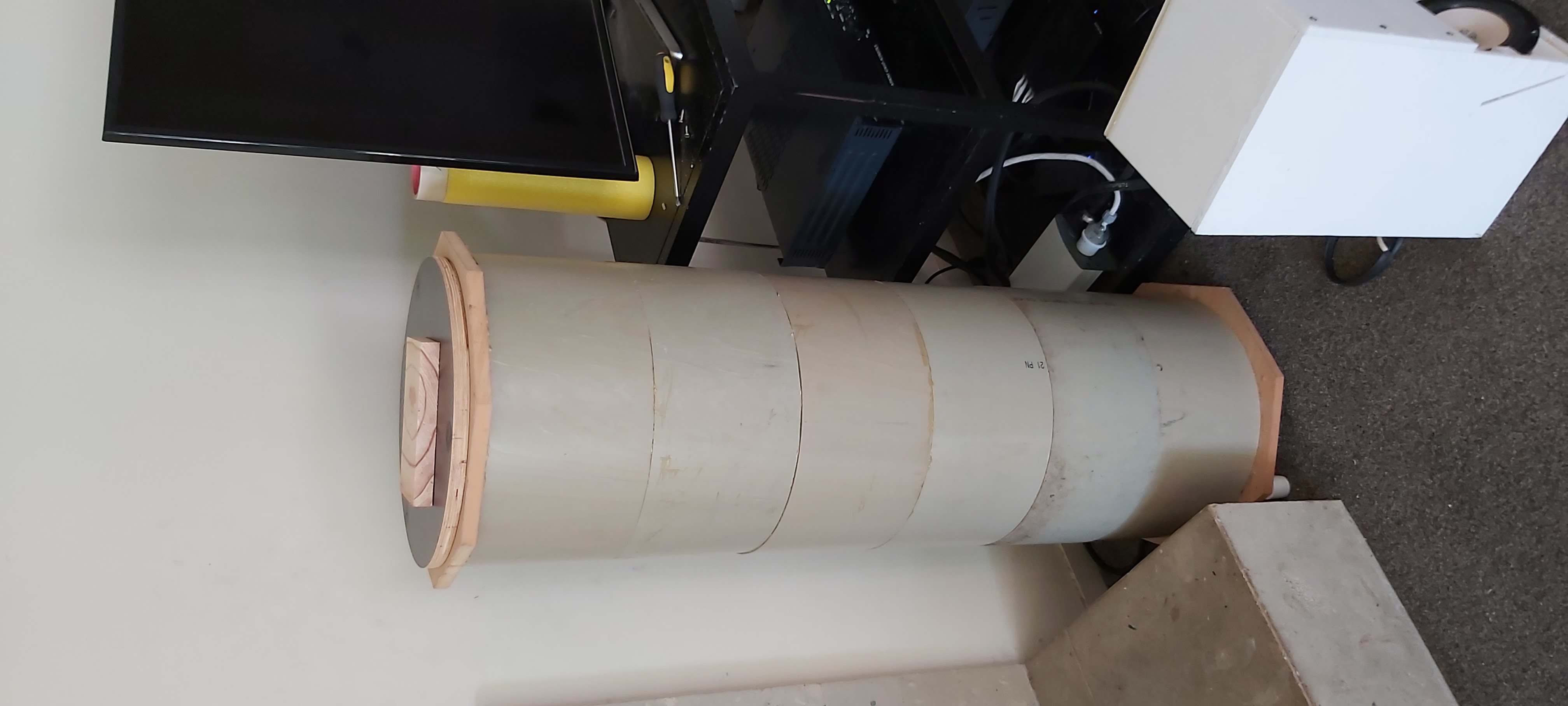

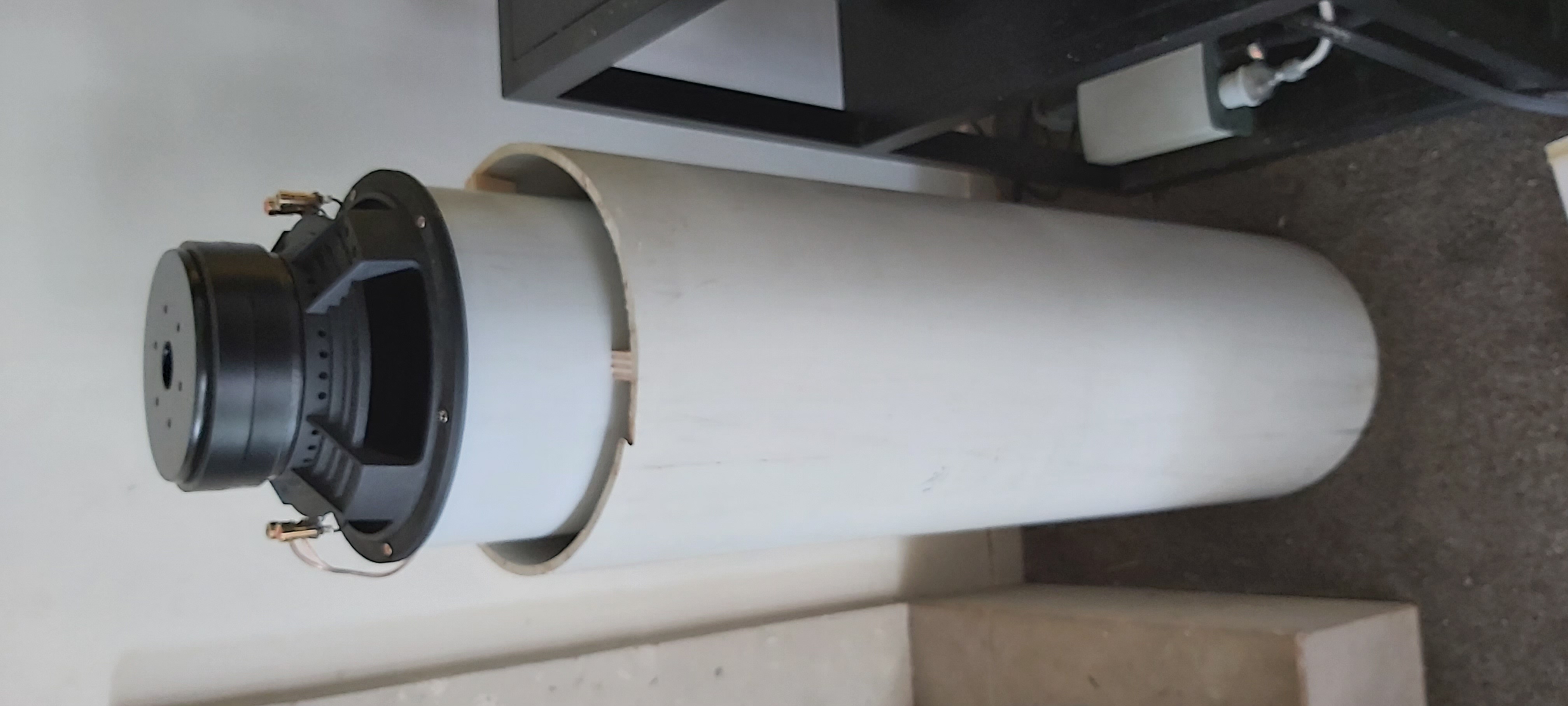

So here is the latest incarnation, with two folds, three pipes, and it now has much more bottom end. You'd never know there was a 10-inch driver in the middle of all that pipey goodness.
It's into the 20s in room in all likelihood, getting about as low as the big TL box, which is tuned to 25Hz.
At present the rings in the outer stack are just sitting one atop another. I shall glue them together today which should rid it of any air leaks. And create some sort of more aesthetic top cap! Not that it will win any beauty prizes even then.
First photo a bit blurry, second better.
I had another idea too -probably silly but there you go - which I should try given how easy it is to implement. At present, the RSS265HO-44 is right at the beginning of the line, attached to the top of the innermost pipe.
It would be no big deal at all to reverse its position and slot it at the bottom of the first pipe, upward facing, and resting on a few bits of thick foam so as its vent isn't blocked.
That way it is one-third of the way down the line, as it were, approximately. No harm in trying.

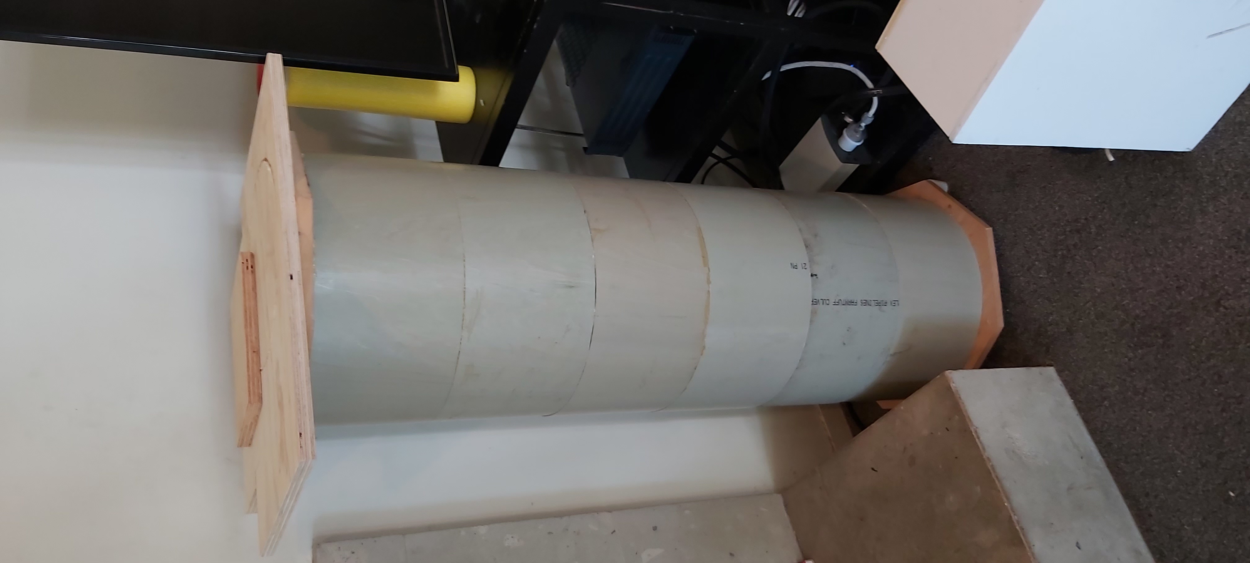

Will rip the scab off the top and insert the black end cap.

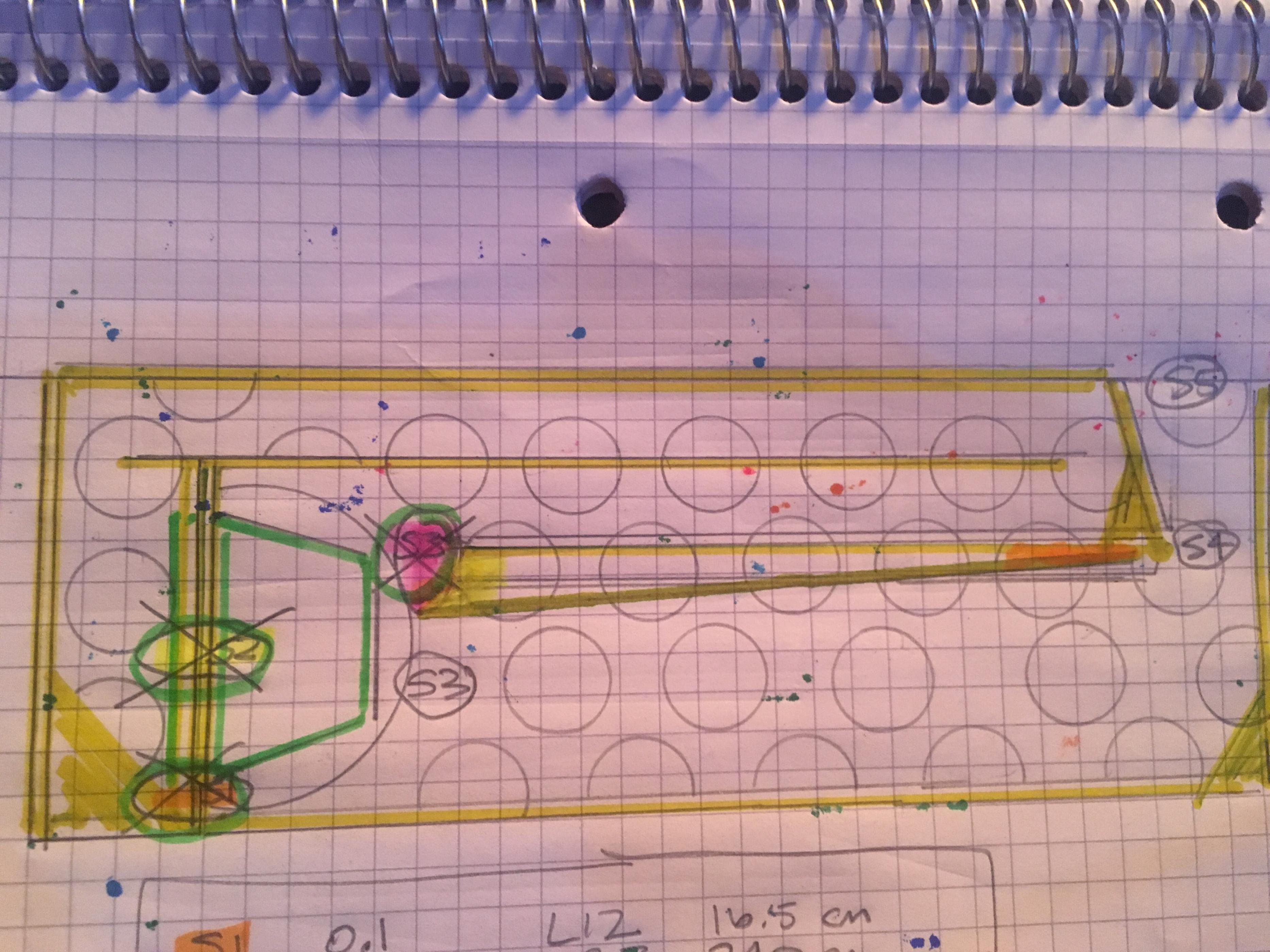

If you keep the first section as small as Vas will allow, you can exploit the horn shaped acoustical gains after within reason. If the motor will allow it, it gets pretty radical to chase the iron law(lots of sir is hard to push!). 390ho4?

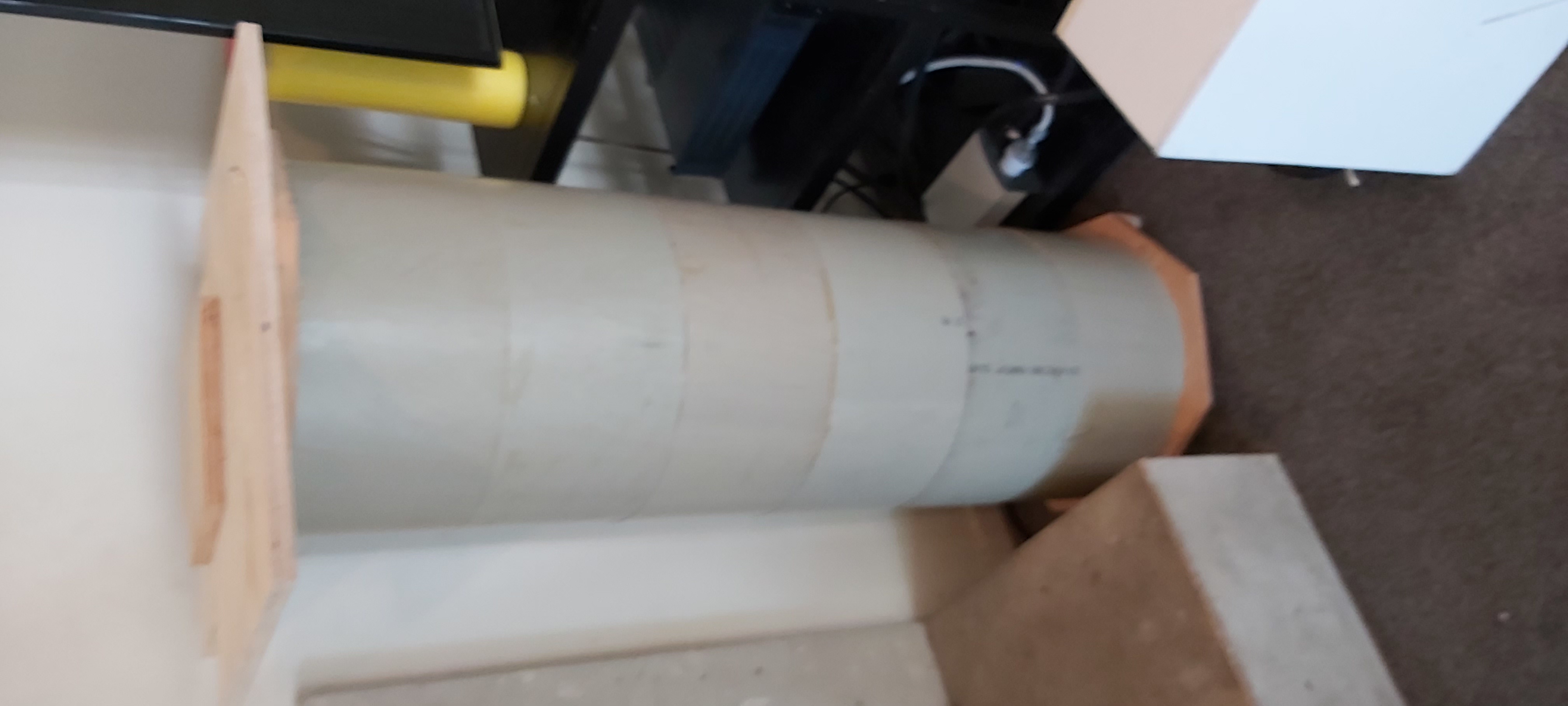

The pipe is 490cm2?
Odds are more likeky im wrong, but i kept tripping up on the pipe fitting the driver myself, with no coupler, etc? 248cm2 at 350cm as a generic simple qw pipe for the Fs@qts and Vas (as CSA and length). it can be a tapped pipe or an offset driver with minor tweaking from there. i cant really help, i dunno any pipe or national pipe sizes overseas?
So just to be clear the inner pipe to which the driver is attached at the top end is 233mm internal/250mm external diameter. No coupler; it literally screws into the top of the 1m long pipe (39.5 inches).
The outer pipe is 300mm outer diameter, 284mm inner, and 97cm tall.
And finally the third pipe which goes over the top of those two (nesting the others then) is 400mm external diameter, 380mm internal and is 1165mm tall.
See pics below to get a better idea.
And GM the elbow is gone; the 400mm pipe 116.5cm replaces that!

With the pipe stuck in a pipe as you stated, the 80cm2 left available outside the first pipe path is less than ideal, if not a impossible to be useful. Even as a bass reflex it would be a bit small in CSA ?
Stop using diameters to describe a cross section.... length(start to end of pipe) is equally vital but it is the Length for qw tuning Fb. Nobody us gonna want/need ‘diameter’. Cm2 is used at a cm length, as a pipe shape, to tune the sound wave. Diameter is useful in turns/ folding, but is only further confusing me😀 ‘Sd, S1-S5, Atc, Ap....’ all in cm2 in a qw simulator of AREA. at a stated length (not diameter) which together create a measure if Volume. or changes in it as traveling through the pipe toward exit or into chambers, etc.?
