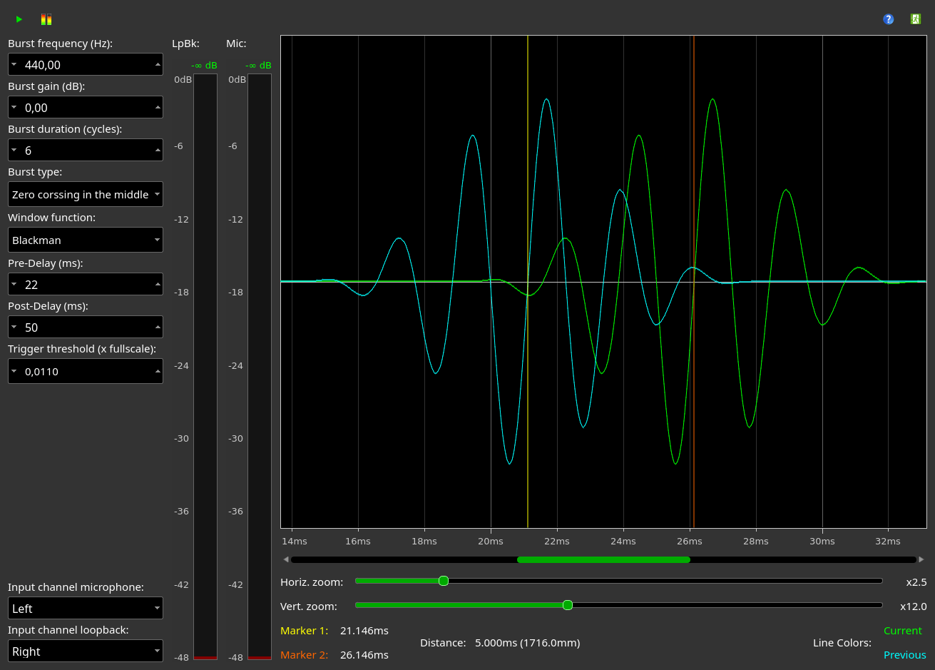

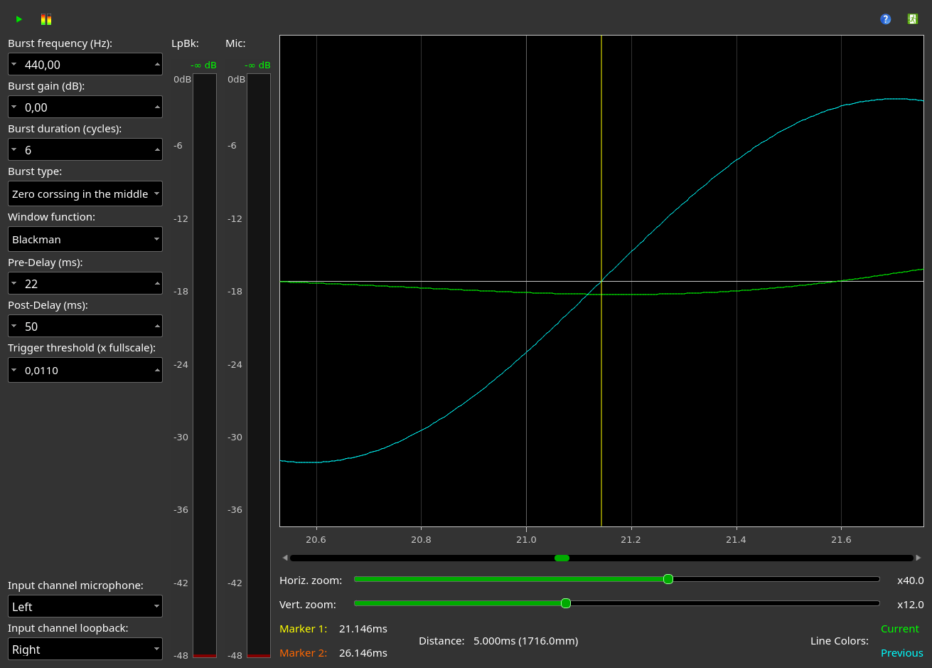

We spent saturday afternoon and evening to align a 5 way horn system using wavelets. I have two questions about the method and the resulting phase measurement.
1. When using wavelets I would assume that you set delays of both speakers so that the center of the wavelets align, not the first sine peak as shown here (From top to bottom: 1. original signal, 2. low-pass filtered with LR4, 3. highpass filtered with LR4, 4. sum of both filtered signals):
The green line IMO shows the correct point to align them, the red line clearly shows that this point in time would be ambiguous as the low pass filtered signal has a longer period length, the high pass filtered one has a shorter period length. only point they sum correctly is if the center of the wavelets are aligned. All in all that should be plausible, the summed signal also shows a 180° phase shift at the crossover frequency as is to be expected from a LR4 filter.
Are my assumptions correct?

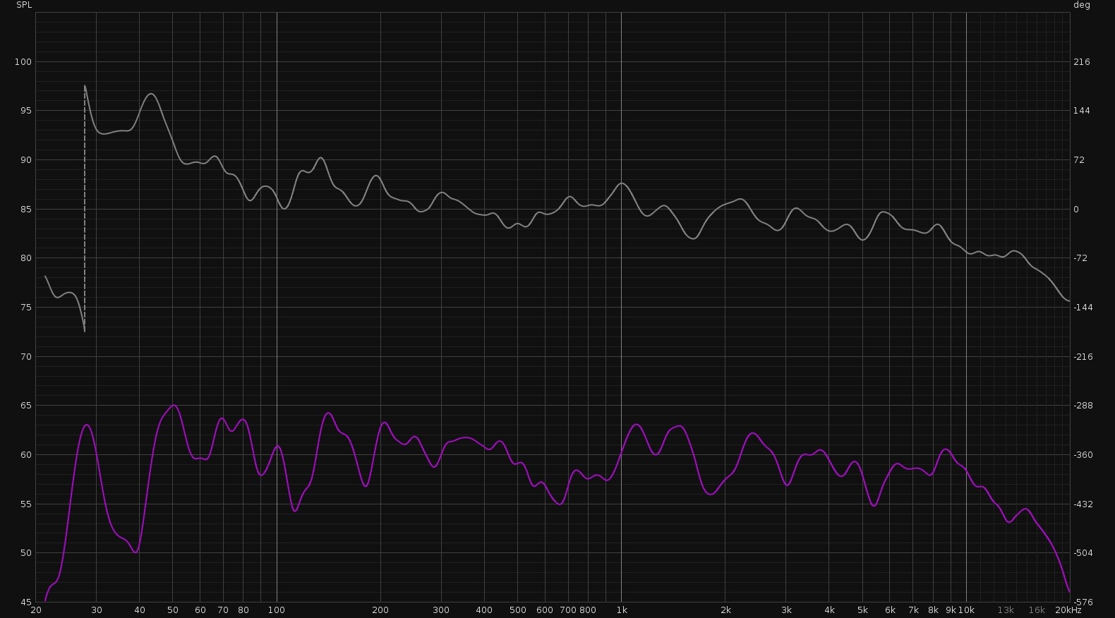

2.: Here's the minimum phase as generated from a measurement in REW for the whole system at the listening place (grey: phase, axis on the right - purple: SPL, axis on the left):
I thought that each of the 4 LR4 crossovers would show a 360° phase shift around the crossover frequency? Why does the resulting phase appear to be almost flat from 20Hz to 20kHz? Seems that either something is off here ore my assumptions about the 360° phase shift of LR4 summed signals are incorrect. OTOH as I pointed out the top graph clearly shows the 180° phase shift at the crossover frequency for the summed signal. I'm a bit puzzled here. Maybe I misunderstood what the term "minimum phase" really means, would these phase shifts from the LR4 filters not show up in the minimum phase plot?

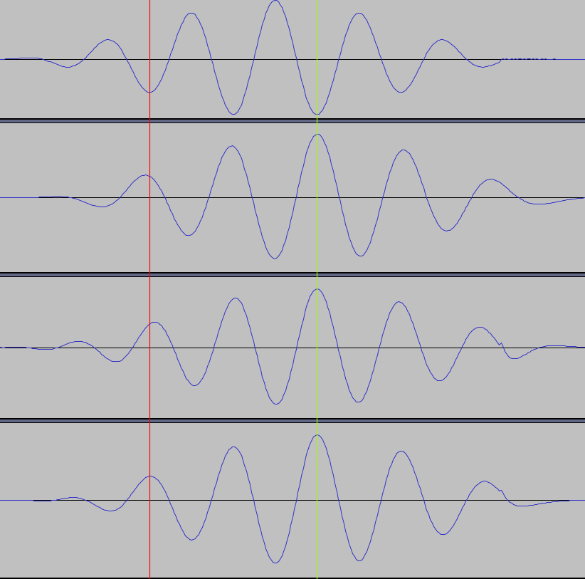

Hi, looking at the wavelets, my take is #1 the original signal is pol+. And #2 with 24LR lpf, and #3 with 24 LR hpf, are also pol+.
Looking at the green timing line on #1, it's not at the center peak of the burst, so it looks like there is a constant time delay shift with the hpf and lpf in place, and not a 180 degree phase shift (which would be a change in pol).
With a LR4, that has an180 degree phase shift at xover freq, it will still measure pol+....... with a positive central wavelet peak
I do think it is correct to time align the center of the burst waveforms....like you say, they have different periods.
Caveat: I don't have a tremendous amount of experience with wavelets, but i'm largely confident in all that.........

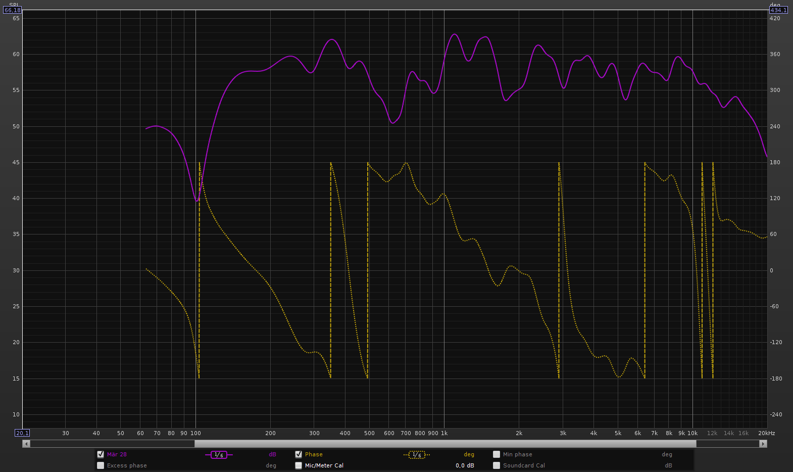

And This is a 5-way? With four LR4's in place? It appears you have to be using linear phase LR4's?

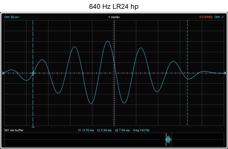

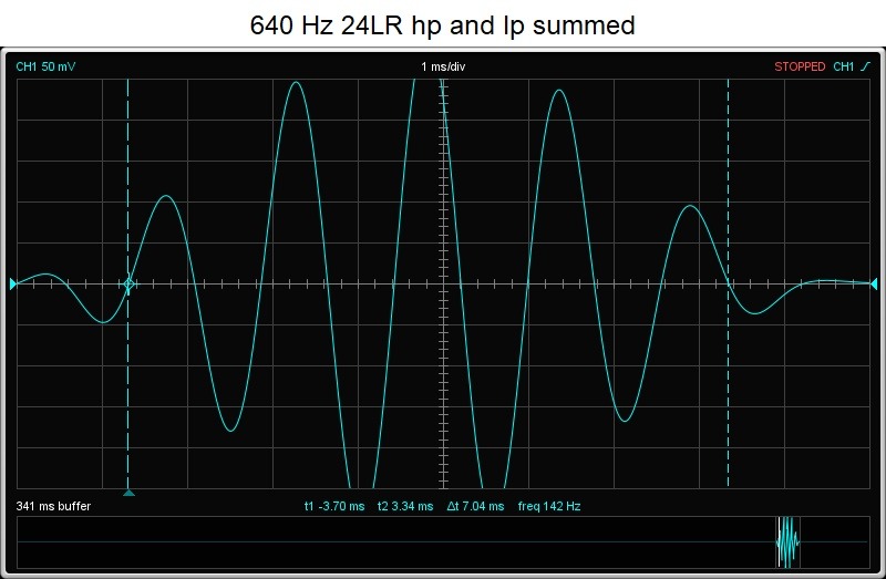

Here is 6.5 cycle Hann burst 640 Hz, both sides of a LR24 crossover summed together.
Vertical goes off the scale, where next two with high pass and low pass show the drop in amplitude.

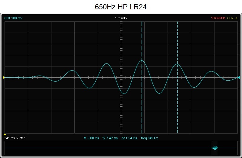

Next is with the 640Hz LR24 high pass in place.
Note the scope cursors are in the same places, with the same time span 7.04ms between cursors, across the same wavelet zero crossings.
The high passed capture shows less time across the burst than the full spectrum capture above.

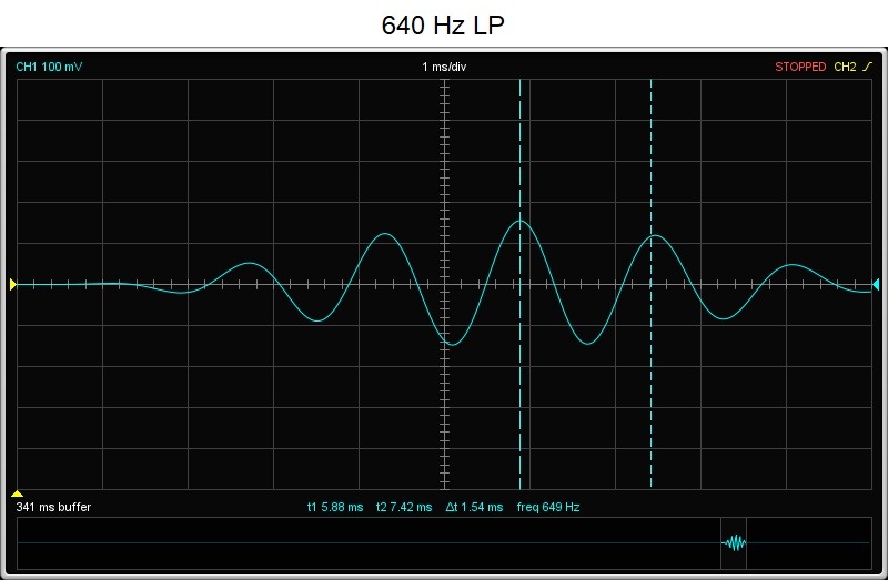

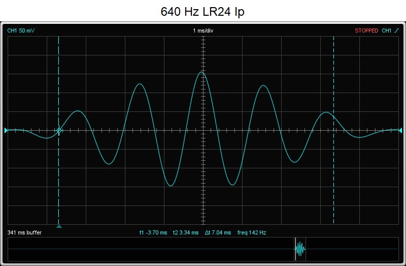

Now for the low passed burst.
Note that it is longer than the full spectrum.
So comparing the high passed to the low passed, the wavelets overall period clearly gets longer with the low passed.
Aligning the central peaks, and ignoring zero crossings, has been the way to go ime.

Here is a set with cursors unchanged, set to show once cycle of a 640Hz 6.5 cycle Hann burst.
First is with no filter.
Next is with LR24 high pass @ 640 Hz.
Then LR24 low pass @ 640 Hz.
You can see the period defined by no filter is longer than with high-pass in place, and shorther than with low-pass in place.
And central peaks are all aligned.

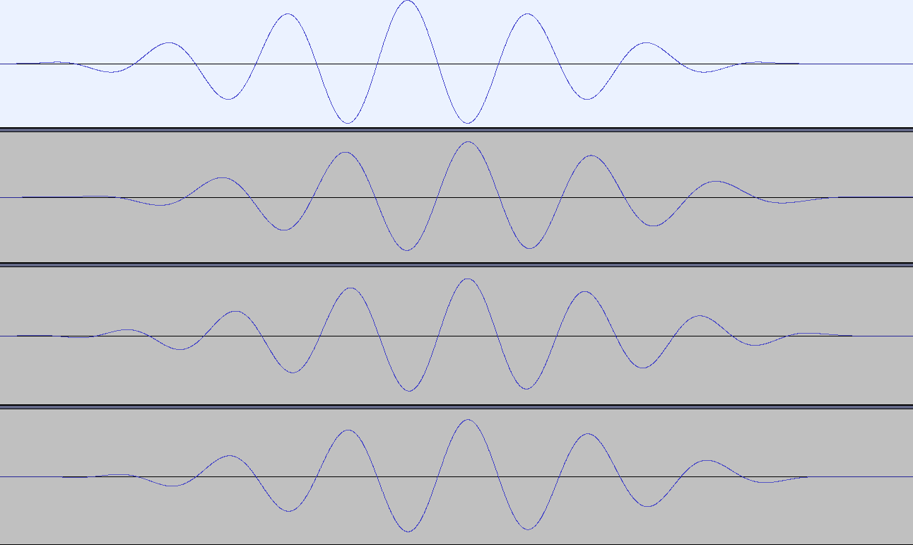

I made these examples in audaciy and the glitch was probably me moving things around unwantedly. I carefully redid the whole process and here's the result, no glitch at the end:
@MarcelvdG : thanks for the explanation of minimum phase, I think I got it now. The question is how do you measure the actual phase response of a multi way speaker system in REW? I fiddled around with the existing measurement data, set a 15ms impulse response window to get rid of most of the room's interaction (should be valid down to around 100Hz) and adjusted the time offset to give me the most sensible looking phase response (not minimum phase). But that procedure is a) painful and b) really really feels wrong! Here's the result:
At least now the "wiggles" in he frequency response somewhat correlate to "wiggles" in the phase response...
Any suggestions?

I can't help you much, as I know nothing about REW and almost nothing about wavelets.
I don't know if this helps, but what I can tell you is that the phase response of the sum of the low-pass and high-pass outputs of an n-th-order Linkwitz-Riley filter, with inversions where appropriate, is the same as the phase shift of just the n-th-order Linkwitz-Riley high-pass or just the n-th-order Linkwitz-Riley low-pass. It's also the same as twice the phase shift of a Butterworth filter with order n/2.
A Linkwitz-Riley low-pass or high-pass is minimum phase, unlike the sum of both. (The sum has a flat magnitude response. You can also obtain a flat magnitude response with a short straight wire with no phase shift at all. Hence, the phase shift of the sum of the outputs goes beyond minimum phase.)

OK, seems that my theory about aligning center peaks was correct. You can always generate a wavelet with half a period more length and you get a wavelet that is centered around a zero crossing, which is what ARTA does. Probably because it's better to align on a zero crossing.

Yeah, either zero crossing for integer cycles, or central peak for half-cycles works fine.
I tend to like the half-cycles because their is mirror symmetry around the center Y-axis.
Whereas with integer cycles, there is symmetry around the Y-axis, but the sides are inverted to each other and it makes it harder for me to determine where center is for longer busts (5 or more cycles).
ARTA also has a pretty neat triangle burst that's easy to read.
Tfive, what software are you using?
