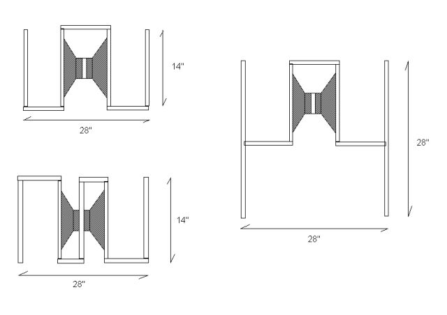

So, for the push-push dipole, are there any special geometry issues to worry about, or can I make an H-frame baffle and be done with it?

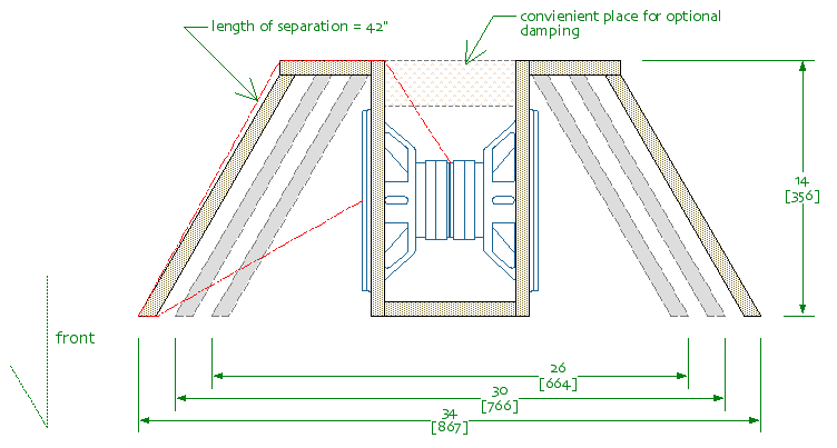

The south-east one wouldn't be push-push... if i were doing one i'd be thinking along the lines of the NE one -- I don't like the idea of the parallel sides on the front facing portiom. There would be lots of variations. Of course -- bigger the better. One could use plexi for the wings. Don't forget that the shortest path could also be over the top.

planet10 said:The south-east one wouldn't be push-push
dave
south east? Now I'm confused. Which one is south-east?
Dave
kneadle said:south east? Now I'm confused. Which one is south-east?
Bottom-left.
dave
As I understand Dave, it's not push-push because the driver's rear forces are transferred to the enclosure without being cancelled by the other driver.
Looks cool, though. I like the symmetry.
leadbelly said:As I understand Dave, it's not push-push because the driver's rear forces are transferred to the enclosure without being cancelled by the other driver.
Yep... it would be push-pull, tending to cancel non-linearities in the way the driver moves in vrs how it moves out.

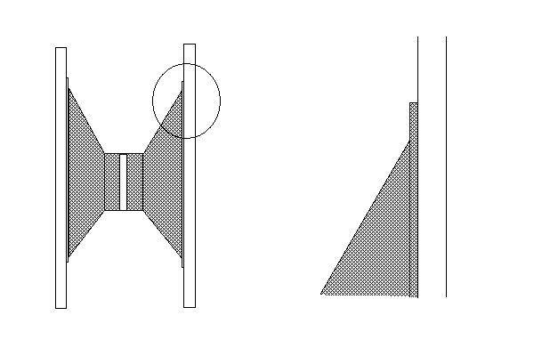

OK, well your answer has really made me rethink what I had planned to do.
I had planned to just epoxy 2 woofers magnet to magnet, making 1 unit, and then just screw the 2 flanges to the rear surface of two pieces of wood, as shown in the drawing, to begin making the baffle.
Is this technique still push-push?
If it is, would threaded rod bolted through the entire assembly from 1 wood surface to the other be necessary? Or else a threaded sleeve cut to length to fit tightly between the woofer flanges, bolted through from the baffle.
leadbelly said:OK, well your answer has really made me rethink what I had planned to do.
yes it is push-push. With the magnets touching, any force thru the magnet and pushing against the other speaker is cancelled to a high degree. When the force is pulling the driver away it is much less effective. By gluing the magnets together you have a greater effect when the drivers pull apart. The threaded rod -- with bolts inside and out, are effective for both push towards & pull-away plus they spread the load over a larger part of the driver -- it is all a matter of how nuts you want to go.

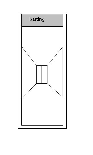

Dave's comment about adding stuffing made me think about the following design shown. Much nicer footprint for my needs.
My question is, what happens to the reponse as compared to a plain dipole? In other words, I can punch in this smaller baffle size into the same response calculator I was using to estimate the base case (no stuffing) response. More important is how the reponse curve shifts as the stuffing is increased.

I was just running some Vector Mech and still don't know why you need to "tie" the woofers back-to-back. All of the mechanical forces are applied symmetrically about a baffle and is transferred to the sides and top and bottom. The enclosure is essentially a dictionary definition for Newton's Third Law.
I did figure that the magnets would have to mounted perfectly within their regions...i.e, center of drivers coplanar.
