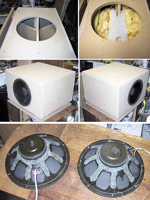

I heartily recommend push-push. Chris & i are working on V3. Pic is V1 using 2 x Philips 12". The box is about 2.8 ft^3, and in the cases of V1 & V2 are both aperiodic (the drivers would really like to see bigger boxes). The top 2 images show the brace used to ridgidly connect the 2 magnets together -- the blue foam is closed cel and quite thin and provides just enuff to tightly couple the magnet to the brace. It is important that the drivers are on oppossite sides & tied together mechanically.
Both V1 & V2 (customer supplied Foster 12s) turned out really well. Both use drivers that are more intended for midbass use than sub use. They go low cleanly and integrate very well with the sats (in both cases a quartet of BD-Pipes with RS 40-1197s). The push-push loading means very little mechanical energy transfer to the box.

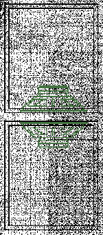

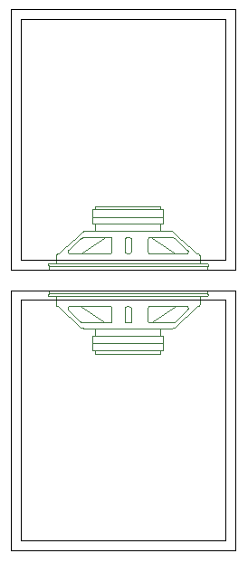

I have two alternative subs for my new Nonsuch range. The Little Awesome and the Bigger Awesome.
The Little Awesome is like an oval barrel with the driver (Bandor 150) firing out of the bottom.
The Bigger Awesome is a Push-Push, comprising one Little Awesome mounted upside-down so that the driver fires upward and the other one normal-way-up on top of it, separated by 2" - 3". The sound comes out of the middle, between the two drivers.
Clear as mud? Sorry I haven't got any drawings to show you. I just figured that the vibration cancellation would be even more effective if I could get the two drivers close together.
Anyway, if you can figure out what I mean, I put this forward as another alternative because the drivers are in the centre so you could still put coffee cups on top.
If you don't want to go for this vertical approach, I still wouldn't recommend the 90 degree thing as you would lose the vibration cancellation benefit.
As for whether you can fire into the wall (presumably there will be a gap between speaker and wall), I believe that this depends on the highest frequency the speaker has to produce. Down in the deep bass I don't think the speakers will care (some disagree) but if they go above, say, 150Hz - 200Hz you may have a problem.

7V said:Clear as mud? Sorry I haven't got any drawings to show you. I just figured that the vibration cancellation would be even more effective if I could get the two drivers close together.
Like the attached image? A very interesting design thou from a cosmetic point-of view.
Face-to-face is harder to get good coupling. The only way i can think of would be to use somesort of driver attachment that couples the 2 drivers together, but i can see complications with assembly.
Best is magnet direct to other magnet & the frame rims also tied together. If you can bolt the two drivers together even better.
If this had the magnets touching it would exemplify what i'm suggesting.
dave
planet10 said:Like the attached image? A very interesting design thou from a cosmetic point-of view.
Yup, that's the one Dave.
Yes, I think you're right. So far all I've come up with is connecting the baffles together. Not ideal. I haven't tested yet so I'll see in the next few days. The closeness of the two baffles should provide some cancellation. we'll see.

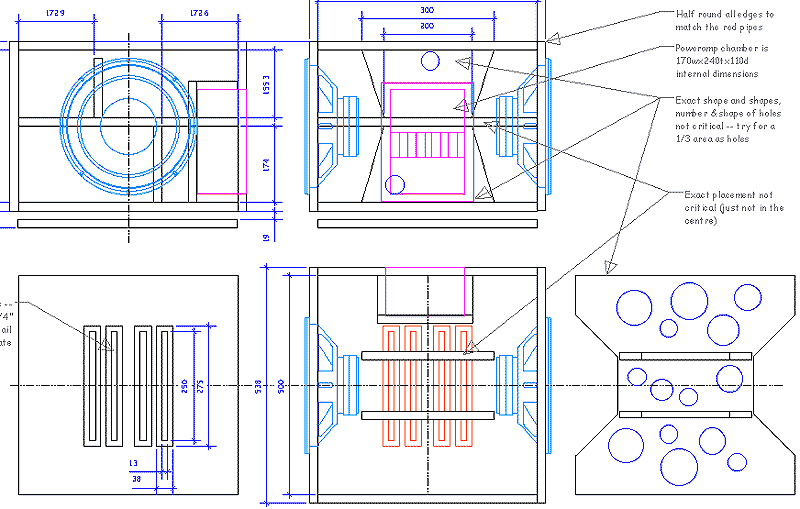

Schaef said:On to Steve's (7V's) design, it sounds interesting, but a couple of questions. Have you had a chance to listen to it yet? How does it sound? Also, what's the air gap between the two subs, and is it open on all sides, or did you design it to be similar to a port between the two? (Only one or two walls open)[/B]
No, I haven't had a chance to listen yet. I'm picking it up over the weekend from the company that's finishing the enclosure.
The gap is 6cm (2.5"). It's open on all sides (well 'cabineted' at the back of course), connected by four steel rods. If it isn't open you may have to increase the gap size.

Shaef,
If by "all-thread" you mean threaded rod, then yes, you could use this, but you would have to cut it to a suitable length to avoid the chance of the cone snagging on it. And vibration would be an issue, but epoxy should cure that, maybe silicone as it's less permanent.
I would do it with a long threaded sleeve if I found one at the HW store.
And for irony, I was looking around for pictures of woofers with frames suitable for this mod, and I found 2 with a perfectly shaped frame sitting on my shelf...2 old 10" cheapies that planet10 told me to consider a push-push for back in Dec.! 🙂

leadbelly said:If by "all-thread" you mean threaded rod, then yes, you could use this, but you would have to cut it to a suitable length to avoid the chance of the cone snagging on it. And vibration would be an issue, but epoxy should cure that, maybe silicone as it's less permanent.
all-thread (aka ready rod) is exactly what i had in mind -- sheathed on the inside with a couple layers of heat-shrink to kill off potential resonances -- it should be tight enuff that resonances will be fairly high in frequency, but the potential does exist for this to act like a guitar string.
dave
