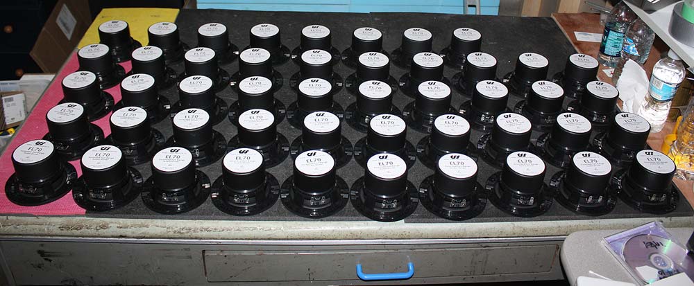

Yes I was planning on filling the bottom half with sand. Also how much is a tricked out set of EL70en drivers?
$160/matched pair + post (includes the full Mar-Kel plan-set)
A bit of a wait at the moment, hard to keep finished pairs in stock.
dave
