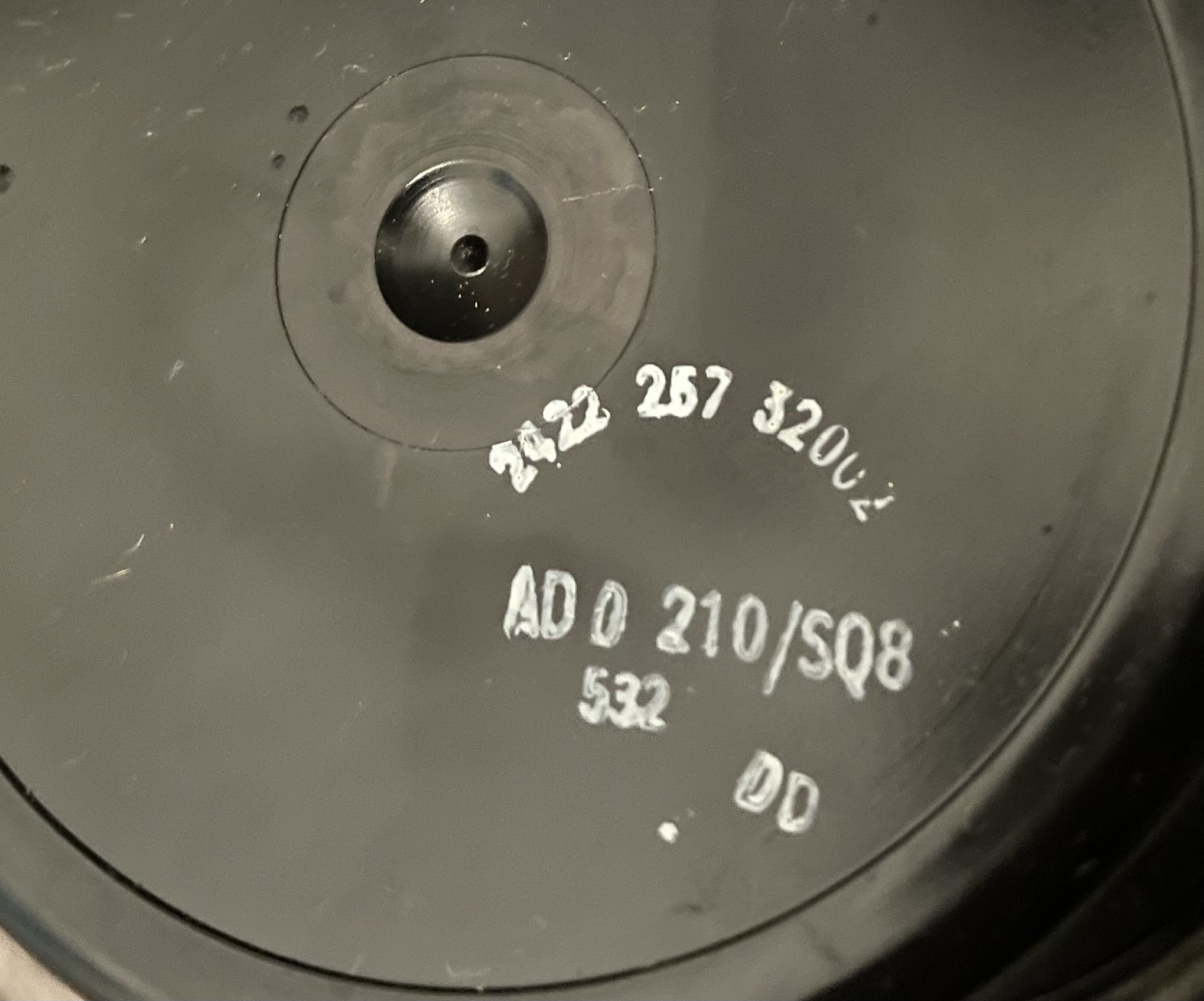

That Sq dome is well protected by the integral grill. It must have taken a determined effort to dent it. Almost certainly that of a tiny finger!
re:'AD0210/SQ8" - I've got a spare one in good nick you can have for free; Sydney is a long drive from Adelaide though..... I think Express post is ~$20?
yep, same 😅I'd be worried that things might go wrong during disassembly.
almost certainly.That Sq dome is well protected by the integral grill. It must have taken a determined effort to dent it. Almost certainly that of a tiny finger!
you mean like with mouth suction?Maybe you can do something with a straw?
holy crap - this is very generous - thank you.re:'AD0210/SQ8" - I've got a spare one in good nick you can have for free; Sydney is a long drive from Adelaide though..... I think Express post is ~$20?
I guess owlexifry will just have to suck it and see!
update:
the generously offered replacement AD0210/SQ8 was well received from @PeteMcK on Friday afternoon.
in perfect condition.
much better.
