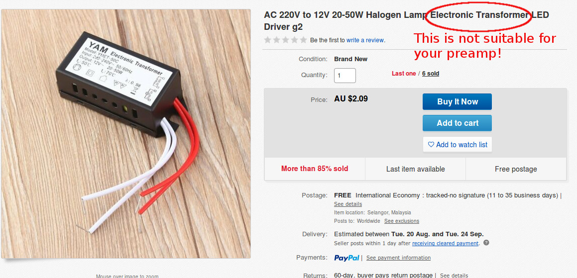

There are several possibilities. Here are some I can think of:
1) The type of switching power supply you're using usually has a DC output completely isolated from the AC input - this means neither side of the DC output is actually grounded. Both negative and positive are floating.
This will make your amp hum, and also make it potentially unsafe - you've got to get the ground wiring of your amp securely tied to mains ground, the fat third pin. Otherwise any leakage current from your 12V transformer is going to play havoc with the amplifier, and potentially, with the guitarist.

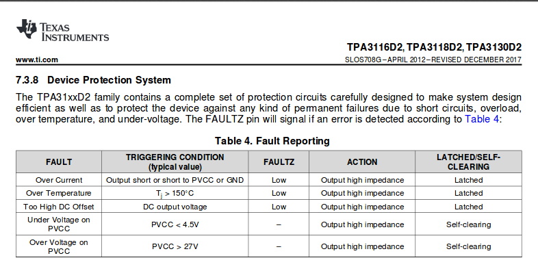

Good morning! Yes I have my suspicions that the power amp might have a built in pre, but if so there are no pots or anything to set gain, so I would rather use the volume pot on the pre out to cut the input I reckon. That sounds like the way to go. I have also been looking at h pad and t pad attenuators this morning, found a calculator after doing the math and finding out that with a 3k input and 1m out for a t pad, the 2nd resistor has to be negative at 18db cut, I assumed this means that it has to attenuate more for that much disparity between in and out, so I kept playing in the calculator and the first place the values are all positive is at -32dB! If the pre only boosts 15dB per channel, which is the number I am finding online per channel, then I am losing 2db even with the 30db boost if I match impedances! I figure the best way to fix this is to change out that 1M resistor on channel 2 to something like 30k or so, making the cut 16dB with 70 ohm, 28k and 3.1k resistors in the t pad (don't need balanced signals so H pad seems like overkill)
Just wondering if I'm barking up the right tree on this one, or will it be bad to change the 1M on the right channel to 30k or so? it was around 500k stock, and I don't want to kill something!
Also, it seems to be clean gain, but it's so much that the power amp was overvolting and cutting out until I turned it off, this was only really a problem with the pots weren't earthed though, as the noise from the 12vac was getting amplified I think, making way too much voltage for the power amp expecting something like 2v peak! I couldn't turn up too loud when I was testing after putting the pots in, but I noticed the volume still went from 0 to 11 in about an 8th of a turn, I couldn't go higher because people were sleeping in the house at the time!

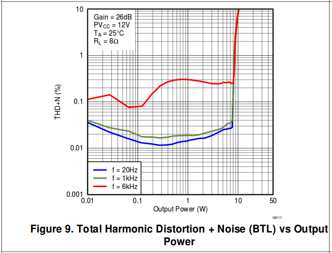

If the pre only boosts 15dB per channel, which is the number I am finding online...
That's a voltage gain of only about five times. A normal triode gain stage in a guitar amp has a gain of about fifty times. Even two of your 6J1 gain stages in cascade only have a gain of about 32, still less than a single half-12AX7 in a Fender amp!

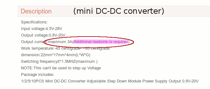

That means you have too much power supply voltage to your power amp. It is overheating because it can't put out as much power as you're asking it to.

The attached datasheet shows the amp will put out plenty of power (7 or 8 watts RMS) with a 12V power supply and 8 ohm speaker. That should be loud enough to annoy all the adults near your niece. 😀
Better yet, it is well within the ratings that Texas Instruments specifies for the chip even when used without a heatsink, on a single-layer PCB. That means it probably won't overheat, unless you're experiencing a 45 degree C day. 😱

As far as I can tell (see attached datasheet snip), the TPA3118 has no such protection against input signal being too big. It does have protection against too much power supply voltage, too little power supply voltage, too much output current, too high a chip temperature, and too much DC offset between the two speaker outputs. But no protection against being fed too much input signal.
So why did the TPA3118 shut down, then? My first guess is that it is because it was asked to put out more power than it could handle - there was so much hum and buzz and noise on the input that it was being driven to put out lots of power, enough watts to overheat it, which caused thermal shutdown.
I cannot be 100% sure that my explanation is the correct one. But there is a simple way to find out: lower the power supply voltage to the power amp. If it stops shutting down, you've confirmed that excessive supply voltage is the cause (more on that in a minute.) If it still continues to shut down, we're back to looking for a different cause.
And speaking of a different cause, look at the second attached image, taken from the 'Web ad for your DC-DC converter. It too needs a heatsink to supply its rated maximum 3A output current. (Personally, I wouldn't trust that 3A maximum rating anyway, not without a real datasheet to prove it.)
Your amp, operating on 18.5 volts, will draw 2 amps peak if the speaker is very gentlemanly and behaves like a perfect 8 ohm resistor. Real speakers are unruly, and often draw much more current than an equivalent pure resistance. It's quite likely that your amp is trying to draw peaks of 3 A or more. Therefore the shutdowns you're experiencing might also be caused by the DC-DC converter being overloaded, and not the TPA 3118.
The experiment to find out is similar to the previous one: try running the power amp without the DC-DC converter, which probably means you also have to use a lower-voltage power supply. If the shutdowns stop, well, you've cured your problem, so you don't need either the DC-DC converter, or the higher-voltage power supply.

Or it might be that you're right, and it's the DC-DC converter that's cutting out. The easiest way to find out is to eliminate the DC-DC converter.

I just looked up your 12 V power supply link, and found another major problem. What you have is not a transformer at all - it's a high-frequency switching power supply, and is not at all suitable for powering your preamp. (It's fine for powering a 12V halogen bulb, which doesn't care about hum and noise on its power.)
The old-fashioned iron-core, 60 Hz AC transformer is what your preamp was designed to work on. But those are thin on the ground these days. High-frequency switching supplies like the one you bought are smaller, lighter, cheaper, use less precious iron and copper, so they've taken over the market for halogen transformers. But they're noisy as all @#!*?, switch too fast for the rectifier diodes on your preamp board to handle, and may be unsafe, as the secondary is floating and not grounded. In short, DO NOT use this to power your valve preamp. 😱
Find a proper 60 Hz (or 50 Hz, in your country), 240V: 12V AC step down transformer. I think that will solve many of the buzz / hum / noise problems you've been experiencing.

That was also my worry, I have been testing with a spare 12v wall block, and it's heavy as hell so I think it's basically just a transformer in a box, I will not use those psu's! I'll save them for when the halogen lights in the kitchen take a crap I guess! XD
