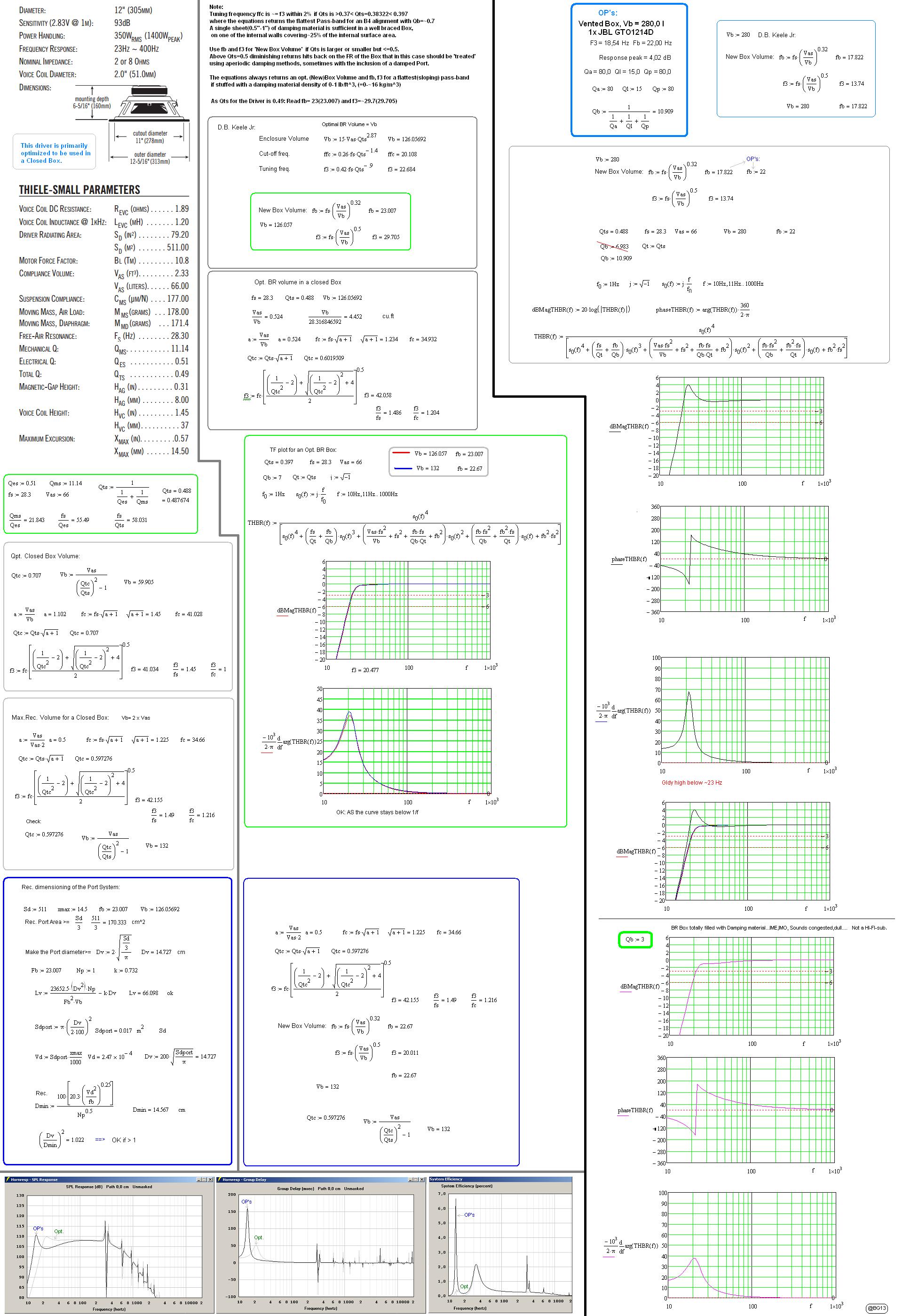

Hey guys! I've been playing around and testing new configurations to make the box.
Also used different output power: 240w, because that's the max of the amp (at 8ohms).
Changed the diameter of the vents to a more exact measure according to pvc plastic tubes.
Here are te results.
Dou you think that this is more adecuate and smoother response?
Thanks for all the help and comments!
280L is way too big.
Drop it to ~120L. That should flatten the 20Hz peak.
You could also use one amplifier channel for each voice coil, and connect the inputs together. This would give you a few dBs extra headroom.
Chris
Did it. Here are the results.
Also changed the tunning to 21hz, so it could be around 20hz at -3db.
It was very hard (or impossible) to get a flat response at 120hz. So I did my best to keep the that "ripple" over the 120hz.
BUT! theres a little problem...
As you see, port speed is over 26, but it's when input power is 250w...
I would never ever use it over 150w, so I thing it's ok.
What do you think?

Your graphs look good, but I agree that the airspeed has gone too high. Could you use two smaller ports to get the tuning and airspeed correct?
You realise that the frequency scale is logarithmic, right?
It goes 10-100-1000Hz, so the line you're looking at is two up from 100Hz, making it 300Hz.

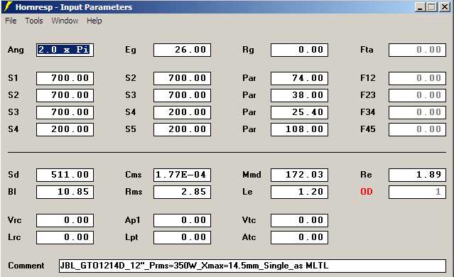

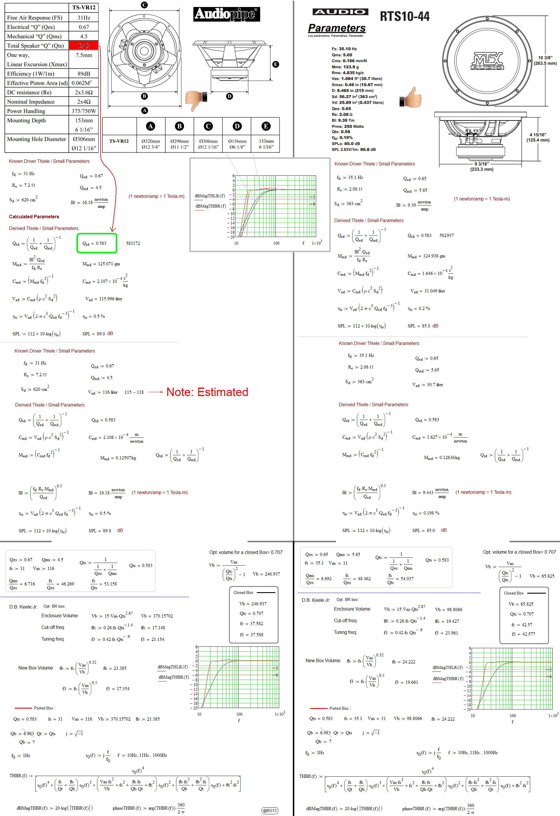

Submitting a few sims concerning post#1 that I held back after reading the subsequent ones... but here they are:
b🙂
Hi ofesad,
Looks like you are putting a lot of work into this project, have you measured the actual T/S parameters for the JBL GTO1214D, and what are the parameters you are using?

Solved. I didnt realize of the scale...
