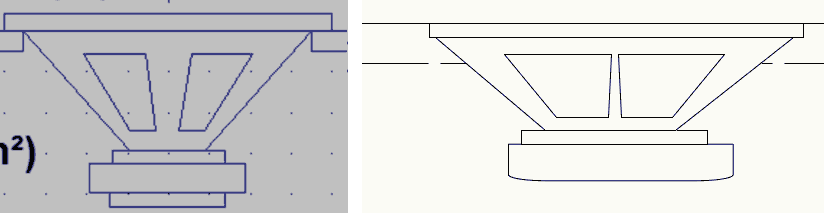

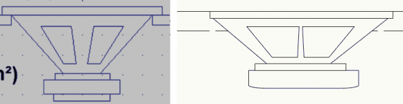

I looked closer, they are close but different.

... which is why the accusation of theft was fundamentally problematic. The justifications would have had to have been in the fine details.
Of course if a particular drawing of a driver didn't actually look like a driver then it mightn't look like any other drawing of a driver. But then at some point your illustrations might start to depend heavily on annotation. A thousand words might not need the picture at all. ;-)
