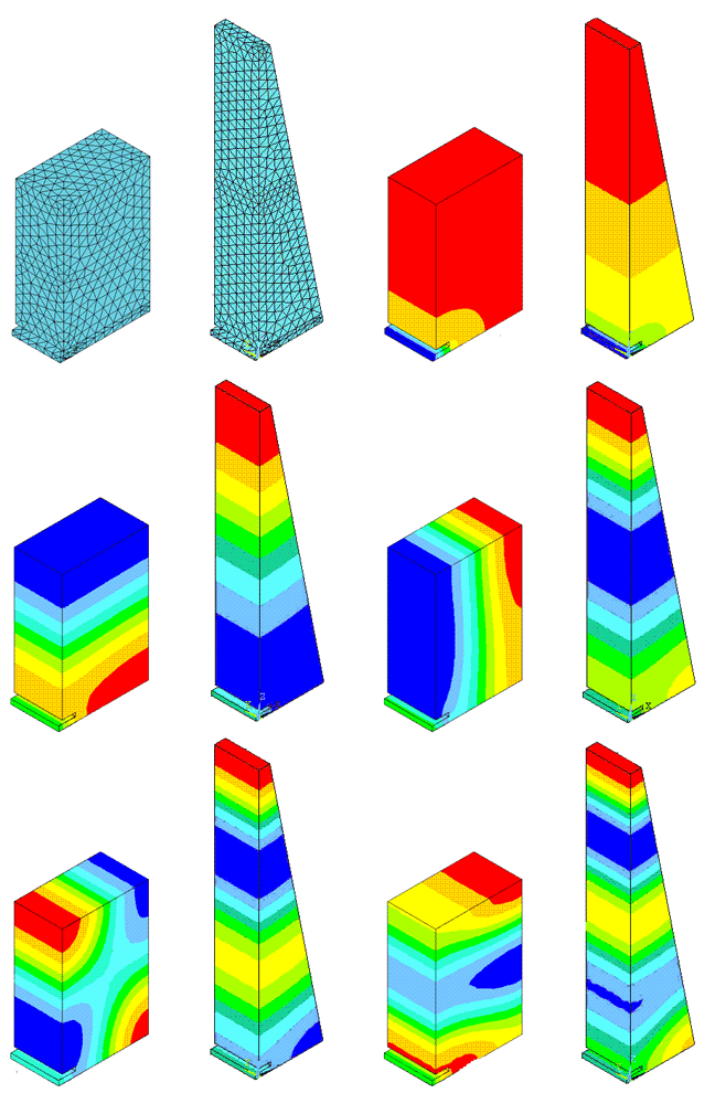

A BR will transition to a TL as one increases one dimension such that it becomes considerably larger than the other 2.
A BR is short enuff that any 1/4 wave resonances are moot, as one increases one dimension the quarter wave resonance becomes significant and changes the behavious of the box.

By reducing the terminus of a pipe one adds an extra low-pass element which allows one to shorten the line for the same Fb, and simplify box construction. With the extra LP one can use less damping so that more of the desired fundemental is left to reinforce the low bass.
diyFEST SUnday over here on the island and i have 4 TLs currently in my living room (3 FRs and 1 a WAW with 2 TLs, an ML-TL for bass, and a 10:1 tapered aperiodic line for the midTweeter). You see so many FR TLs because a couple of us (at least) are FR fanatics and TL lovers. Bailey’s seminal TL was a 2-way, the Radfords that followed were 3-way, and many of the IMFs and TDLs were 4-way.
dave

699672d1535299152-questions-transmission-line-speakers-ansys-ml-br-compare-gif
Thanks, your reply provides a log of insight! What software did you use go generate these simulations?

FWIW the graphic Dave provided was done by Martin [King] as part of an early project; it was done in an FEM package.
