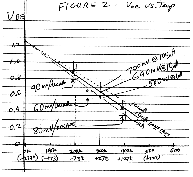

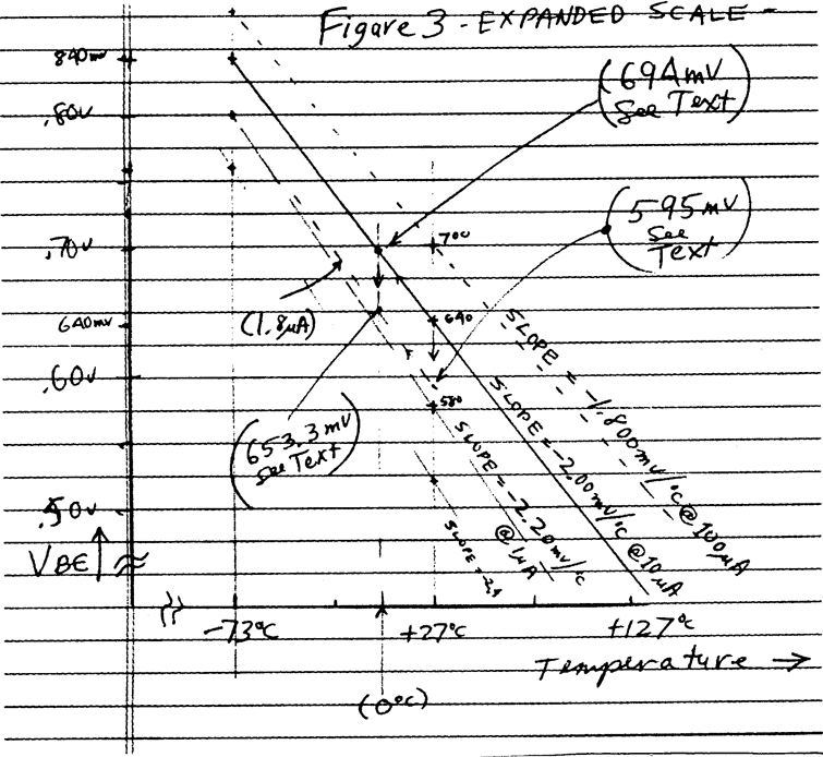

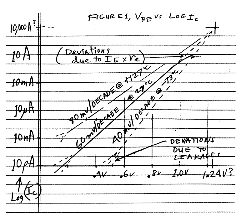

  • Bob Pease Whats All This VBE Stuff Anyhow Part1+2.pdf
