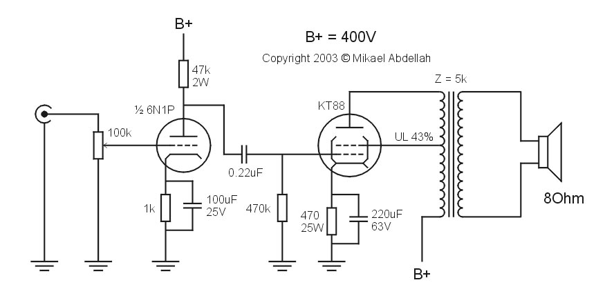

1- B+ is 430V
2- 5K tap
3- 80mA
4- output- initial measurement indicates somewhere between 6
and 8 but I'm going to give them several more hours of burn
in time before really measuring. Plus I'm waiting for a new
8 ohm dummy load as my previous one has gone missing.
5- sound is excellent. Base is deep and full, highs are crisp and clean and the midrange is smooth and detailed. (Plus it does look really nice! 😀
6- You didn't ask but I'm using the UL tap which at 5K is
about 35%
Schematic-
