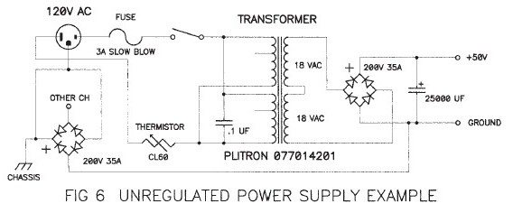

Thermistor in primary side.
Even if you have nothing connected to the secondary you will often get a current surge when you turn the tranny on. If you happen to turn it on right at the zero crossing of the mains waveform this is the worst time for the transformer and it will usually saturate momentarily, making the house lights blink as it makes a "bong" sound. Paradoxially, the zero crossing is the best time to turn on for the sake of the capacitor charging current so you are stuck between a rock and a hard place. I say stick a thermistor in the primary side, say 12 ohms for 120v, 24 ohms for 240v etc. That will limit the surge to 10 amps rms. Also, put a bit of heatshrink tubing around the thermistor so it will run hotter and therefore stay at a lower resistance when running.
The transformer secondary current rating is a long term thermal one. You can exceed it by a LONG way for a moment or two at switch-on. Same with the diodes. In the databook they will have an Itsm rating - this is usually the surge current rating for one half cycle of mains power. It can be often 10 or 20 times the normal continuous rating.

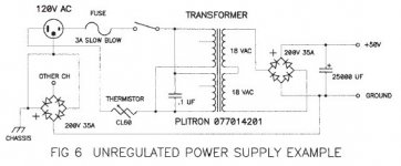

I had a look at the power supply example in Nelson Pass's docs about The Preultimate Zen (image below). The thermistor used there has a cold resistence of 10ohms and can tolerate 5A. I was quite confused about how the 3A fuse and 5A thermistor could handle 12 amps of current. On the secondary side of the transformer this would be 40A, which to me just seemed to be too much for the poor tranny.
Now I take it that all this will work as long as the high current lasts for a very short time. The duration of the inrush current must obviously depend on the size of the caps. Will I be ok with 12A inrush, using a total of 80mF for smoothing?
