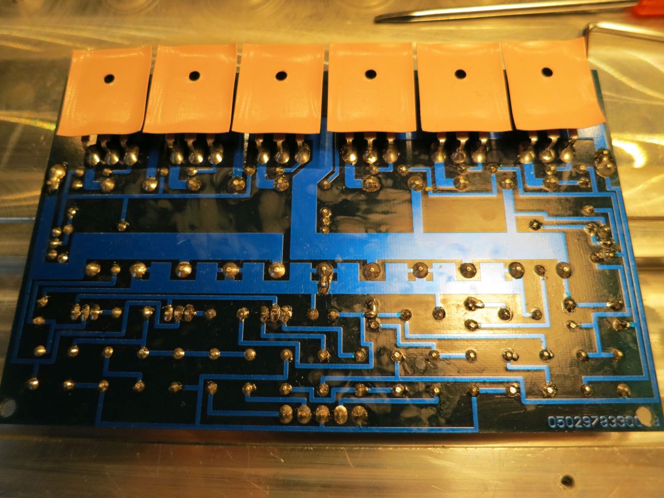

As requested pictures !
(i'll post schematic with measuments asap)
Other strange thing : resistance Source (Q6/Q8) to chassis = 7MegOhm
The good channel gives 9MegOhm.

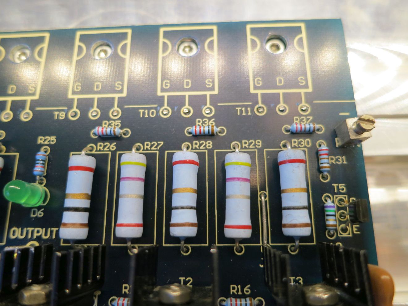

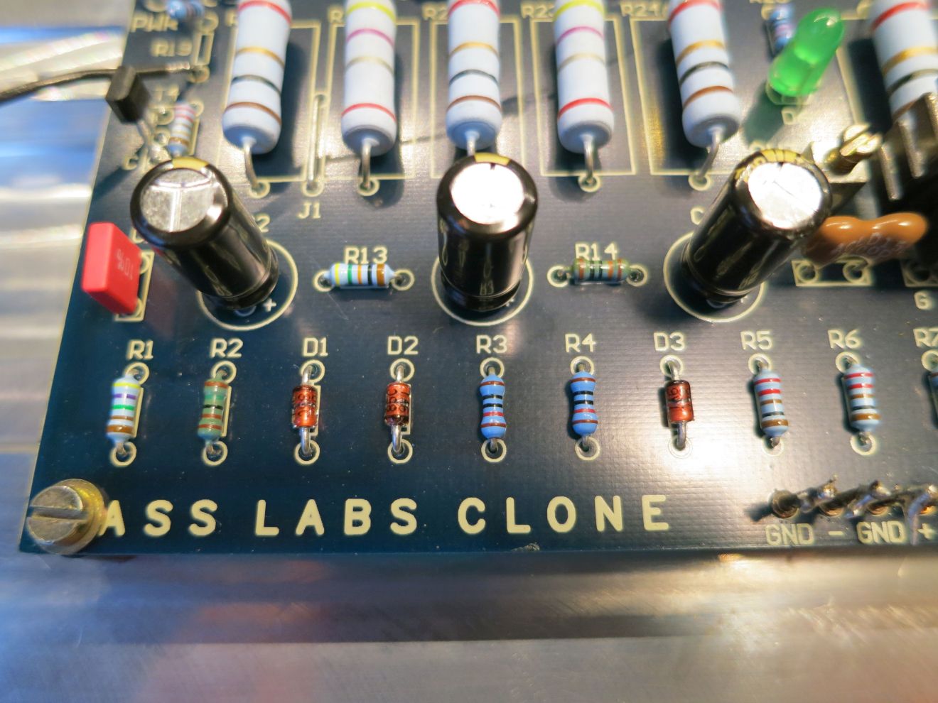

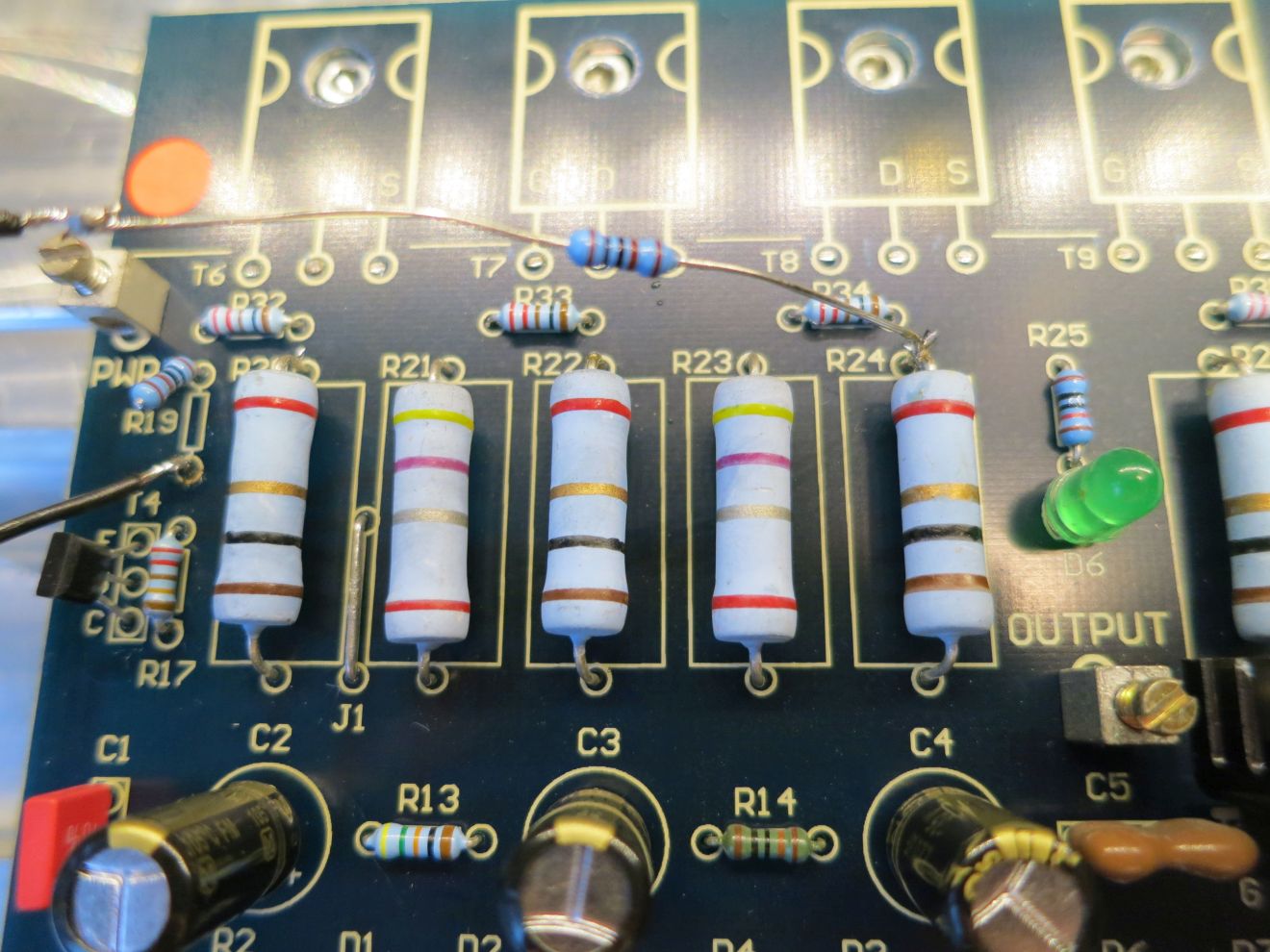

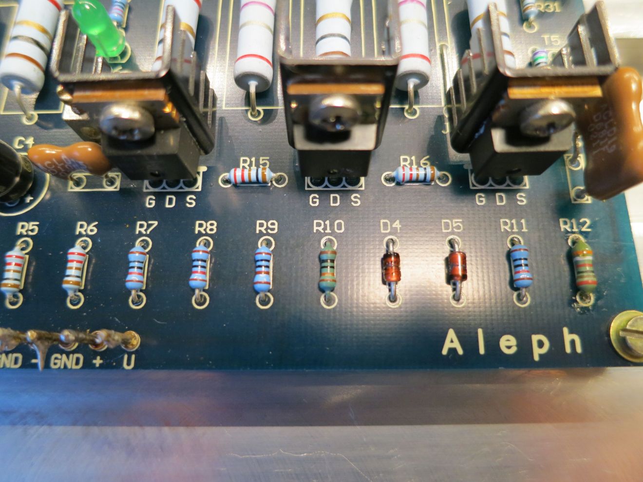

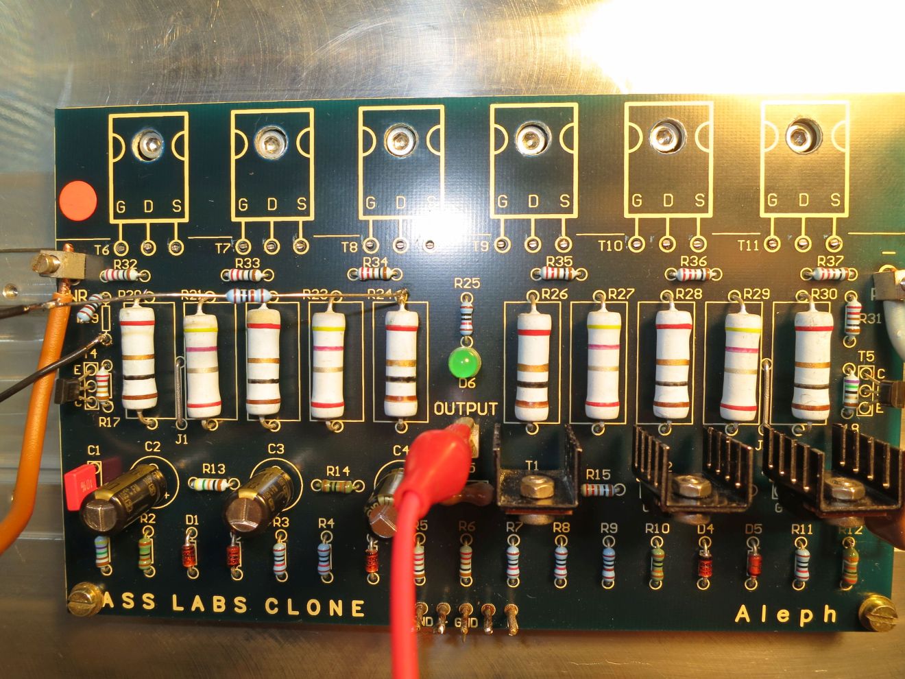

!! Breakthrough !!
I guess problem found !
Last attempt before removing Q6 to Q8 i decided to place a pot at position R11.
Now at 390 ohms, but 15mV offset.
I'll leave it in for a while to heat up. but things are looking good so far !!!
(cold air over Q1,Q2,Q3 drops offset to 3mV)
(i should have listened to this advice much earlier...
I guess, case closed.
Waited a while and measured offset again. Changed R11 to 402(390+12) ohms and all is good now.

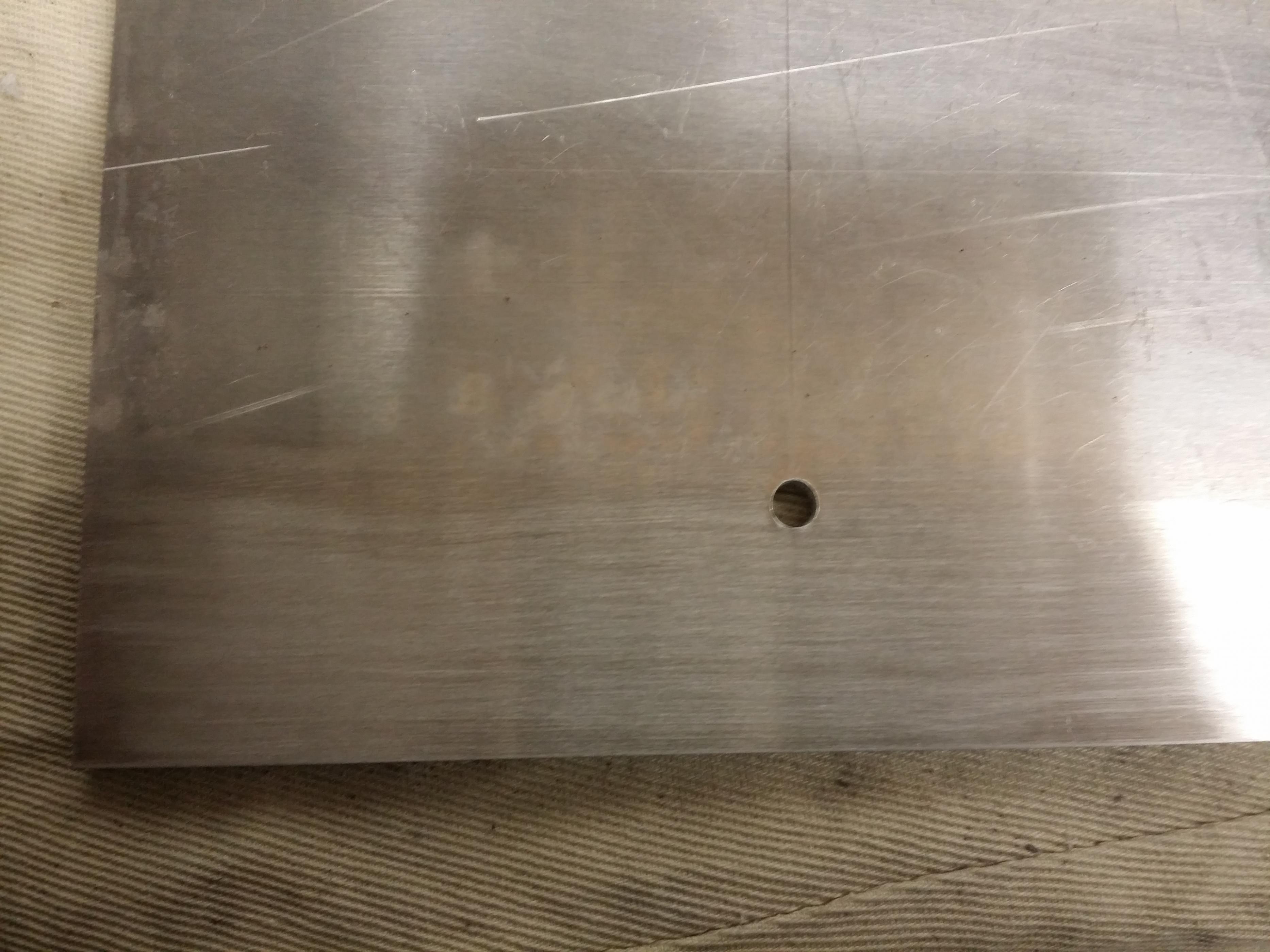

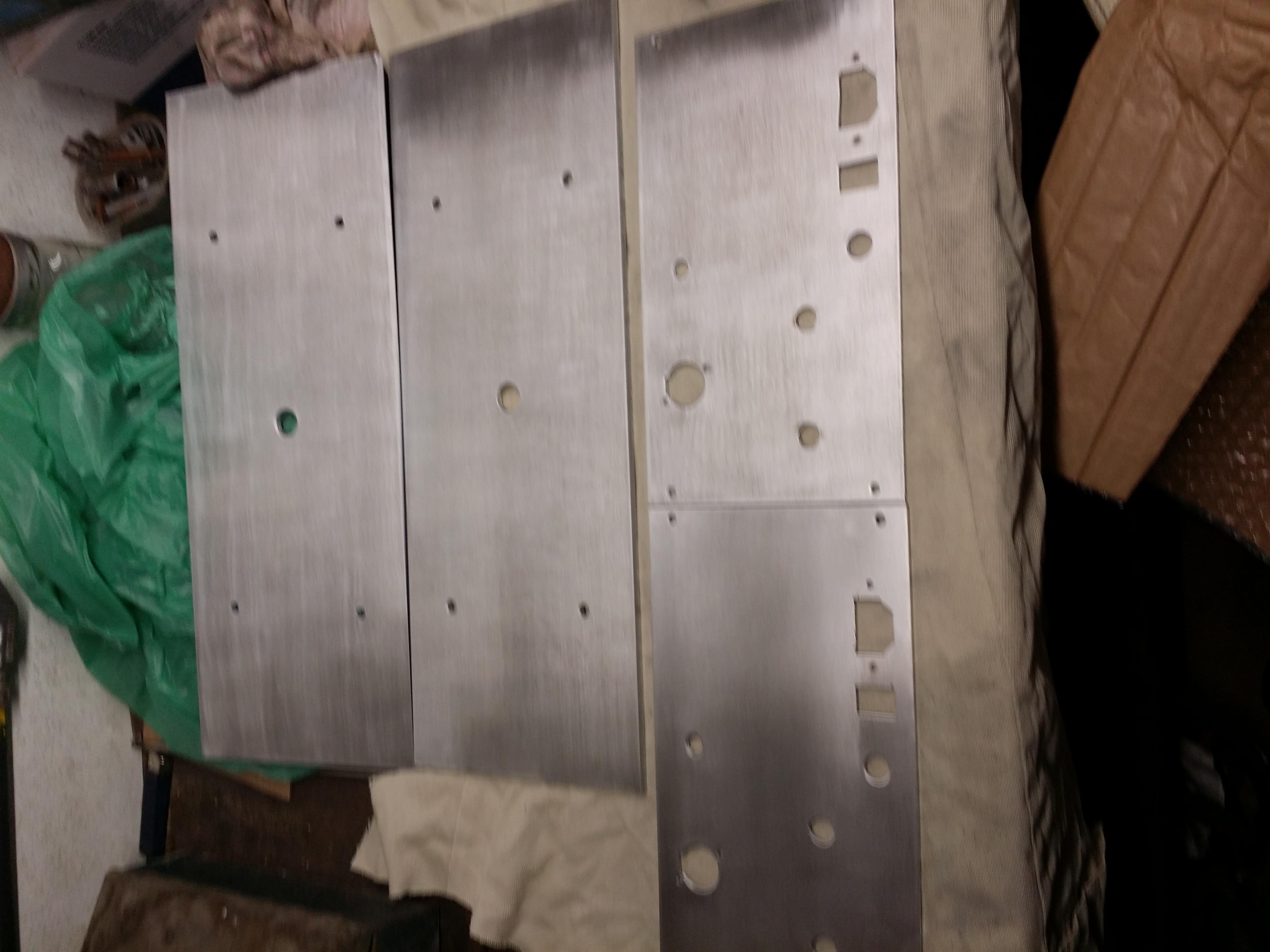

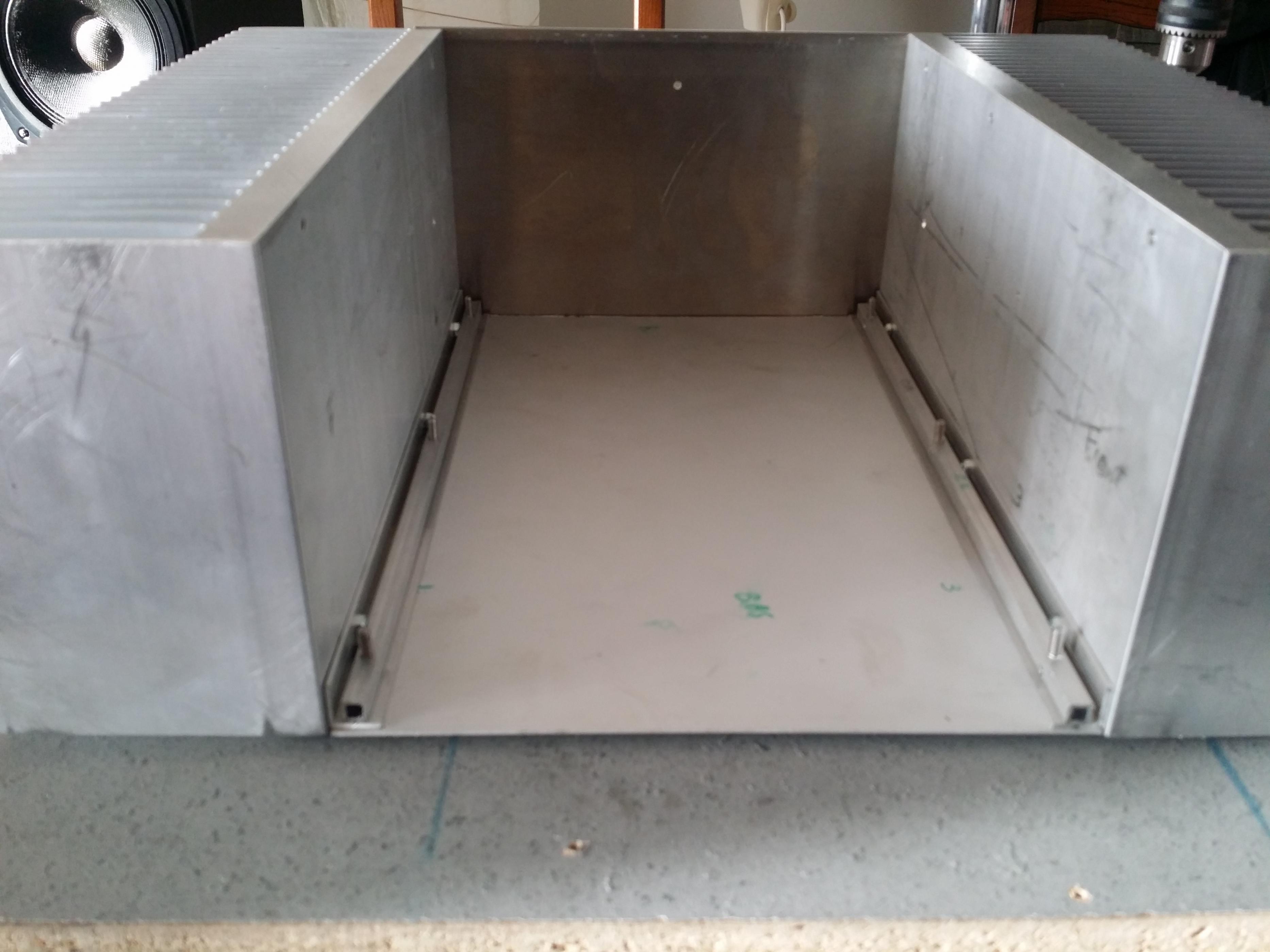

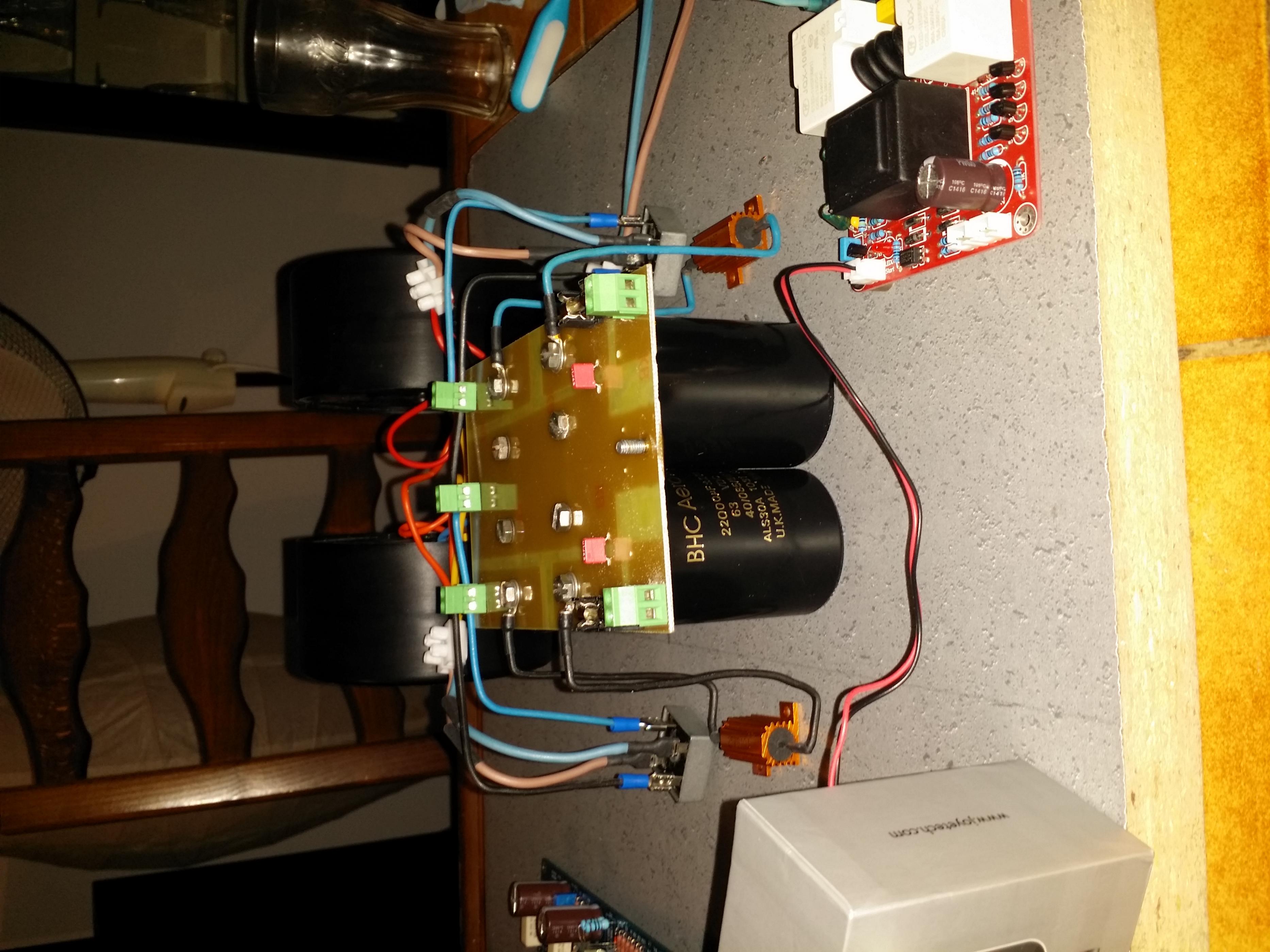

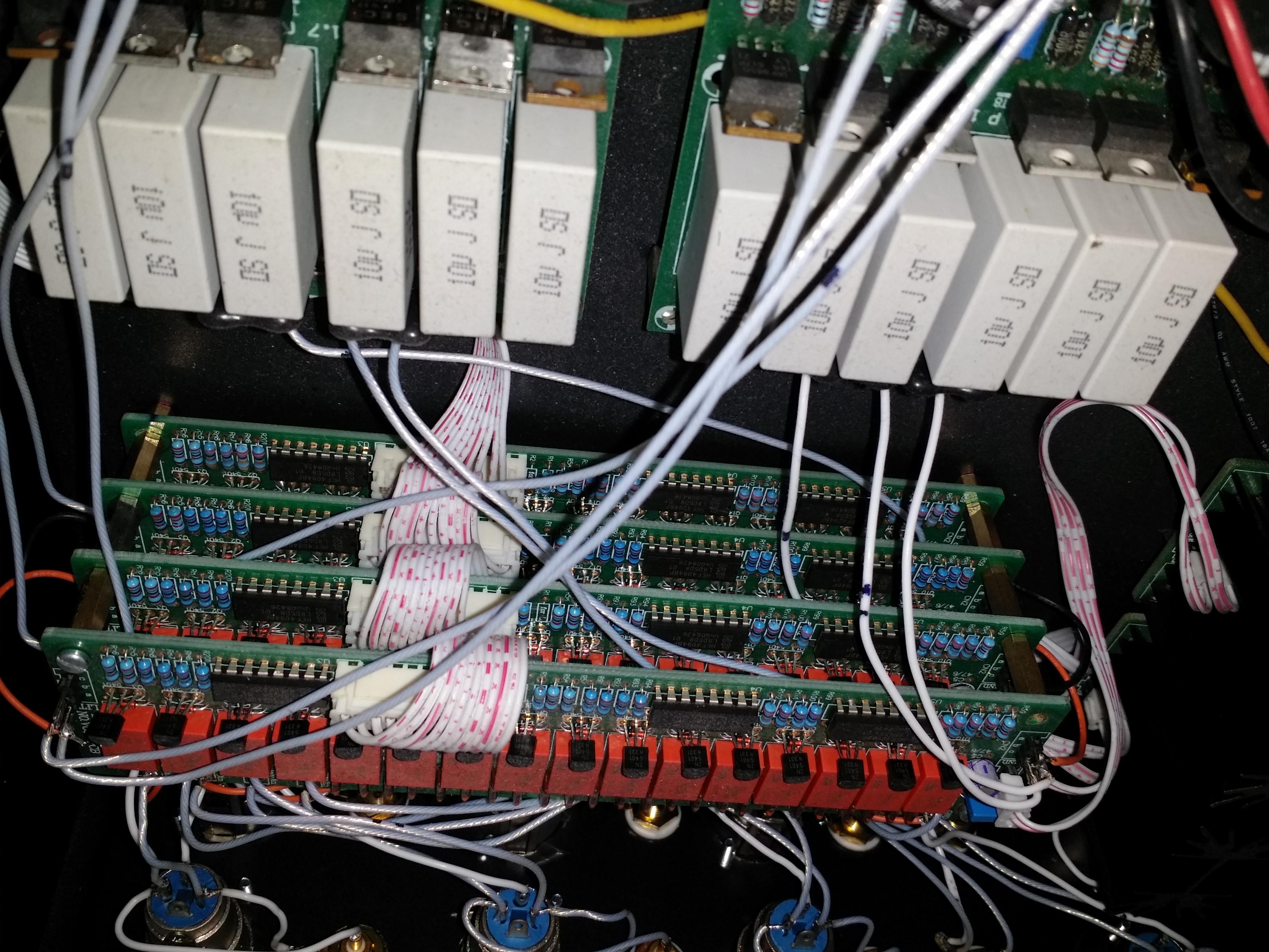

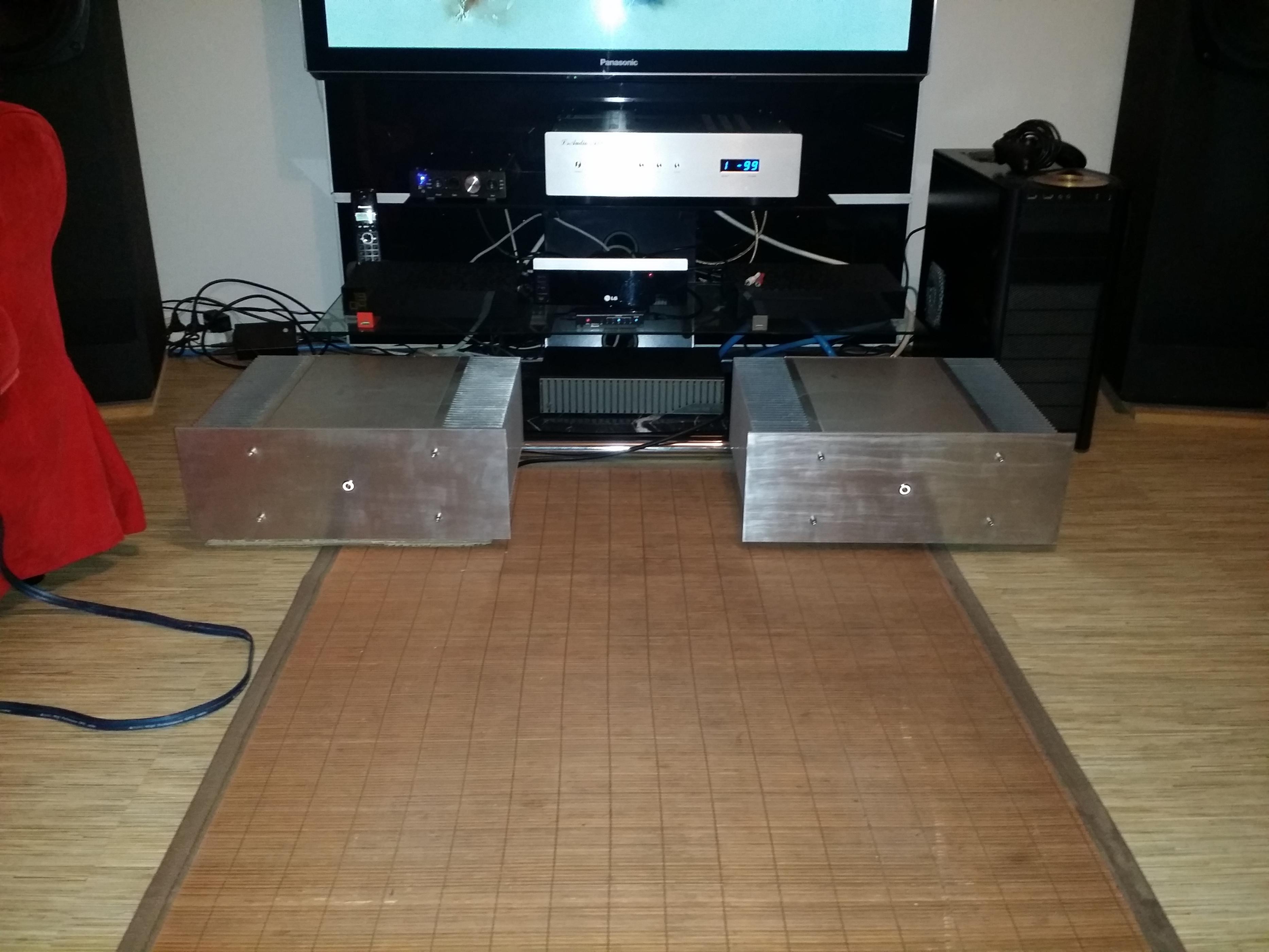

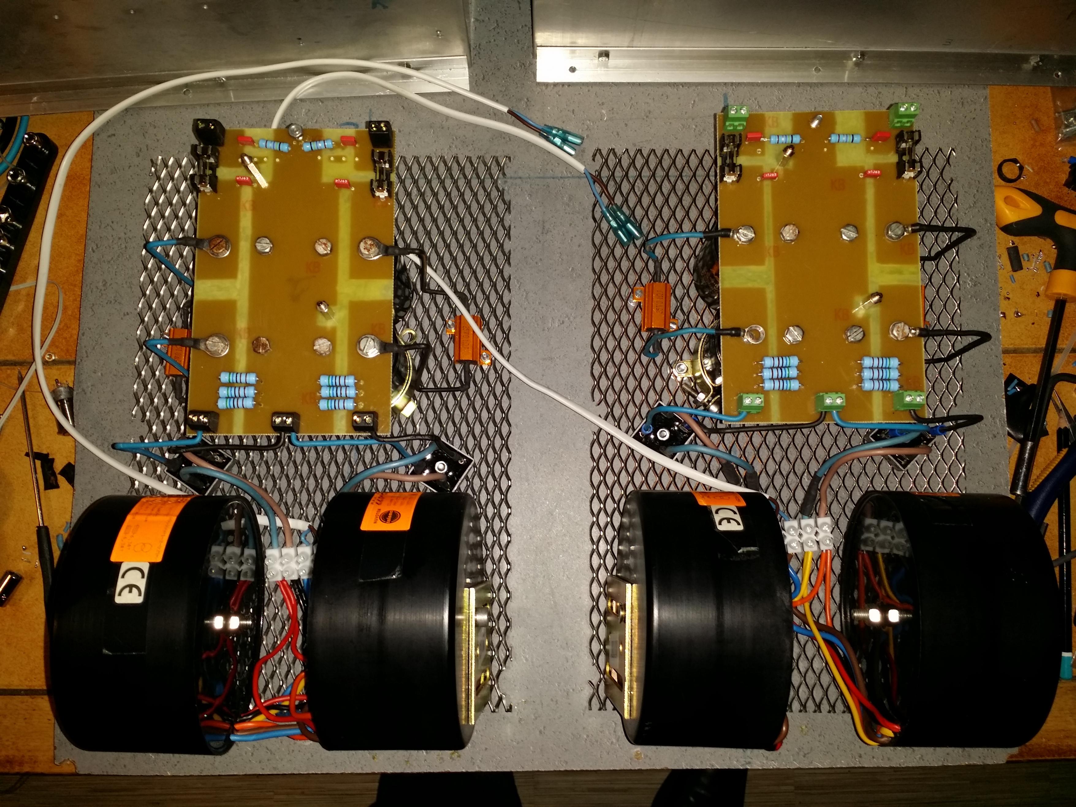

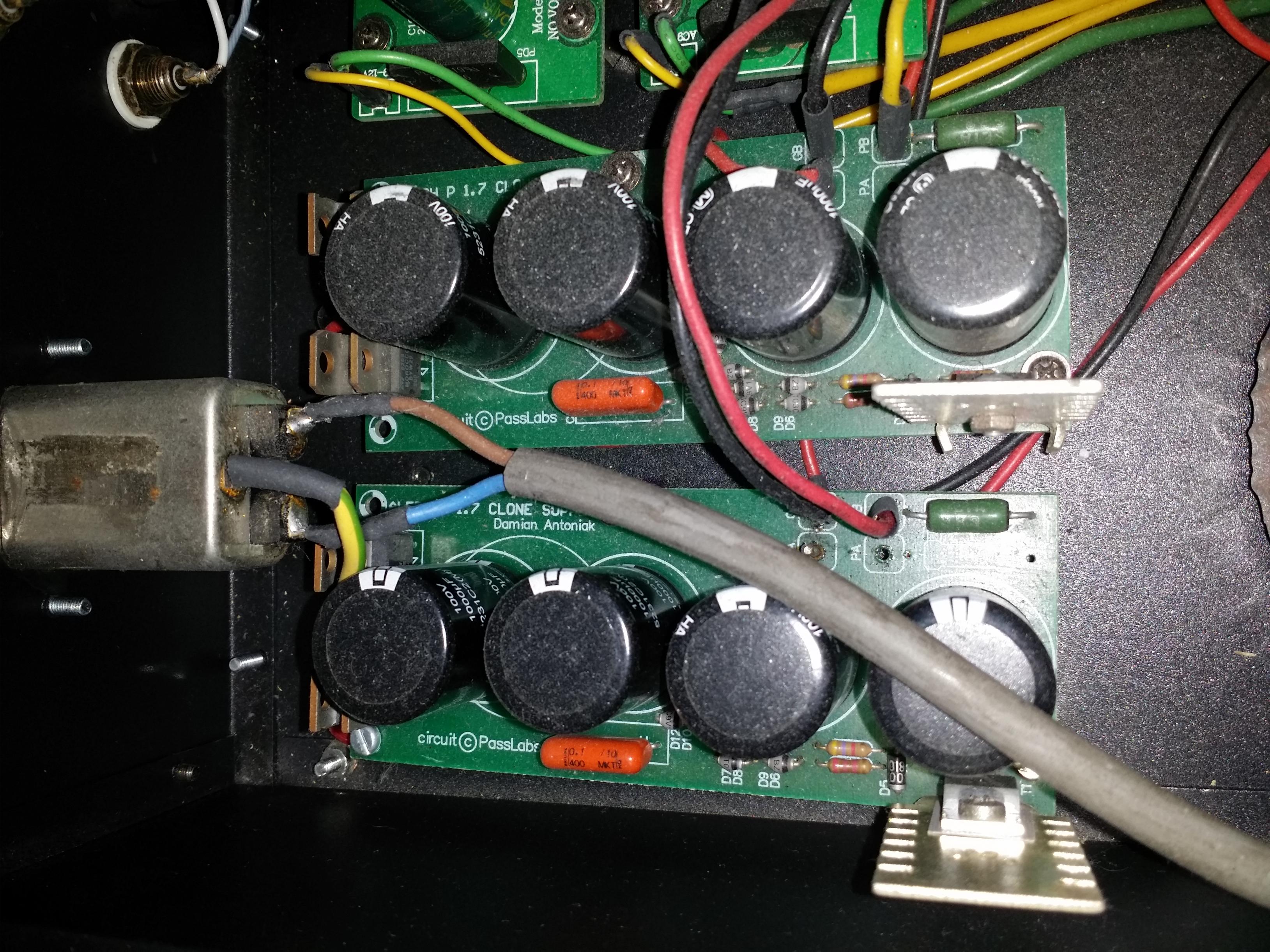

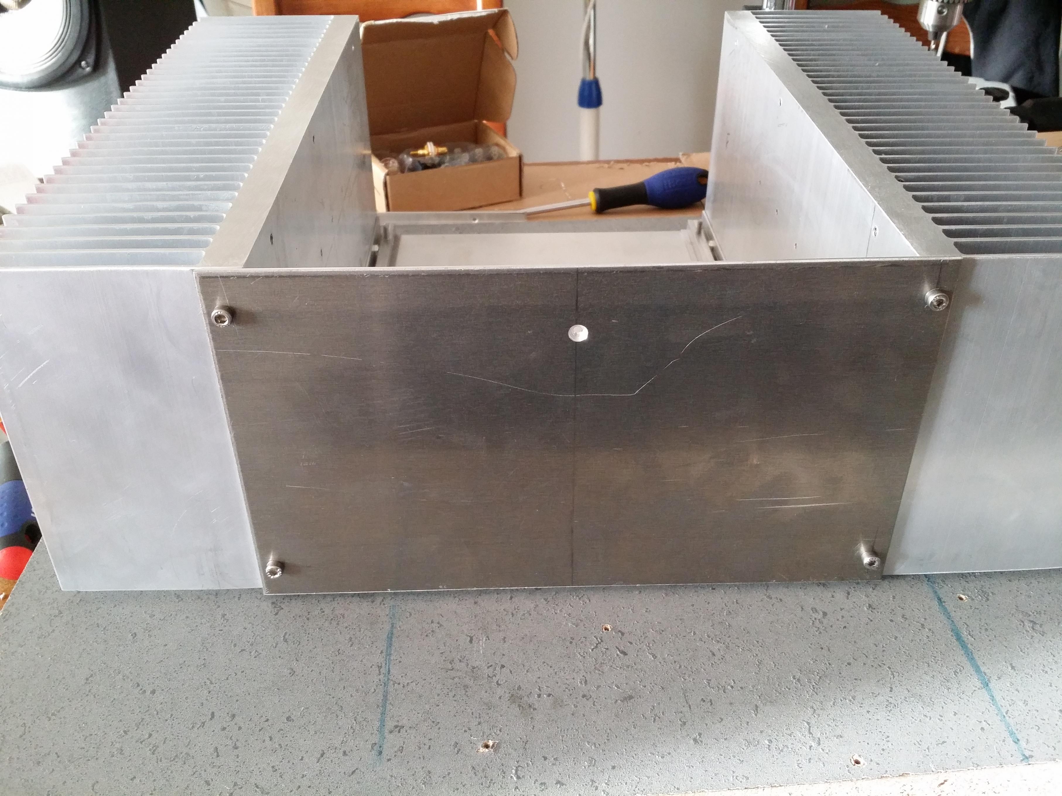

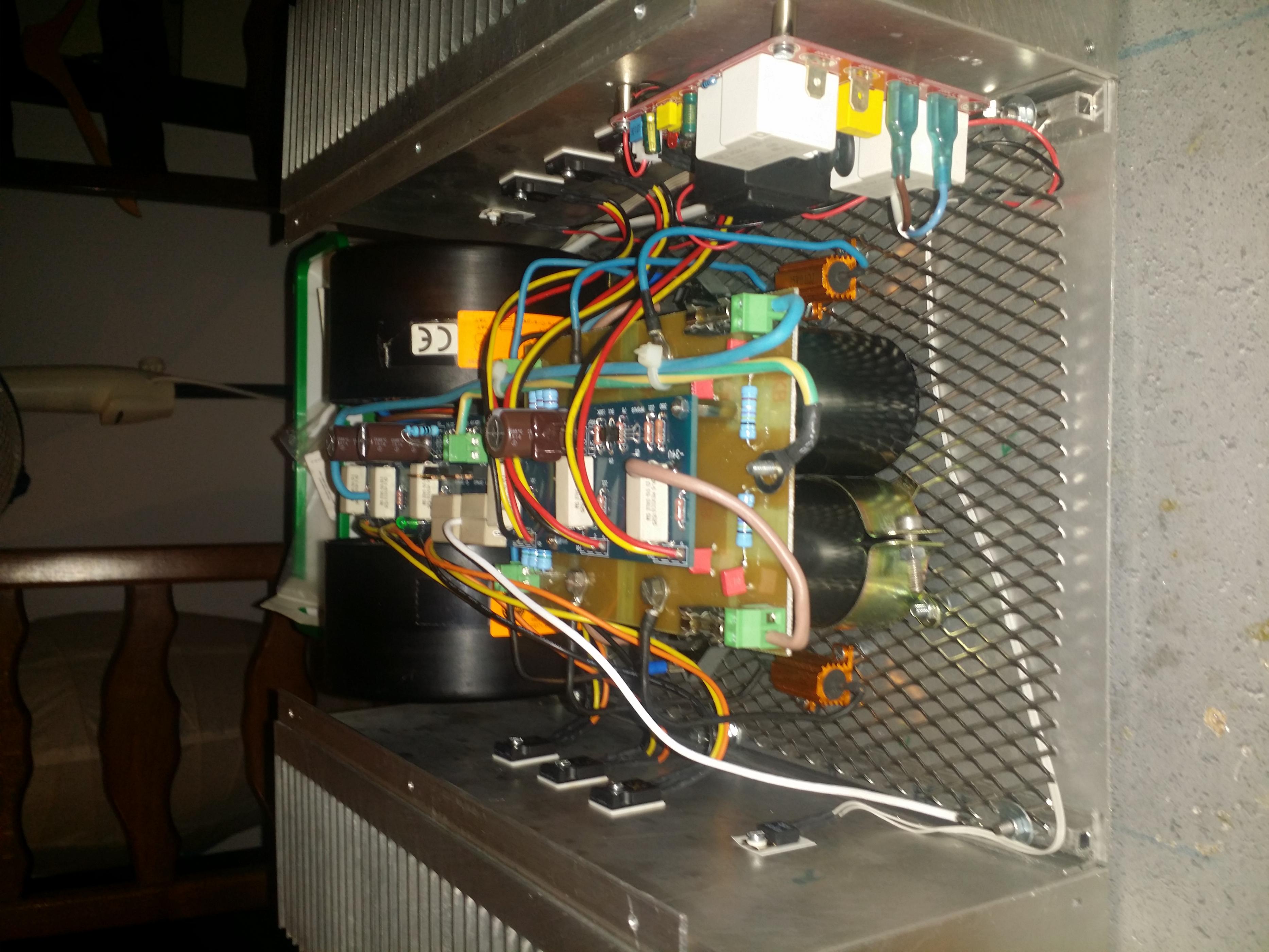

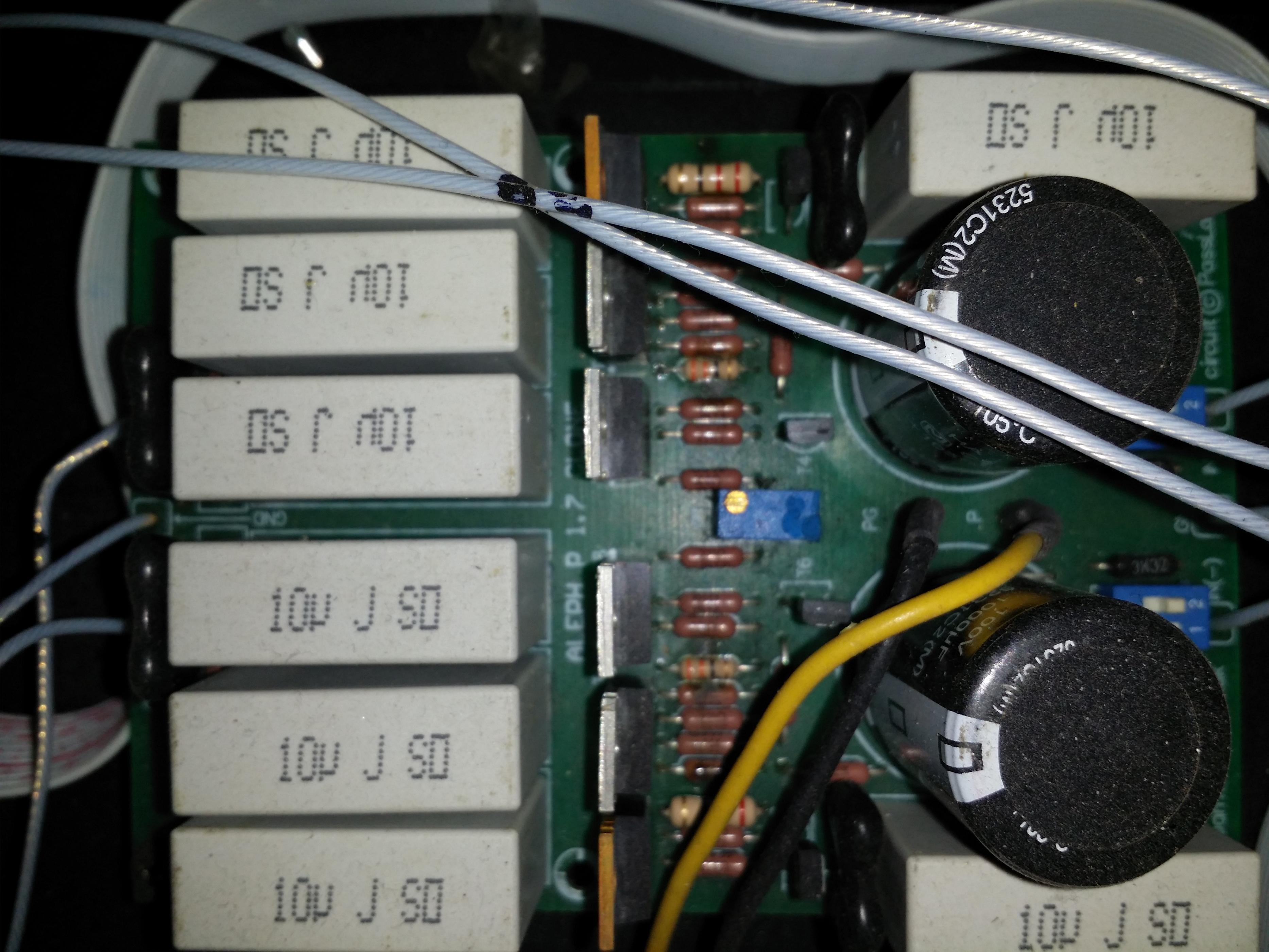

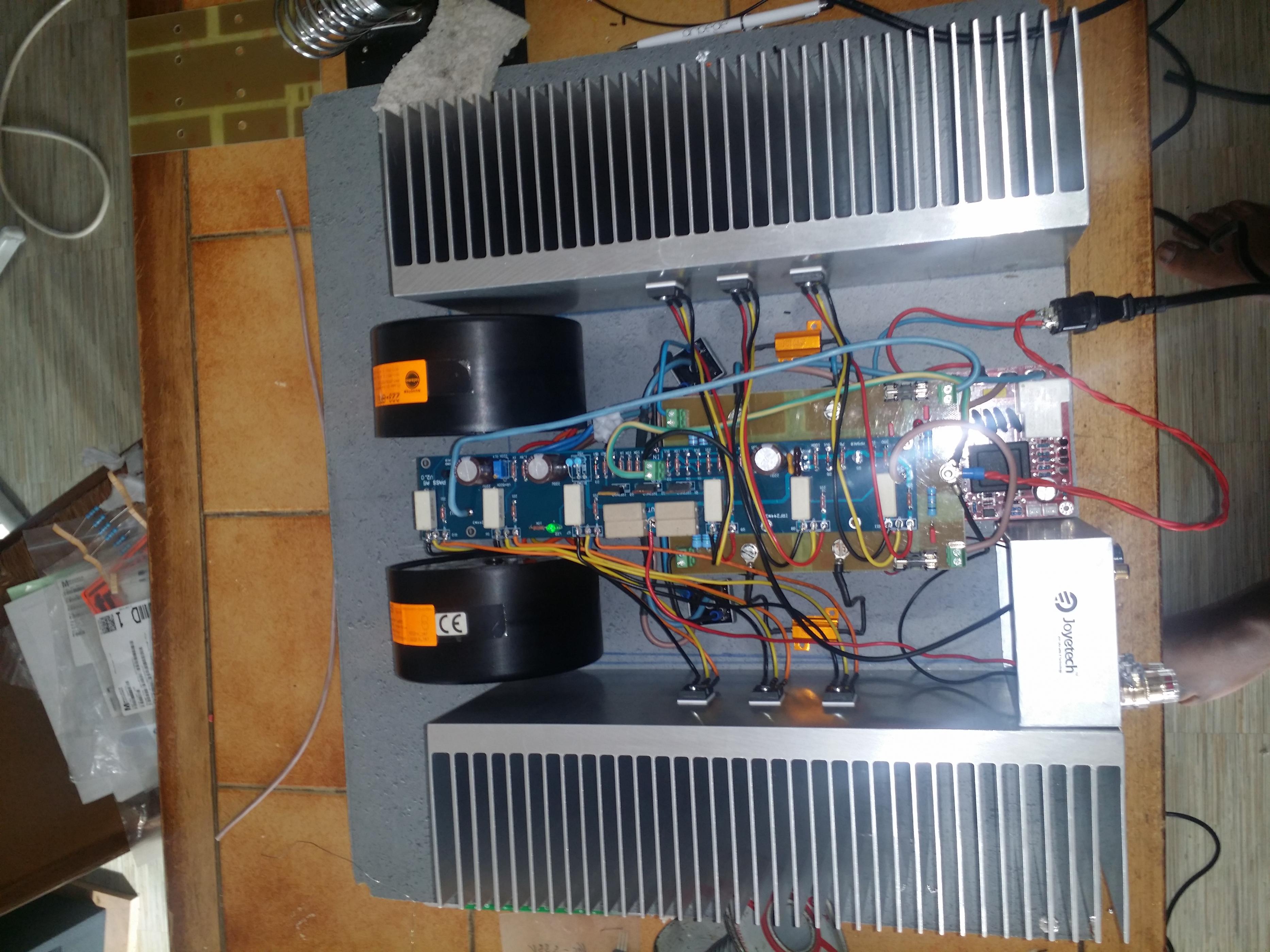

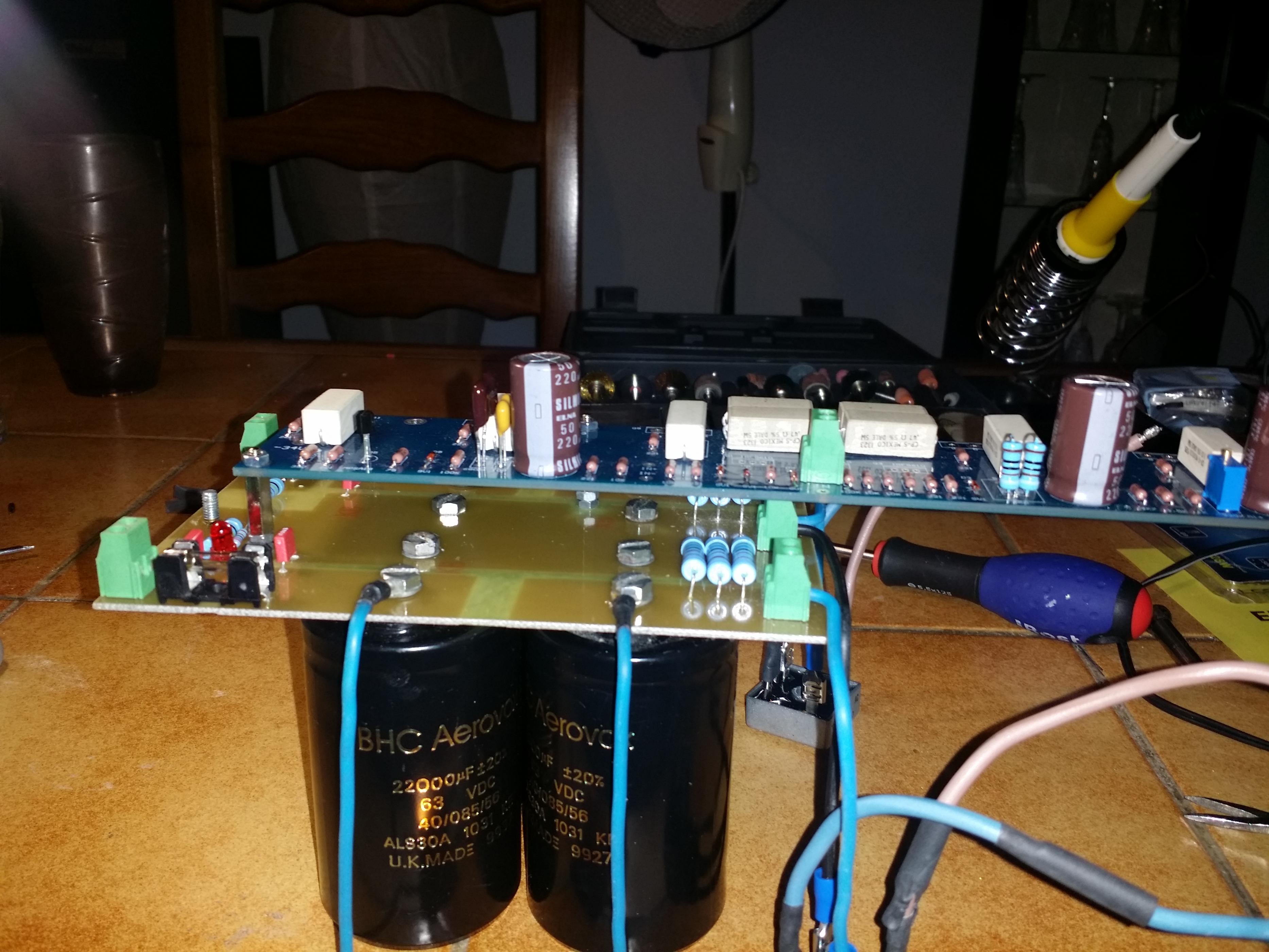

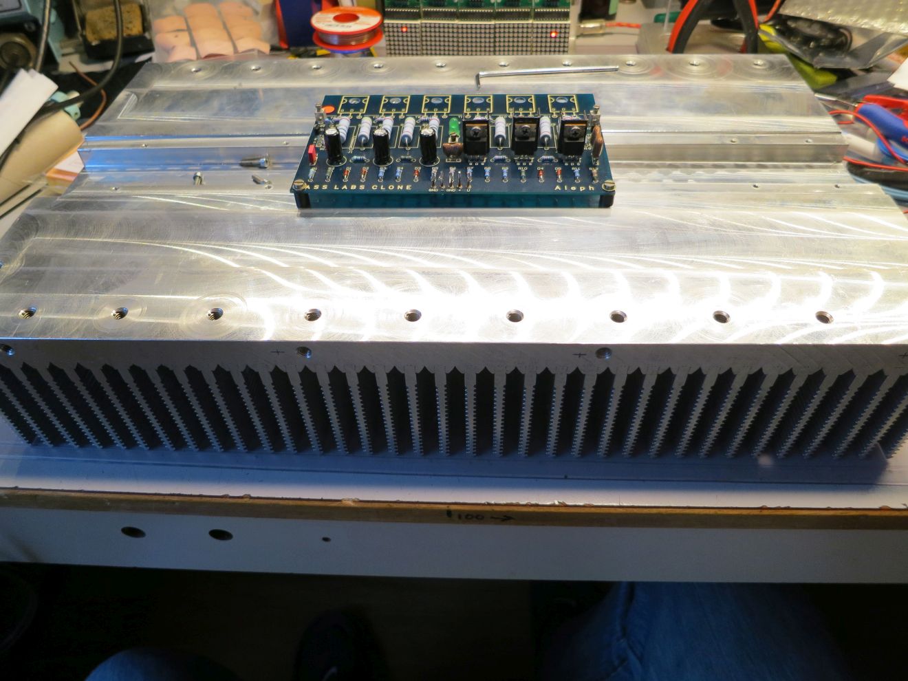

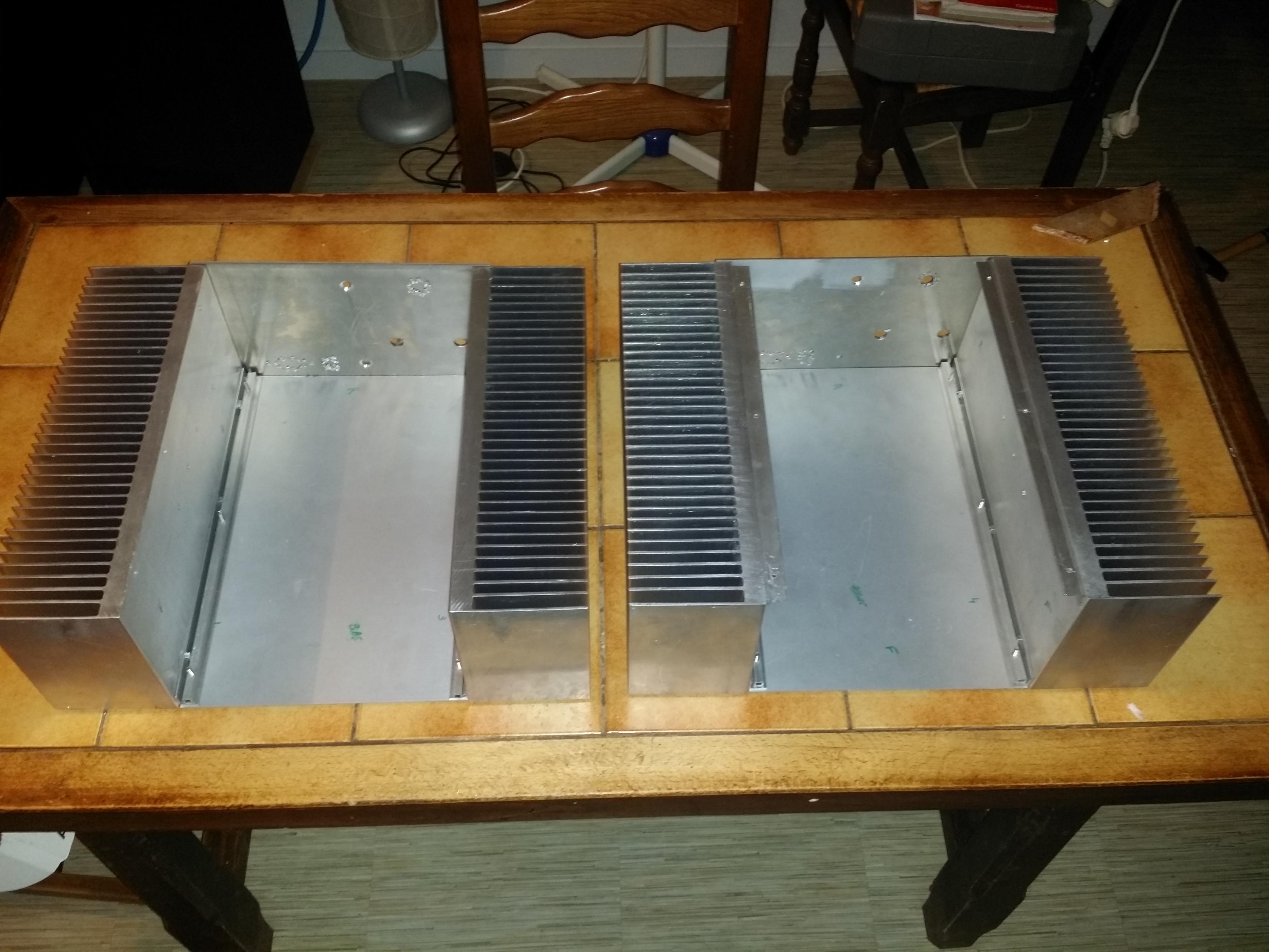

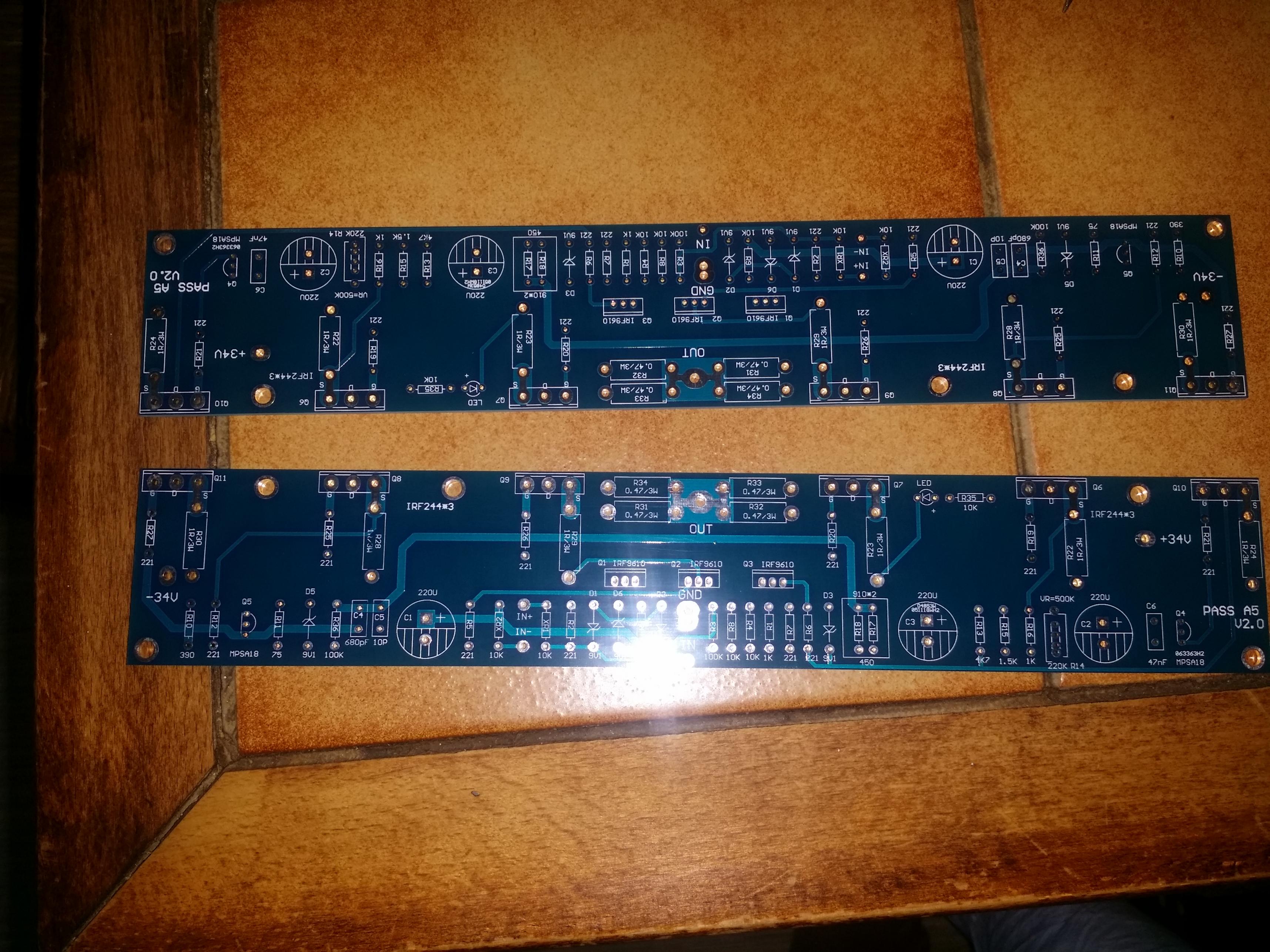

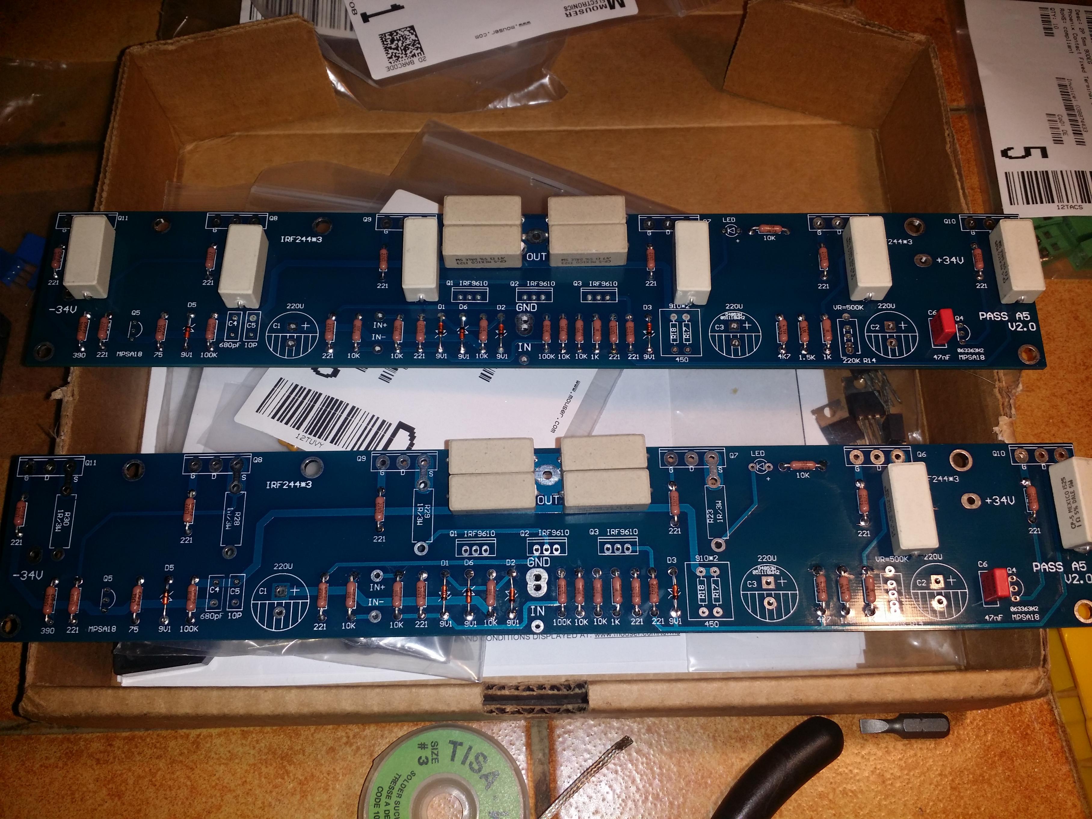

As promised here are the pictures of the construction of 5 aleph.
the result is how to say: Breathtaking with aleph P 1.7
Thank you for your help and your advice you are super awesome

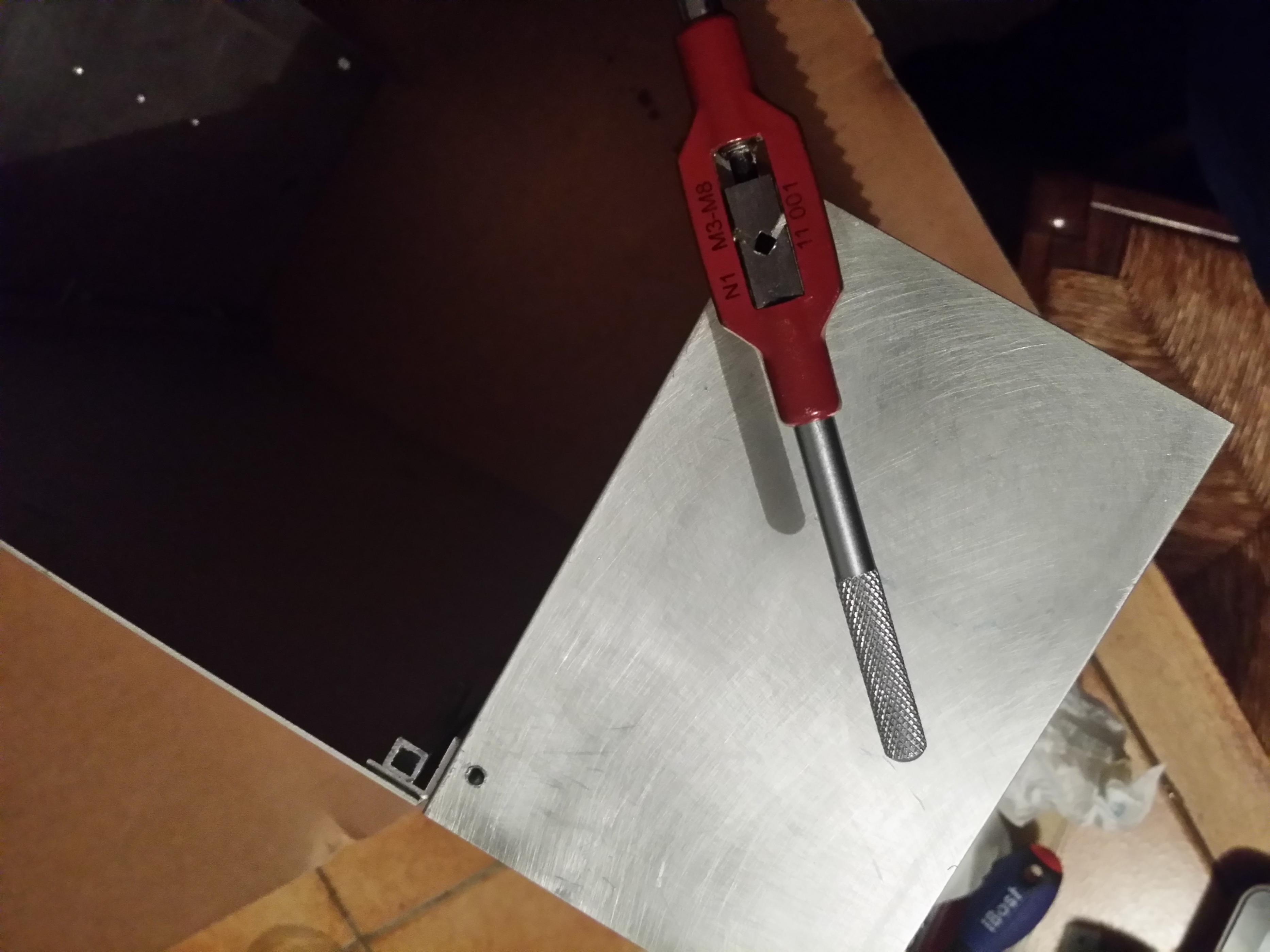

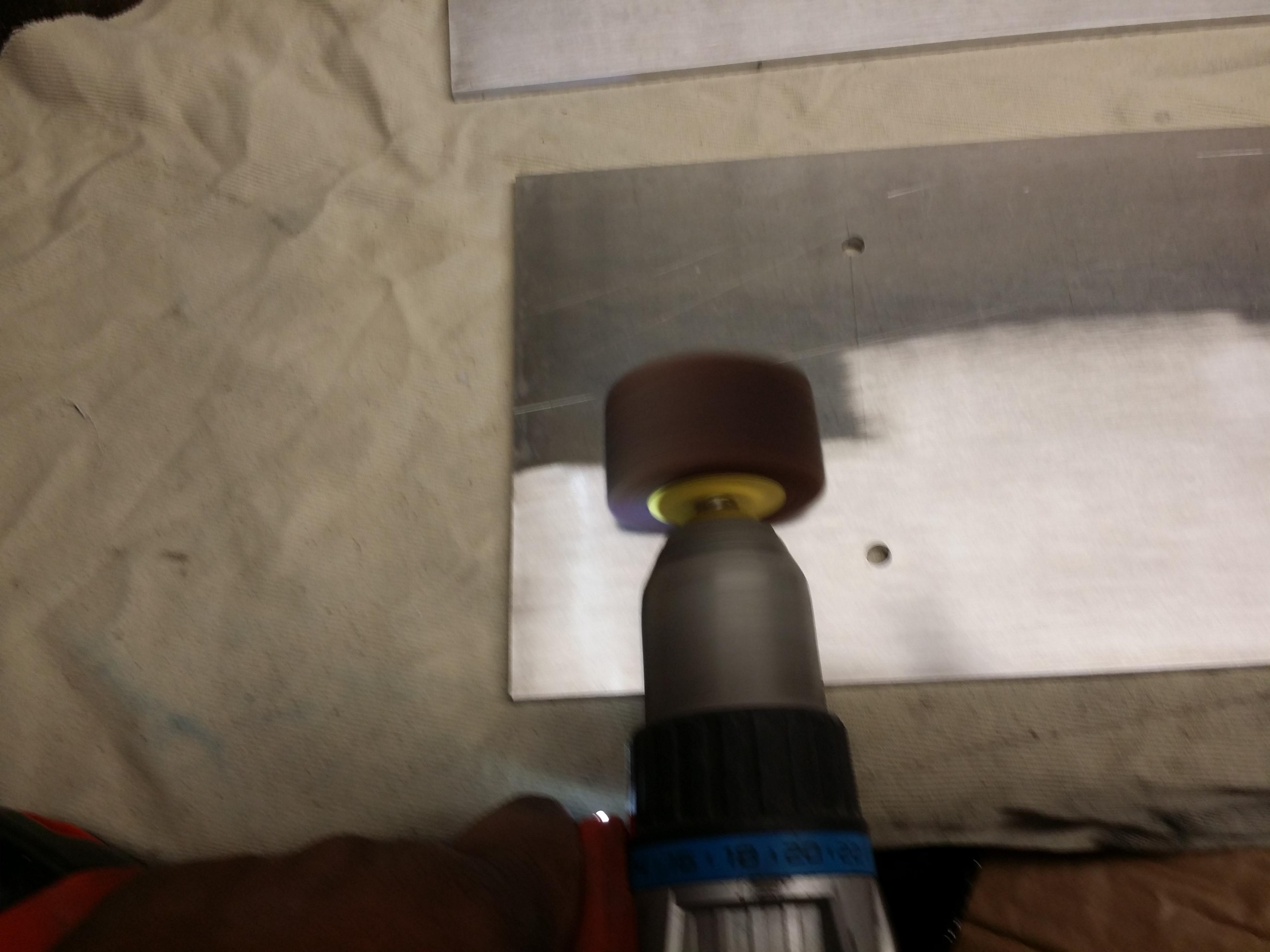

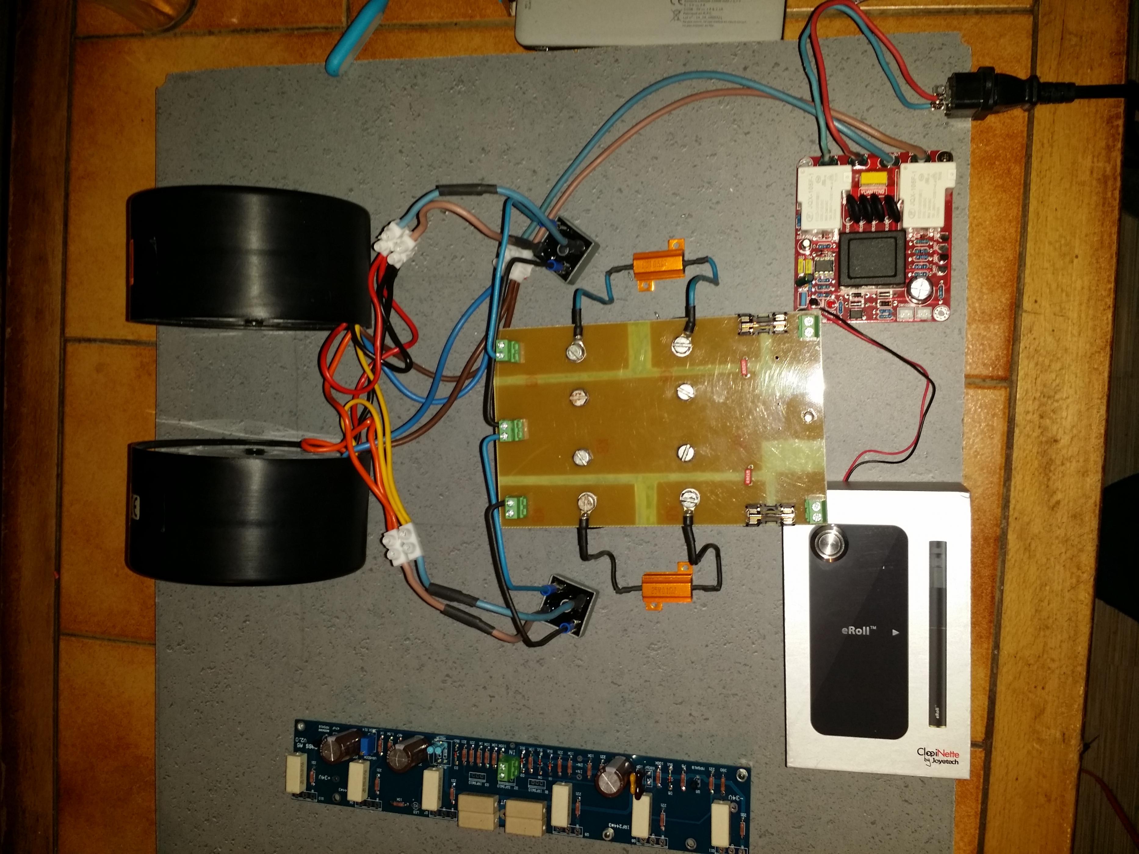

second elements
The box part 1
The box part 1

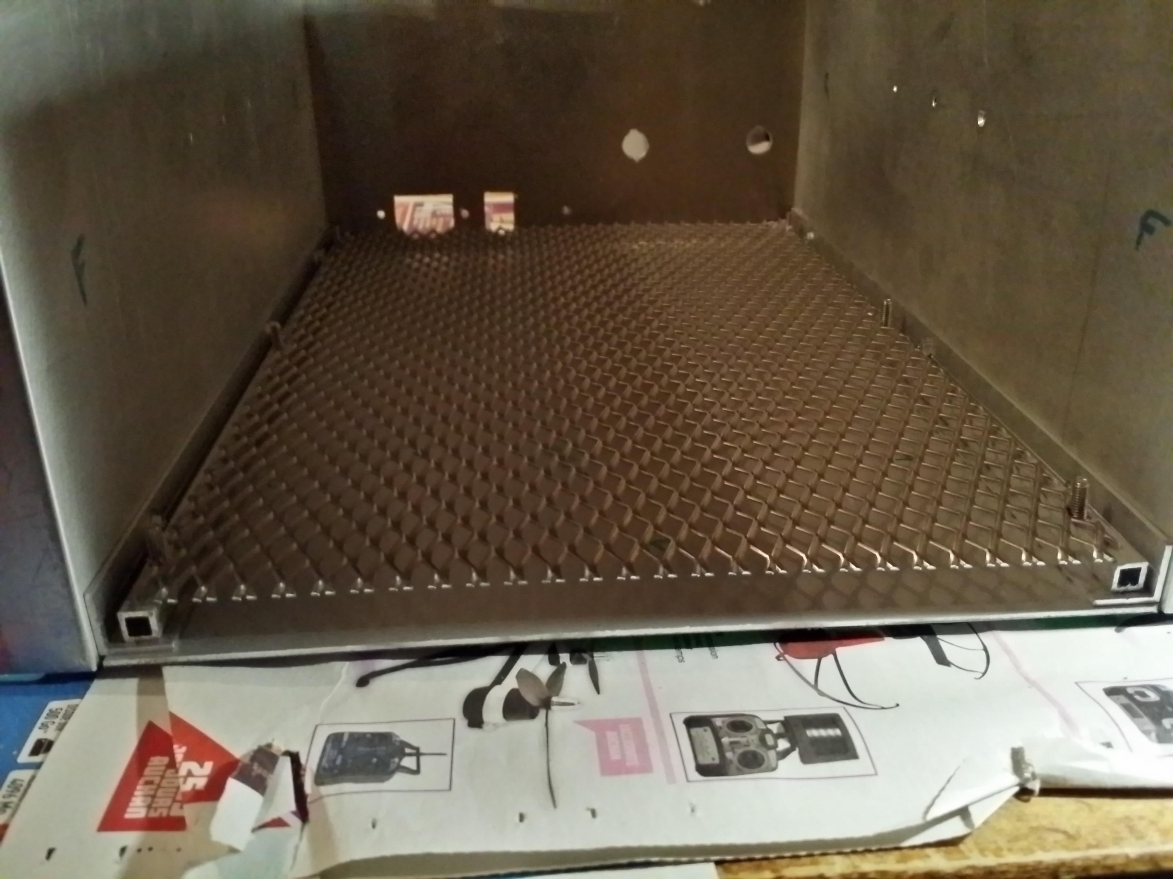

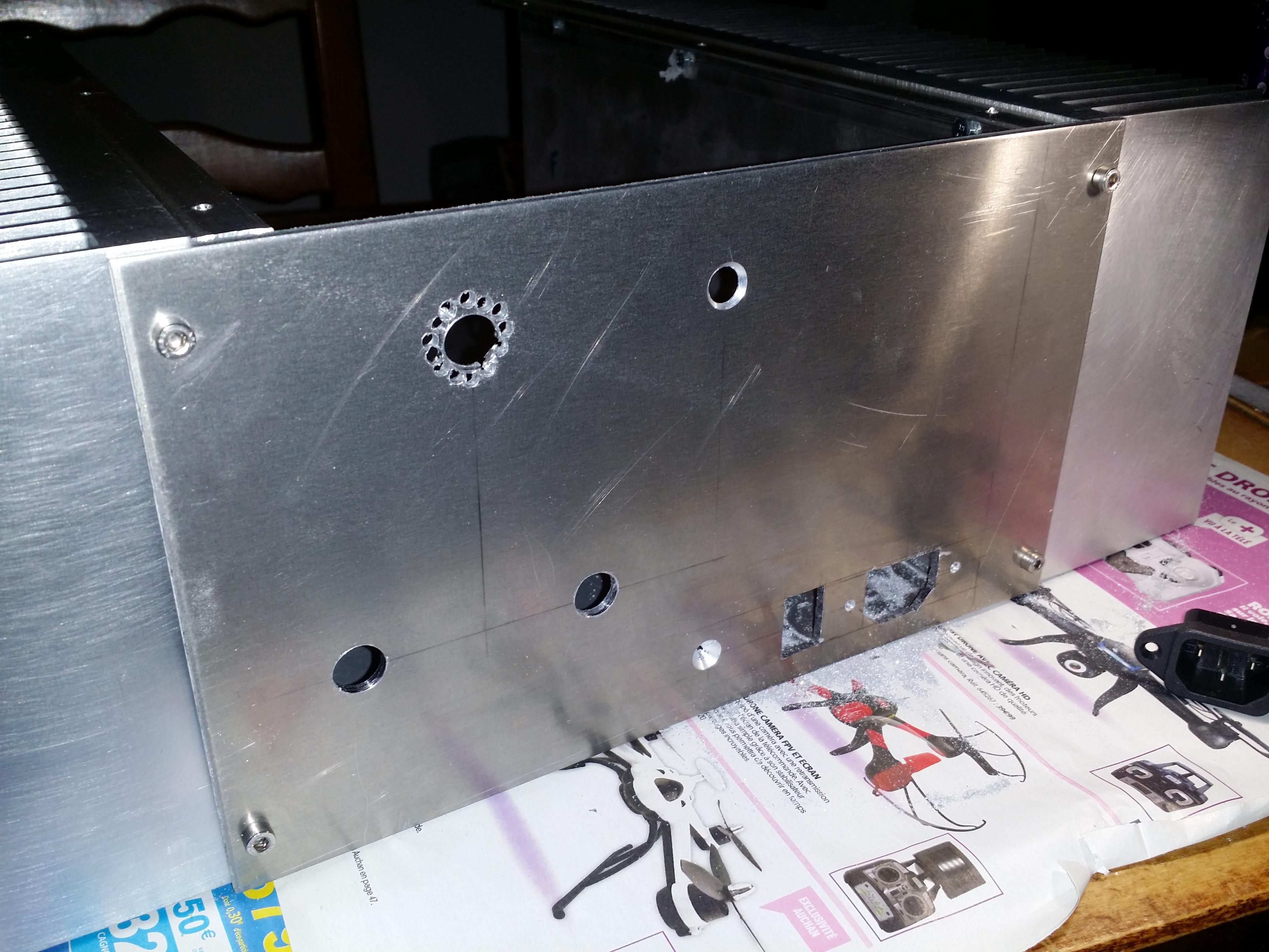

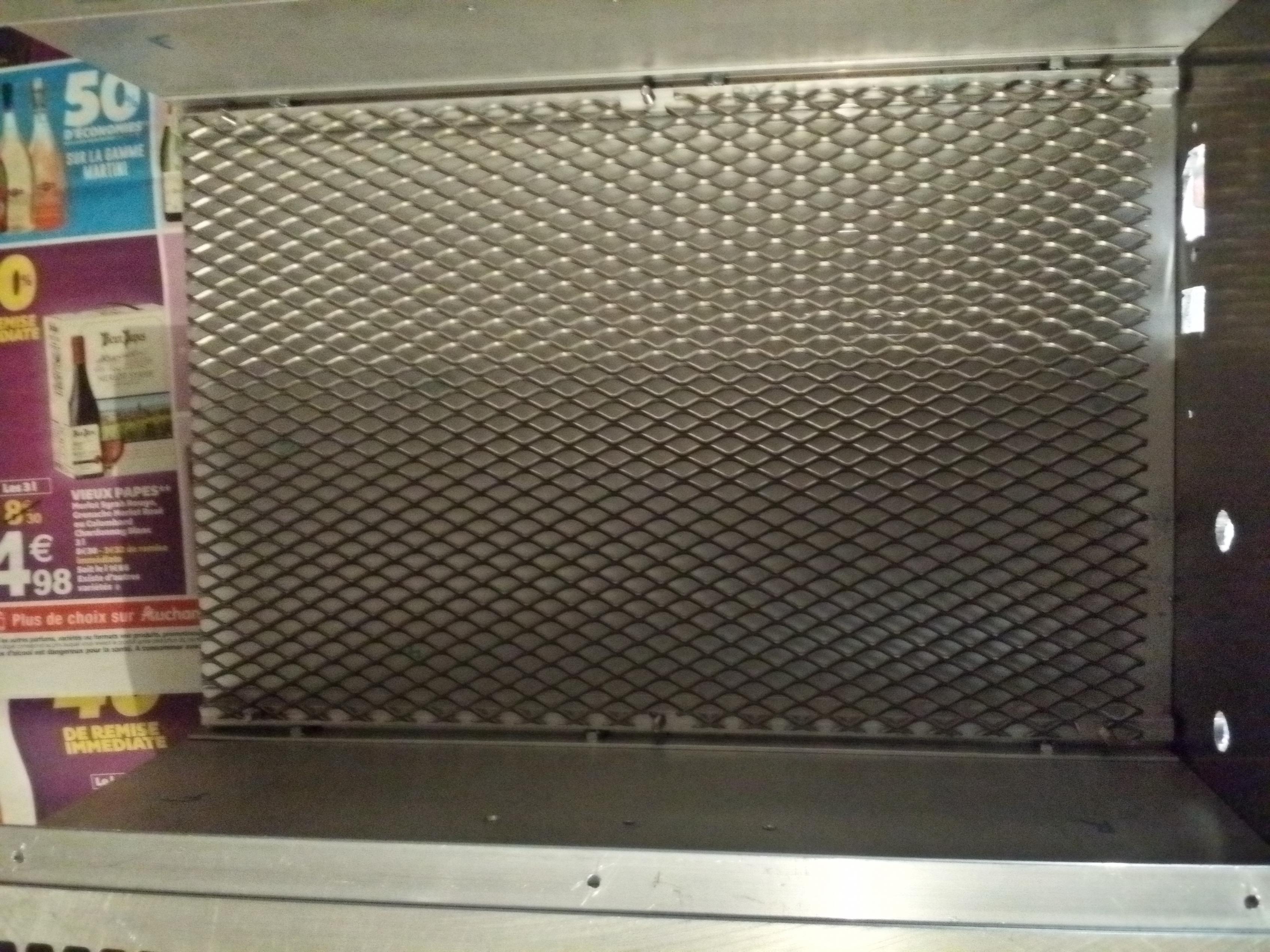

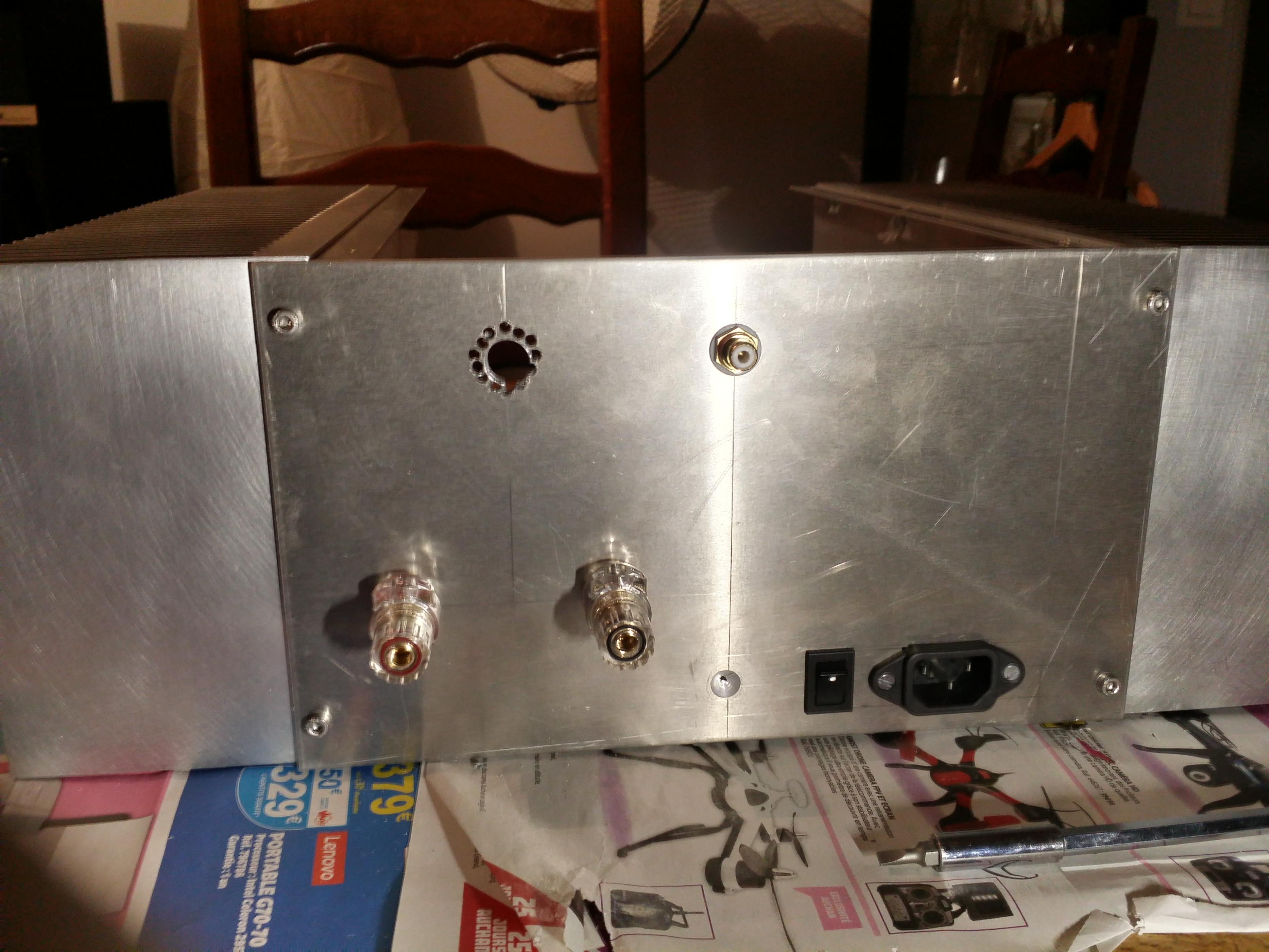

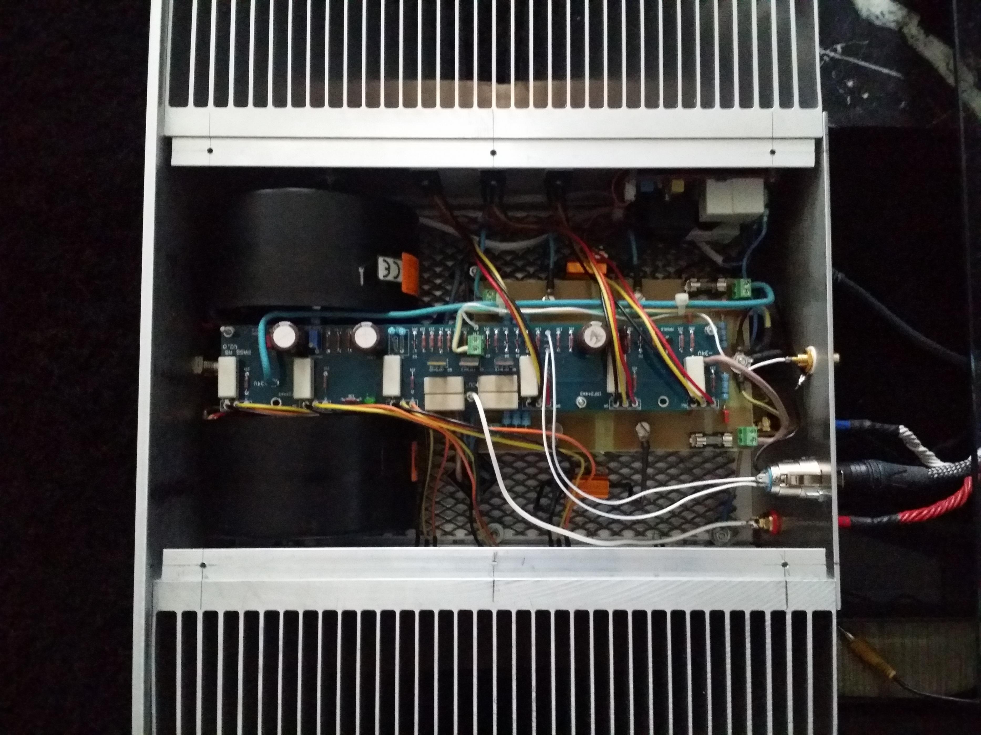

the box
I used the metal mesh to secure all components and have no attachment to the bottom of the box
Nice! Big mono blocks. Why did you put the wire mesh in the box?
