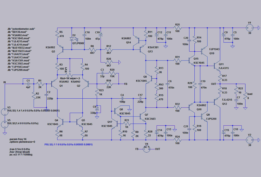

I've not seen the two that far apart before. I simulated it though and it seems to work very well indeed. Here is what I simulated - I have even laid out a PCB for this (a compact one - for a limited size case) but have not yet got around to building it. The CFP drivers may be excessive 🙂

Hello jaycee
The value of C4 and C17 are relatively high, is it because it's a beta enhance vas, have you try much lower caps value ?
Quite all beta enhance vas I've seen used high value cdom capacitors, this type of vas seem prone to oscillate.
Have you calculate the resulting miller capacitance value of your 2-pole comp vas ?

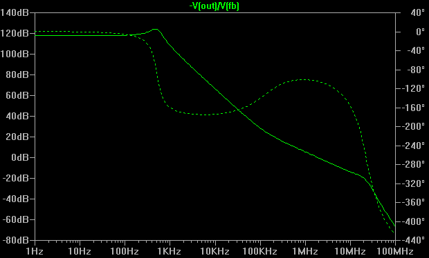

lower values caused oscillation. You'll see also the R-C network in the feedback path, this was also needed. I plotted the loop gain. There is a peak at 500KHz but this doesn't seem to cause a problem. The 0dB point is at about 1.9MHz with a phase of -104 degrees.
In simulation I've thrown square waves and sines at it, and it seems stable. It's also stable into a 1u capacitor, although it needs an L-R parallel network on the output for that.
I think 5th element tried a similar circuit here too, with good results.

I will be bluntly honest - my math skills in design here are non existent, and the values/stability largely worked out by "feel". I now have a 60MHz scope so when the time comes, i'll be able to build it and tweak it for real, rather than just by simulation.
