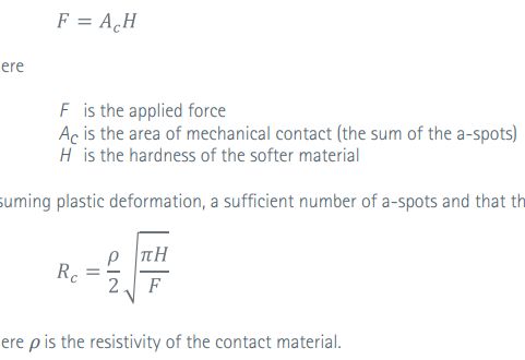

There's 6 Ohms of resistance in the voice coil, unavoidable, essential, accounted for in the design.
There's maybe another Ohm in the wires and connectors, but usually less.
A BAD connection hurts. And is somewhat common. But a good connection is a good connection.
If you have a specific number of Mhos you need to shave out of a connection, that formula shows:
1) there is no way the answer will be Zero Ohms
2) conductance changes as Square Root of change of pressure and softness, so a 10:1(!) increase of pressure is only 3:1 change of Ohms
3) in math the hardness can go to infinitely soft; but the top ten conductors come in a limited range of hardness; you can't thread Mercury and you don't want naked Lithium.
Don't over-think.

@PRR "conductance changes as Square Root of change of pressure and softness, so a 10:1(!) increase of pressure is only 3:1 change of Ohms"
perfect
thank you PRR
perfect
thank you PRR

You're talking about skin effect in a wire. But here it's just a simple matter of connecting two wires together through a common conductor over a very short distance. The amount of skin effect that might be encountered in that situation is so small as to be completely insignificant.
You won't be able to measure or hear the difference.
