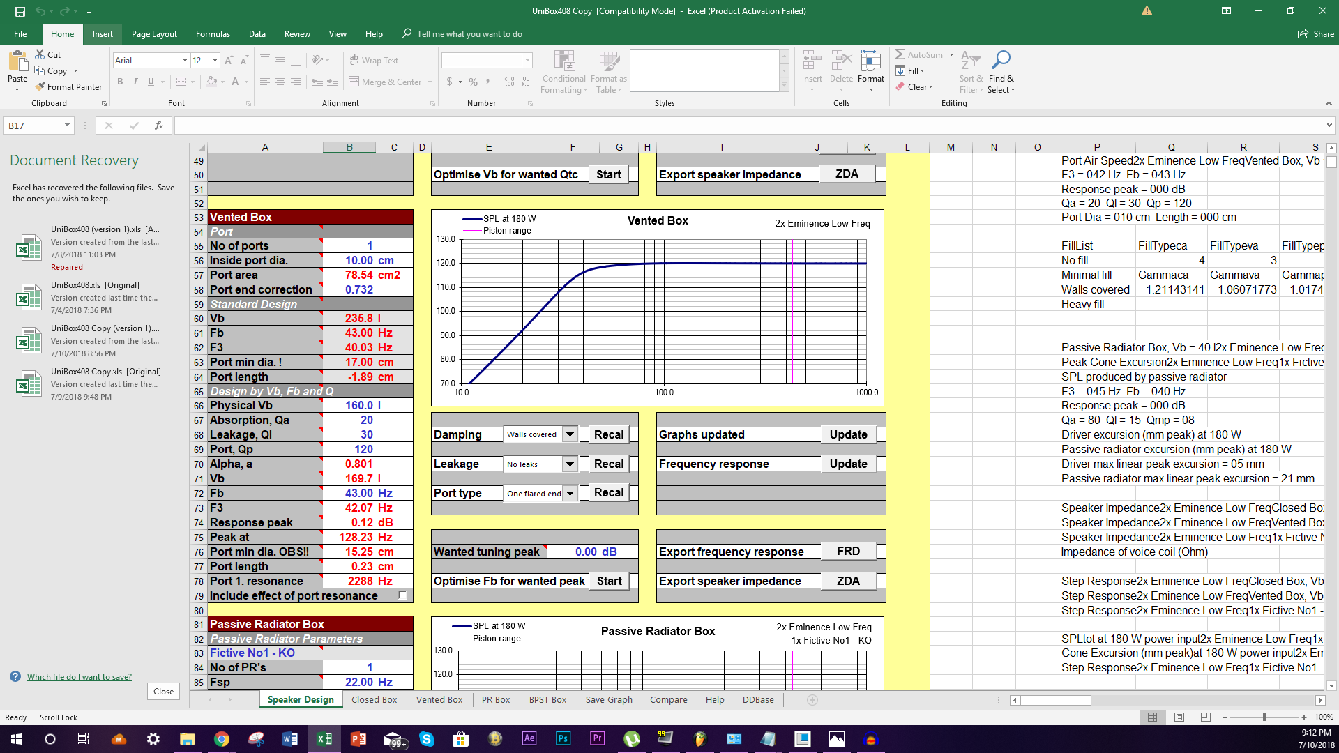

Well, let's look at the response in light of the relationships I listed above.
First the response is better than before but you are still getting a rather anemic LF response which means that you aren't getting enough contribution from the port or the port is tuned too low. Or both.
To fix it:
- start increasing 1 or the other. Since you are looking for an F3 in the 33Hz area, move Fb up to 33Hz to start off with.
- If the LF response is still too weak or in other words you want the contribution from the port to be louder, start to increase the box size.
- Take it up in 10L or 20L increments until you get what you want or until you reach the standard design Vb, in this case 235L. Usually I don't like to go larger than that.
- Still not looking good? You need to increase the port tuning frequency again then until you get close to or up to the standard design suggested Fb of 43Hz.
- Now you are going to be pretty close to the suggested alignment which means that you are probably going to have that sharp corner dropoff in the FR (this dropoff is often referred to as the'knee' of the FR). Notice that both the dropoff and the peak of the port response are pretty close to your tuning frequency (look at that top graph in the vented tab if you need to), so to do reduce the port output right there at that frequency and get a more gentle rolloff, try decreasing the box size again. And just a little tip: as the tuning frequency starts to get higher, the need for that more gentle rolloff diminishes or in other words, a steeper rolloff becomes more acceptable. Bonus points if you can tell me why. (hint: go back and look at the room gain graph I posted earlier)
- Now if you've followed that correctly, that should pretty much be the best FR you can get out of this driver. Pass or fail for your purpose?
Of course, you don't have to follow this exact course of action to find a good alignment. Anyway you go about it is fine as long as you get to the right end result. The above steps are hopefully intended to give you the necessary insight into the what and why of what you're doing, into the cause and effect relationships between Vb and Fb and the vented FR.
23.PNGI'd say the steeper drop doesn't matter as much because it is dropping at frequencies that are below the F3.
I got it looking better but I think the F3 is too high and the port length is very short.
Double check all your data up top because none of your Standard Design data coincides with mine for those 3 drivers. Might just be resistance again. Could be something else.
Then try to keep in mind that you are shooting for an F3 of about 33Hz plus or minus, since for most music, there isn't much content below that. F3 for all those drivers is presently lower than that. Which should make sense because you have the tuning for all 3 set fairly low as well.
Notice again this is all about design goals. If you wanted to use these driver for movies with content down to 20Hz, then indeed you would be shooting in this case for an F3 down around 24Hz-25Hz or so, and be tuning the box down that low too. But for 99% of music, an F3 of 33Hz or so should be fine.
So as you start to raise Fb, the sizes of the boxes you have are likely to mean that the port is going to start getting too loud so you are going to see peaking in the FR. That's when it's time to reduce Vb again.
In effect, it's a sort of game, back and forth changing Vb and Fb until you get the response you are after. Or not depending on the driver. And don't forget, once you get the FR looking the way you want it (a gentle rolloff with F3 of about 33Hz), have a look at xmax and increase the power right up to the limit. Then at the max SPL, check to see that port diameter will not be producing any chuffing.
Try all that out if you can and I'll check in on you again tomorrow.

Ok, that is so much better. That is exactly what I'm talking about. In this case it doesn't really matter if the port length is short (port length isn't 1 of our design criteria although if it does get too long, that can actually be a problem), the fact that F3 is too high makes it a fail. Wouldn't hurt to look at how loud this'll go too and especially how much power you'll need to do it. Unfortunately, there is always this tradeoff - you can't really have both a high sensitivity driver like pro drivers where you need very little power to go loud, and have really good LF extension at the same time, unless you go with very, very big boxes.

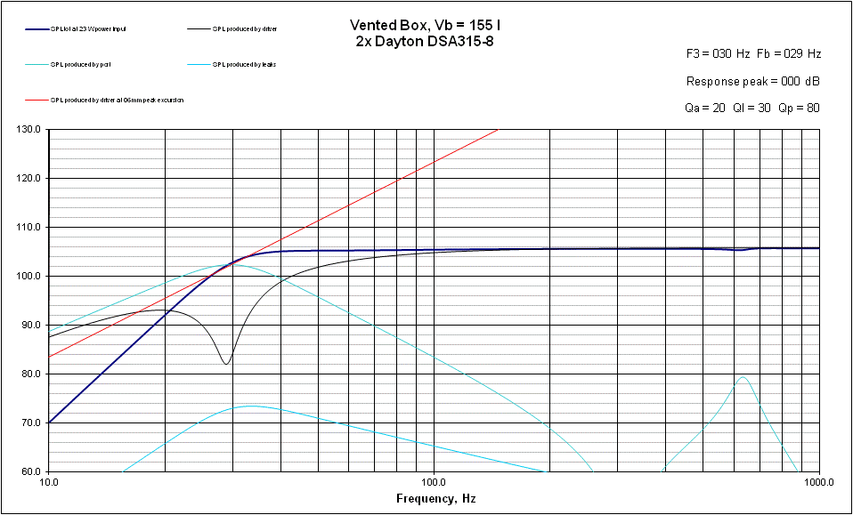

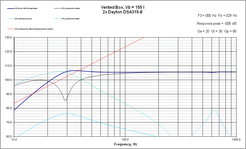

And just in case I'm not posting enough graphs😀, I thought maybe a visual explanation of room gain and the gentle rolloff idea might help.
chart 1 - a nice gentle rolloff
chart 2 - the same alignment now with the 17' room gain added in. Flat to 30Hz
chart 3 - a sharper knee at the rolloff
chart 4 - and now with the room gain added in. Peaking now instead of flat.

That looks better. Very close to what I got. And that's quite a nice response. That'll be good even with movie content almost right down to 20Hz at 110dB at 1 m. And don't forget, that's a 10" not a 12". I would add that to you list of candidates.
