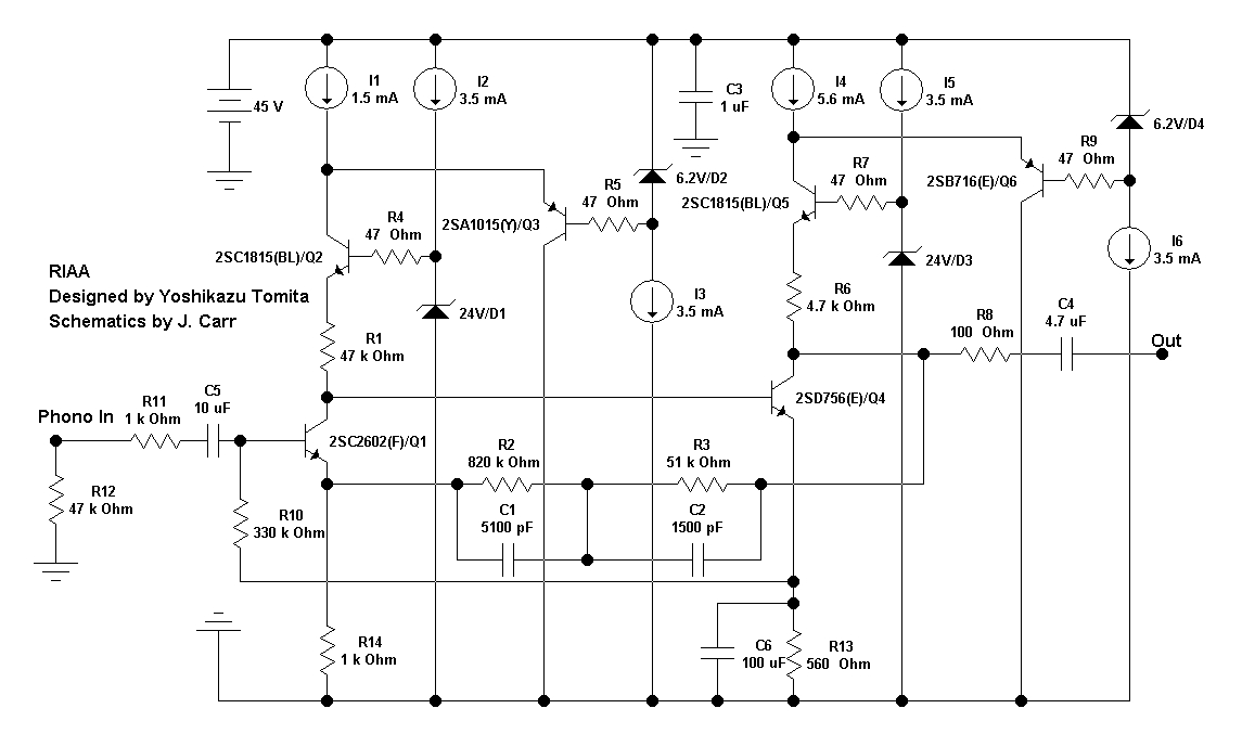

For me the greatest benefit by use of a shunt regulated power supply version is the use of very large capacitors directly at the supply input of the signal amp unit - i. e. parallel to the shunt unit (e. g. zener diodes). If I use a serial regulator (the usual solution), this isn't possible without additional steps.
Therefore I prefer shunt regulated power supply versions (except for power amplifiers).

I am looking for best possible topology of shunt regulators for line-stages and RIAA stages with op-amps or discrete versions. Especially the distribution of the currents is of interest.
Until now I make a distribution of 50%:50% (fifty - fifty) This means, when the signal stages need approximately 10mA, then I planned for the zener diodes resp. the shunt regulator also 10 mA. But I don't know, whether this consideration is really correct.

??? The only shunts i see here are the zeners, producing reference voltages for series regulator transistors !Example of Shunt Reg used in the Tomita RIAA:

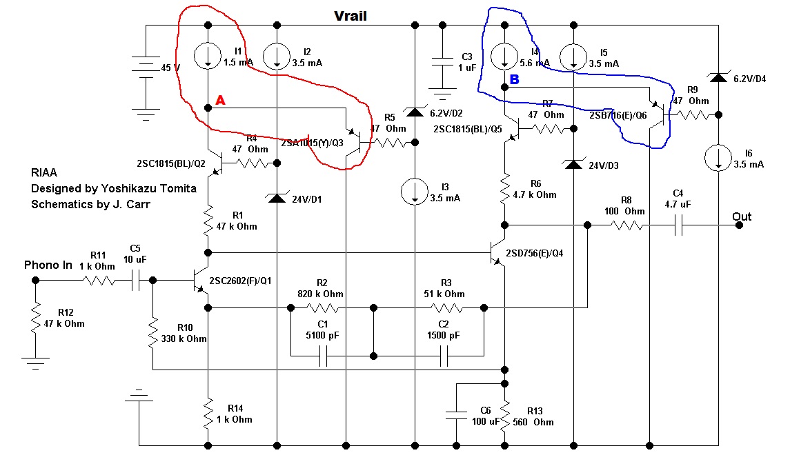

Nodes A and B are set to (Vrail - 5.55) volts, by the shunt regulators shown in red and blue, respectively. The shunt elements are Q3 and Q6.
Each shunt regulator forms the first stage of a two stage regulator pair. Shunt regulator Q3 is followed by series regulator Q2, and also shunt regulator Q6 is followed by series regulator Q5. It's very elaborate.

No, if Q3 and Q6 where shunts there would be a constant voltage on them but that changes with the power voltage.Nodes A and B are set to (Vrail - 5.55) volts, by the shunt regulators shown in red and blue, respectively. The shunt elements are Q3 and Q6.
