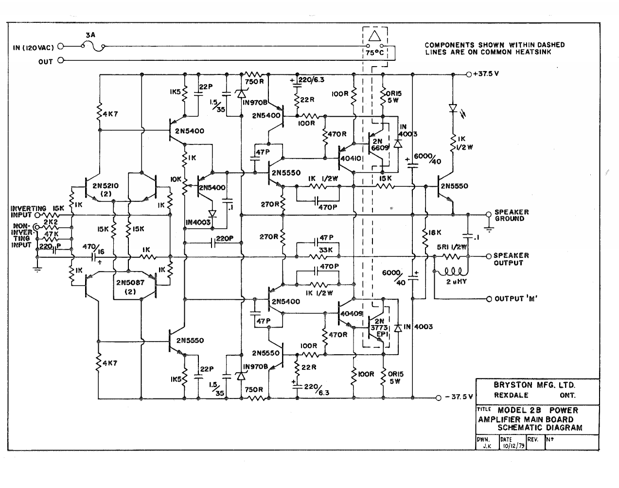

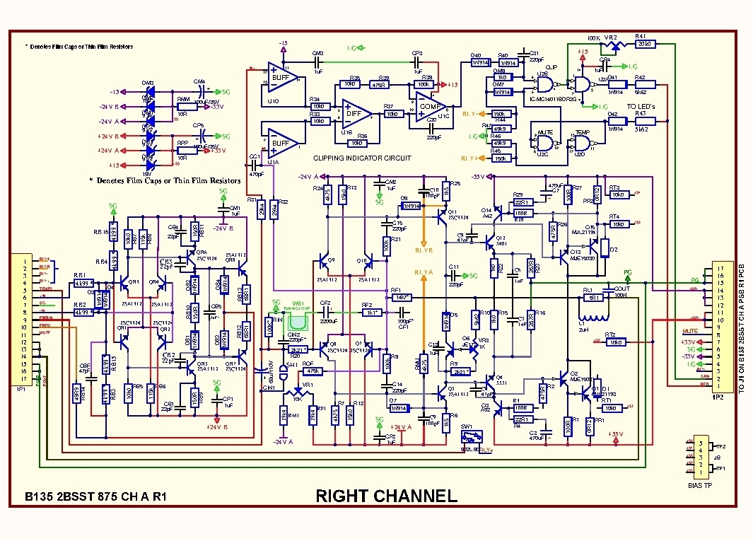

I have the first Bryston 2B power amps
I have the schematics of the first Bryston 2B, and also the Bryston 2BSST
Those two amplifier do have the sames base for their topologies, but there is somes differences in the schematic who made the Bryston 2BSST sounding much better
Which minimums modifications I would need in the circuit of my old Bryston 2B to made it sound very close to the Bryston 2BSST ?
I include the schematics of those two model power amp section, I found the schematic at that Bryston web site,

Those two schematics are quite different its no wonder they sound different and its not a simple job making it "sound like" the newer version .
You had better ask a Bryston owner who has heard both of them to give an opinion as I don't know the "Bryston Sound " .
A good design shouldn't have a "sound " -IMO- it should be neutral but each to his own.
