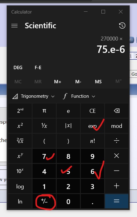

270k is 270,000 ohms and 75uA is entered as 75E-6 on a scientific calculator. Once entered it expands out on this calculator to 0.000075
So we have 270,000 * 0.000075 giving 20.25 (volts)
i tried doing on the calculator as suggested but i cant be doing it right as it doens't exactly come out as it should🙁

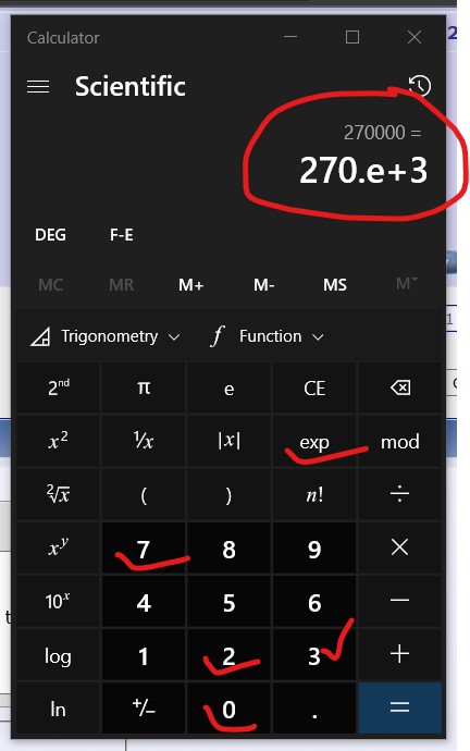

On the Windows calculator try this.
Enter 270 and then press the exp key and then press 3. You should see the display show 270,000 like this.
Now press multiply and enter 75 and then press exp and press 6 followed by the -/+ sign to change the exponent to negative 6.
Now press = and you should get 20.25.

yep works on both NP.its all a case of i didnt have a clue how to work it 😕
im affraid maths never was my strongest subject and i never did any of this at school ,so it realy is brand new for me, all of it.
but at least now i know how to do that, thanks

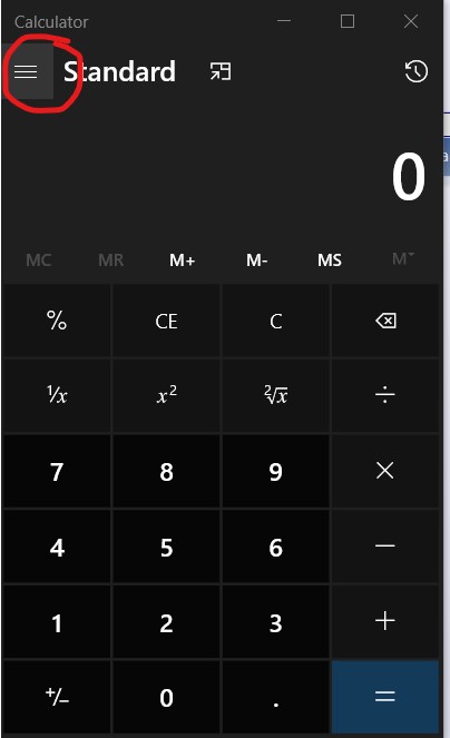

Try this on your Windows PC using the standard calculator and also the scientific one. You change between them with top menu.
Enter 3+6*12=
Answers on a postcode 😉 They can't both be right... can they 😀
(One gives 108 as the answer and the other gives 75)

I still don't see where * comes into the Windows calculator. It isn't shown as being on any button and no keyboard is used when using the calc (use the mouse). It uses the tradition X for multiply, same as the Casio's
> Enter 3+6*12=
I also do not see a keyboard issue.
The question is Order Of Operations (hey, OOO!).
Since the 1800s at least, exponents/roots come first, then multiply/divide, then add/subtract. BODMAS!
So in "3+6*12" you do the 6 times 12 first, then add 3. Answer 75.
But a simple mind might take it in order as written (ignoring hundreds of years of experience). 3 and 6 is 9, times 12 is 108.
"Many simple calculators without a stack implement chain input working left to right without any priority given to different operators, .... while more sophisticated calculators will use a more standard priority, ....The Microsoft Calculator program uses the former in its standard view and the latter in its scientific and programmer views.
