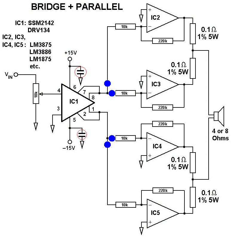

are the capacitors circled in red electrolytic? can i use electrolytic capacitors? can i use 1000uf ones? i have loads. i am using 4 on one circuit board, can i use one 1000uf capacitor per rail for all of them?
where do the input capacitors go? after the potentiometer? where the blue circles are?

Matttcattt,
Something has hit me in my had, I was too confused.
Have you read the datasheet of the LM3875?
With +/-12 volts you get something around 10 watts.
If you bridge two of them, you get 20 watts.
Paralleling you double the current.
So... with 4 chips in bridge-parallel configuration per channel you'll get 20 watts!:devily:
It's a big waste of parts, time and money.
These power op-amps are not made to work at these low voltages.
You should investigate the TDA1562.
You'll get around 3 times more power with one chip per channel than with four LM3875s in bridge-parallel at +/-12v.
And it's made to work on single voltage supply.
For these voltages I don't know a chip with more power than this.
It was made for car-audio.:nod:

Your power calculation isn't quite right: when bridging an amp the power theoretically increases by x4 since power = V^2/R
Single ended, assuming an 8R load and +/- 9v output swing....
9v^2 / 8 = 10 watts
As above but bridged to give a +/- 18v output swing....
18^2 / 8 = 40 watts.
When bridging an amp, the output current doubles compared with the single configuration. In the case of the bridged amp above, the peak current is 18v / 8R = 2.25A, which is well within the capabilities of a single pair of LM3886 devices so paralleling isn't necessary.
Bridging is an efficient way of getting high power from low supply voltages.
David.

im using the OPA541, not the LM3875. it can run with +/-4v. :bigeyes:
for the third time :dead::
Yes, you can use 1000uf electrolytic, but bypass them with 100nf poly or ceramic near the op-amp pins.
I think you only need one input capacitor, after the pot.
