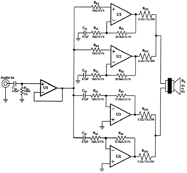

Hello,
Regarding the circuit and parts list, you should read National Semiconductor Application Note BPA-200 in http://www.national.com/appinfo/audio/files/BPA-200_Application_Note.pdf
It has everything you wanted to know but were afraid to ask...

Resistors are necesary. U5 can be any unity gain stable opamp.
(make sure it is)

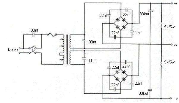

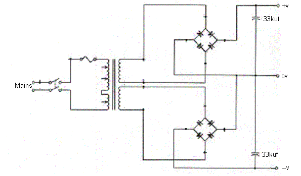

Second supply looks better. It's got some nice bleeders.
It also has snubbing caps around the bridge which help little.

The 5k resistors are to bleed the 33KuF caps when the Mains power is shut Off - this would be a "normal" type of safety precaution.
22nf - There has been a very good input by a person whose name I forgot (Please excuse me for that) about "Snubber" caps and how their use may actually make it worse. I wouldn't use them, although I WOULD use a MUR or other Fast/Soft rectifier Diode.
If you just want to try it, you just have to build it. Then make ONE change at a time to see if you like it better.

From what Iv'e heard (people saying, not equipment), having the small caps accross the rectifier should help make things quite nice. This is mentioned in the article on power suplies over at ESP, and if you have a look at the scheematics for the bryston range of power amps, they all use them in that configuration, so I would leave them in (I intend to on my projects in any case).
Yes they are required
the .1 ohm resistors are required, at least in this design. What do they do? they serve as a device to "balance" the load across the two op-amps in each "half" of the bridge. Otherwise, one of the chips would do all of the work until it burned up or its protection kicked in, while the other one did nothing. The value of this resistor can vary depending on the chip you decide to use - see the application notes for that chip. If this is your first amp (and I guessing it is), read the note until you understand it.
Its like being a cook. If you don't know how to cook and you are just starting, you generally have to follow the recipe exactly since you don't know what a substitution will do to the cake. Once you have baked a whole bunch of cakes, then you can start making your own.
The only difference is that cakes don't cost as much when you burn them, and generally don't expose you to enough electricity that can kill you.

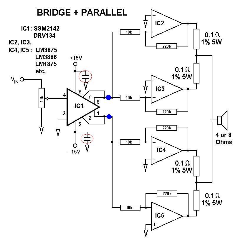

are the capacitors circled in red electrolytic? can i use electrolytic capacitors? can i use 1000uf ones? i have loads 🙂
where do the input capacitors go? after the potentiometer? where the blue circles are?
