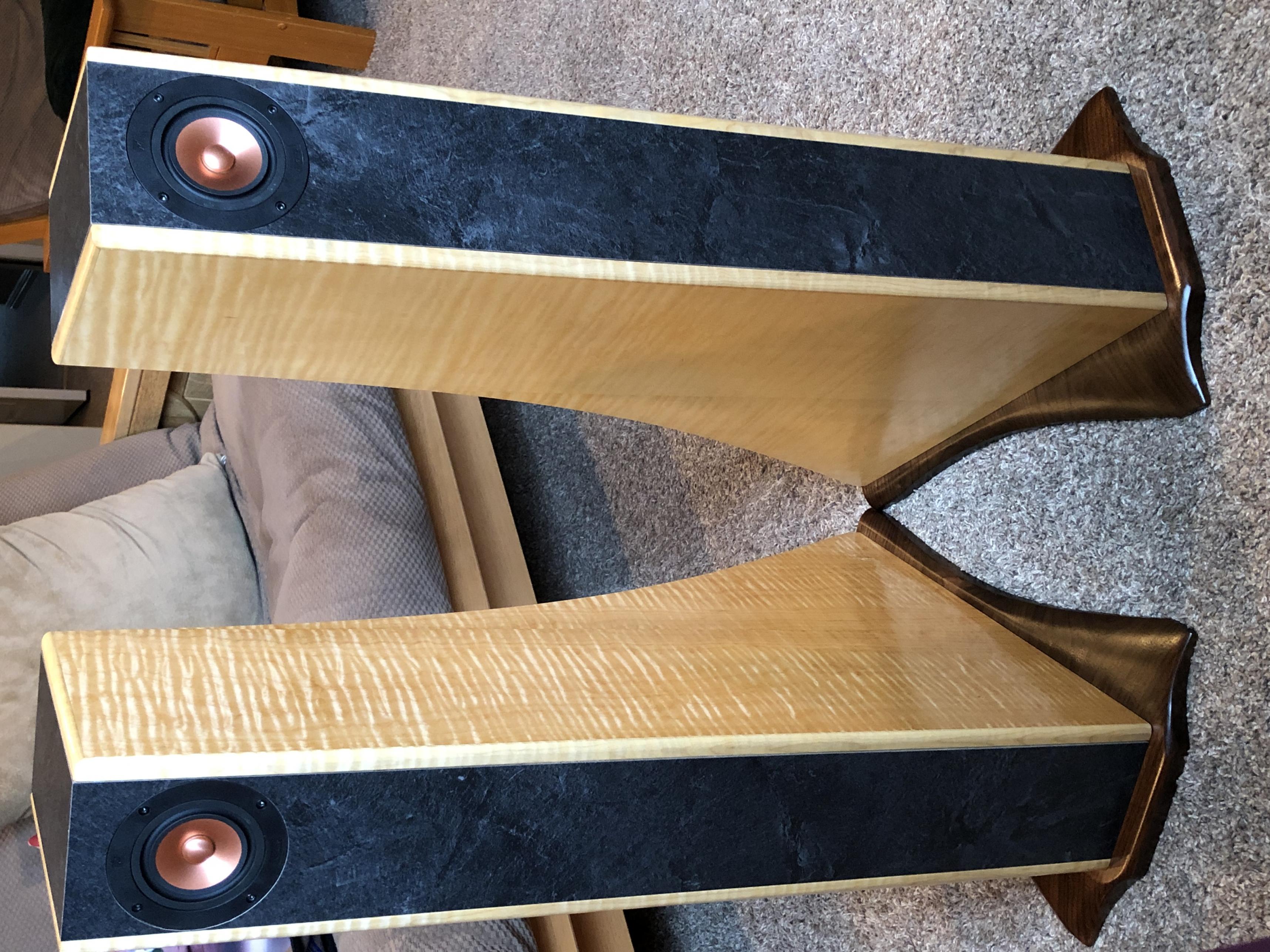

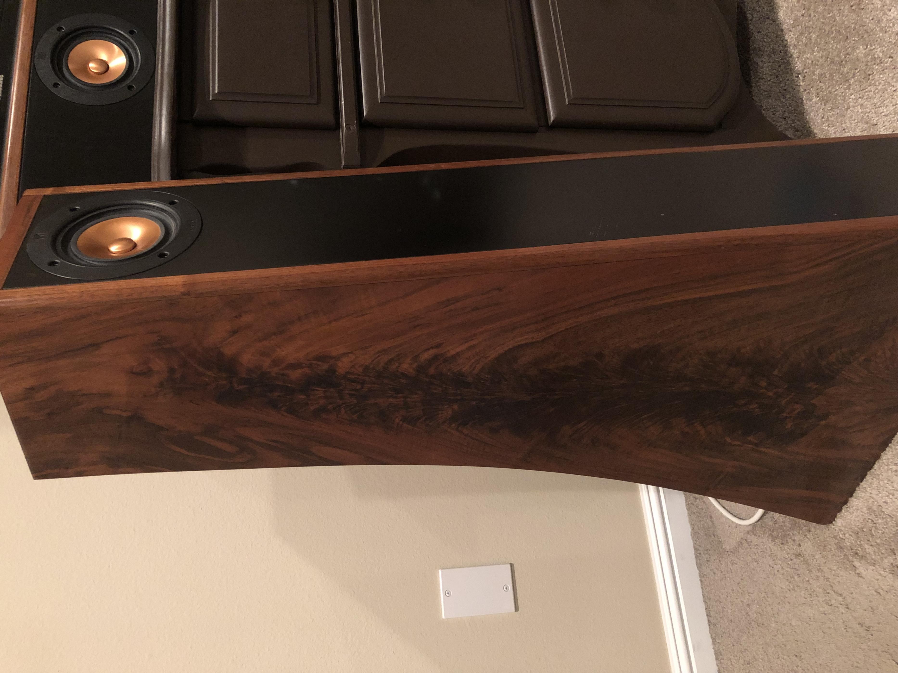

Apologies for the sideways pics...evidently I needed to take them in "landscape" mode.

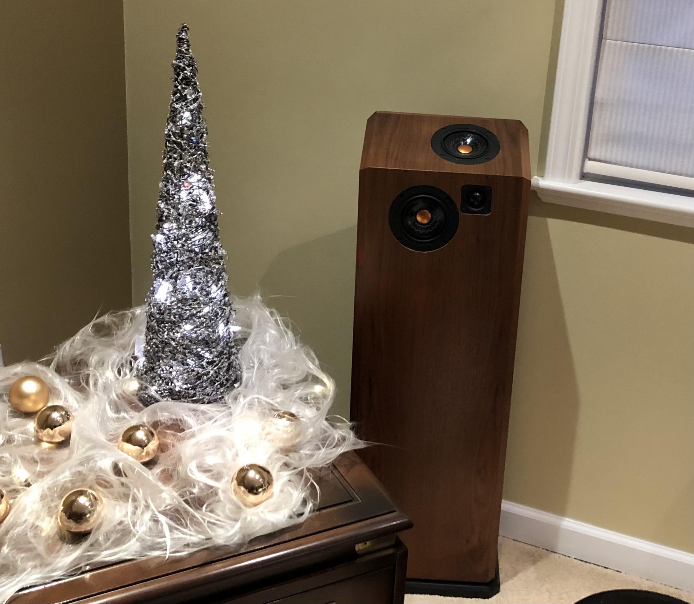

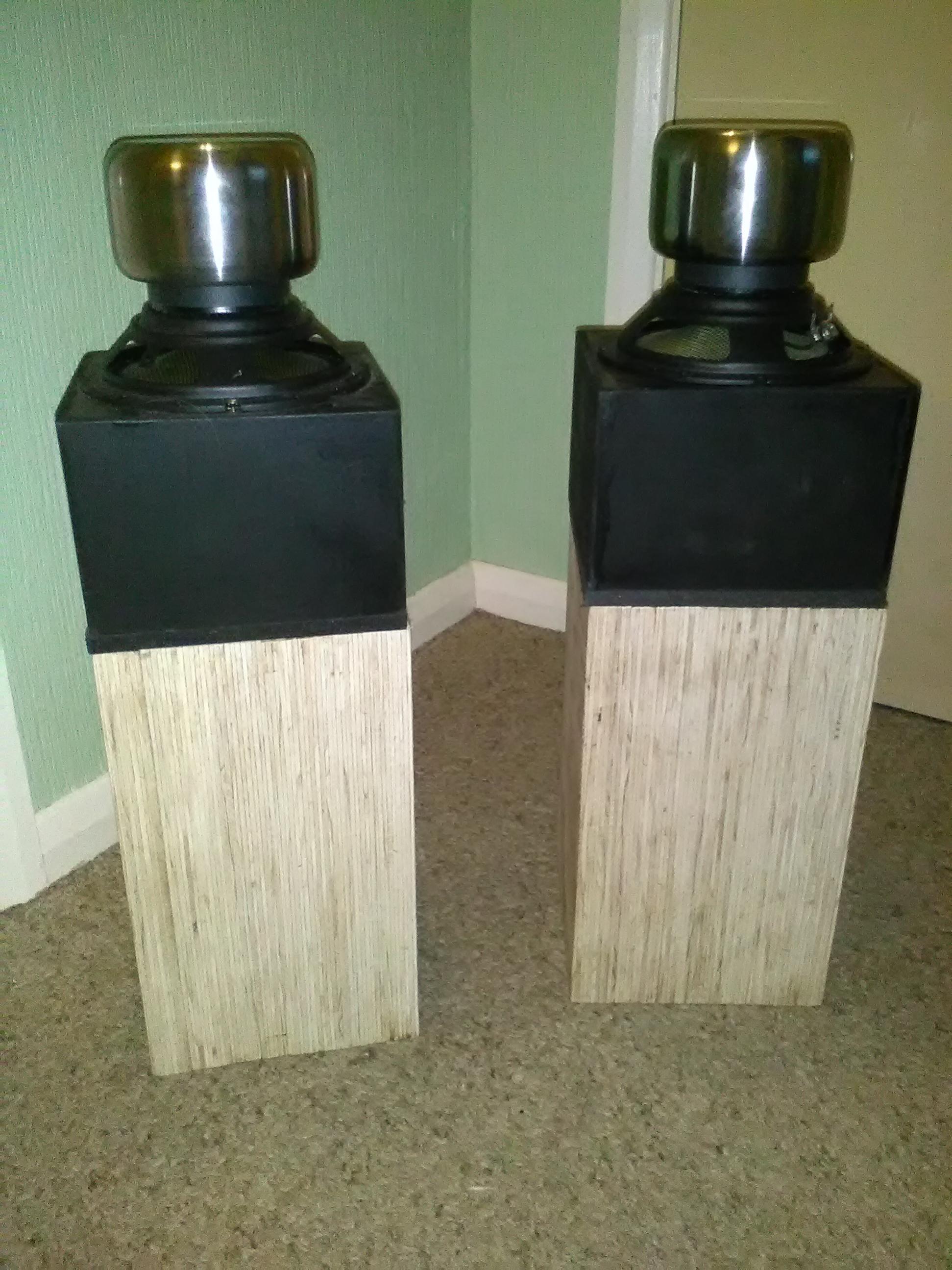

Another option I tried on my " traffic light " speakers, four identical full range drivers in each speaker, three forward facing one rear facing ( although if making them again I'd have two forward, two rear ). the centre driver in the front is run full range, all other drivers bass.
