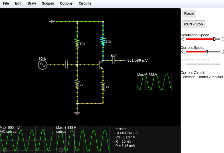

I will play around with the circuit a little and try to get answers to my questions. To start with, I changed the supply voltage to 9V. Since this will reduce the bias current into the base of the transistor, I decreased both bias resistors and got a decent output waveform with a bit of clipping at the bottom. On the test circuit I can adjust these to get low distortion.
Practically, if I build the circuit, do I need a high power ceramic resistor (maybe 10W) as the upper right resistor? Any other components needed so I do not burn anything up?

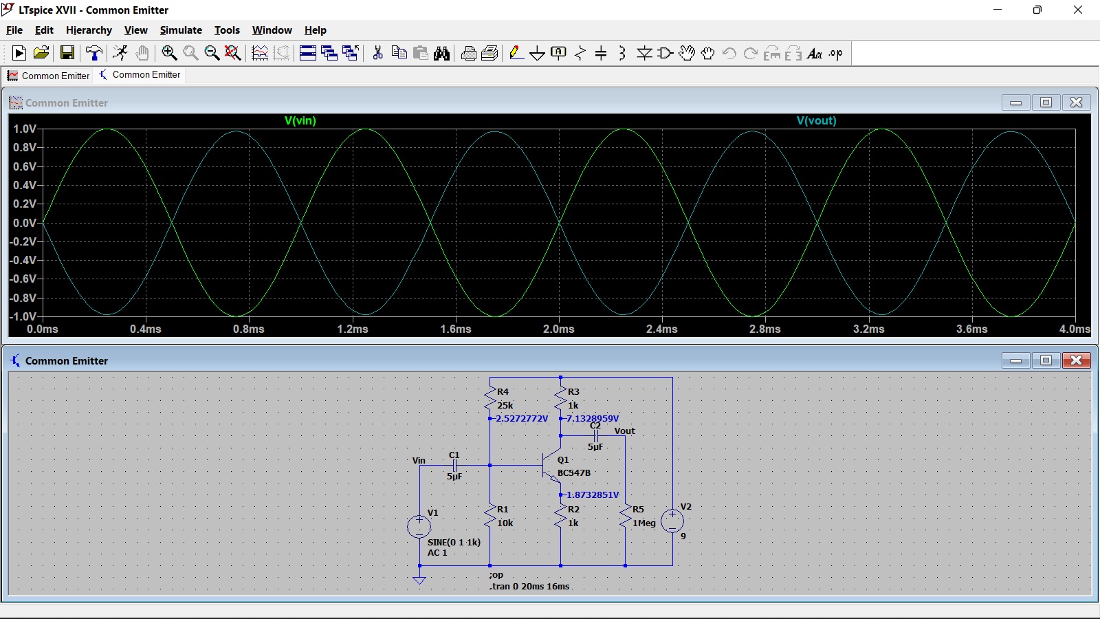

Let me duplicate your circuit in LTspice.

Here is your circuit in Spice with voltages and waveforms. Notice the phase inversion. As the input goes up, the output goes down. It is 180 degrees out of phase.

OK so I calculate dissipated power....
I should have done the calculation earlier, yes. W=I^2 * R . So one side is 35K Ohms and the other side is 2K Ohms. Assume current does not flow into the base, and assume the transistor is full open, zero resistance. For a potential difference of 9V, V=IR so as an upper bound we have I = 9/2000 = 0.0045 A. Is this correct? 0.0405 W
Assuming the transistor is not in circuit we have the 35k on one side.
Current is 9/35000 which is 0.257 milliamps.
Voltage across each resistor V=I*R so we get 25k*0.257e-3 which is 6.425 volts and 10k*0.257e-3 which is 2.57 volts. Remember the current is the same in each for a series circuit.
Add them together and we get the 9 volt total.
Power dissipation in each resistor is either the voltage squared divided by resistance or current multiplied by voltage. Both will give the same answer.
So the 25k dissipates 1.65 milliwatt. The 10k is 0.66 milliwatt. Pretty low 🙂
If the transistor was removed (or the base open) then no current could flow in the 1k's. If the transistor was shorted collector to emitter then each resistor would see 4.5 volts across it. The power in each would 20.25 milliwatt
Your calculation of 9/2000 is correct at 0.0045A or 4.5 milliamp (can be written 4.5e-3).
0.0405W (40.5 milliwatt) is the total of the 2k's across 9 volt which is 20.25 milliwatt each.

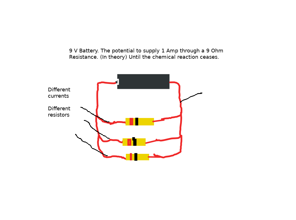

The voltage you have available and the resistance you place across that voltage determine how much current can flow. Voltage is the driving force. Whether you draw current from it depends on the load you place across it.
So in theory if you had a voltage source that could provide only 1 microvolt and if you could come up with a resistor of 1 micro ohm then 1 amp would flow. The power dissipation in the resistor would be 0.00000000000001 watts.
Your 9 volt battery with many different resistance wires would as you say see a current in each wire that depended only on the resistance of that wire. You might have 0.5A in one, 3A in another and another with 15A. The total sum of all the currents in all the wires (18.5A) would equal the current flowing in from the battery.
