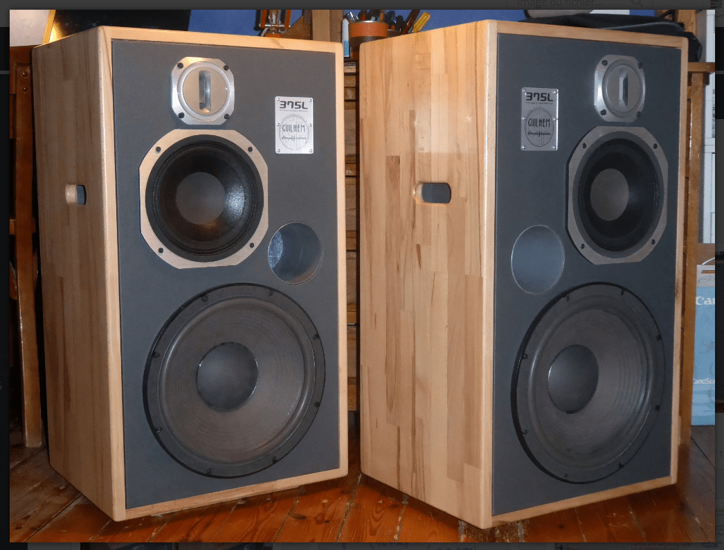

What are the ideal frequency cuts for a 3-way kit?
I think there's no "ideal" per se, but a LFC=300-500Hz and HFC=4500-6000Hz would be a good start, IMHO. But it depends on your speakers...
Personally :
1 - I try to avoid transition FCs that are in a region of the curves of the speakers to match are tormented, particularly for the Woofer and Midrange transition. If doable, at least +/- 1 Oct. of reasonable linearity accross FC is preferable - more is of course better, if possible...
2 - I prefer a low transition FC between the Woofer and the Midrange speakers : 300 - 500Hz rather than 1000Hz. This avoids to cut the voices "in two speakers" : they are plentifully located in the Midrange speaker - notably for the man voices - like if it was a Wide Band loudspeaker. But this implies that your Midrange has a significant size and ability to reach low-midrange / high-bass register...
On my DIY 375L 3-ways speakers below, the Midrange speaker is a 8" one. LFC=400Hz / HFC=5000Hz, while the FS of the midrange is 80Hz, loaded in a sealed enclosure of 7.5L, offering a natural cutoff at 110Hz, that is to say 2 octaves under LFC.
