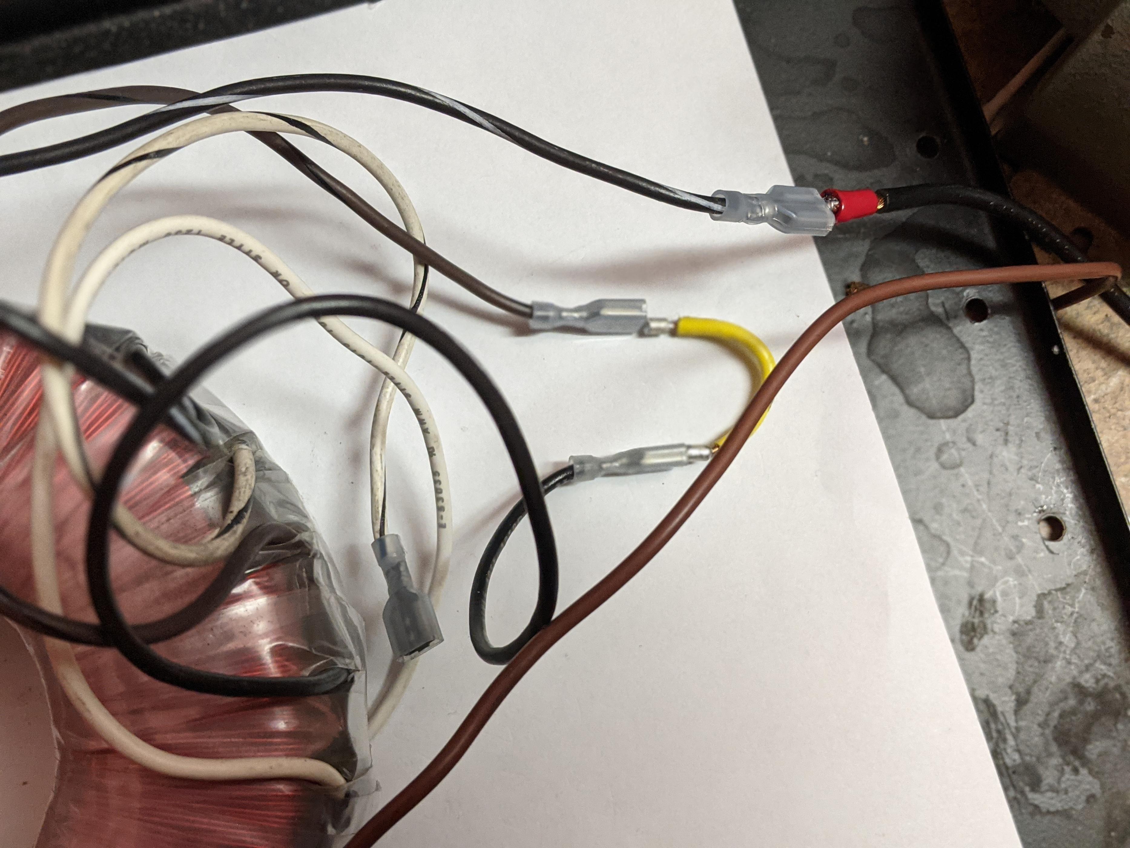

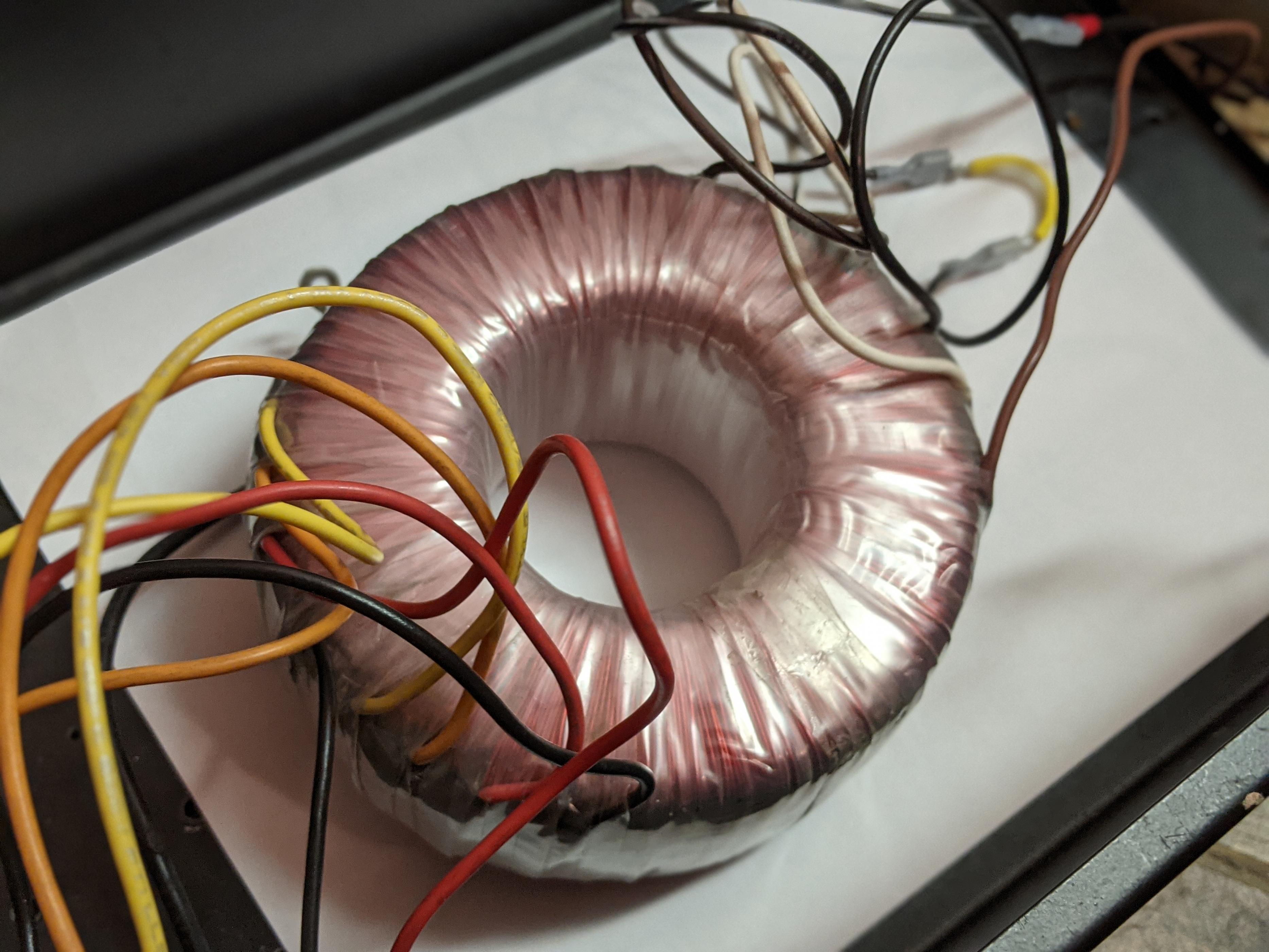

Searching out parts I came across a big toroidal transformer from a surplus site, which was cheap because it had few markings. I bought it on impulse, thinking I might need to rewind secondaries and that they might be fun (at least once). However after checking it out I'm wondering if I might be able to use it without doing anything. I've attached a couple of photos below.
It was sold to me as 1000VA, but I doubt it's as big as that. It weights about 11 or 12 pounds, is 5.5 inches in outside diameter, and about 2.5 inches high, so judging by this and other sites on the internet (like Rod Elliott's ESP site) it is more likely be between 500VA and 800VA. Which is still pretty big.
The side I presume is the primary (black/brown/white) has dual windings, each measures 2.6 ohms across black/brown, 2.2 ohms between black/white, and 0.6 ohms between brown/white. (This doesn't add up, but my meter may not be perfect, of course. Or maybe it's to be expected on a transformer.) The other (presumably secondary) side has four windings, all measuring the same, higher resistance. (Can't remember the value without checking.) Two are red/black, two are yellow/orange.
I tested it with a small AC voltage and then scaled up slowly. It turns out that if I connect the two primaries in series then each secondary gives slightly below 18V, which seems close enough. I used a modest load - can't remember precisely - so there was a reasonable current draw.
The plan is to wire the primaries in sequence, with a CL60 between them, as Nelson shows in his article on several FW amps. 110 V on this side, from the wall. Each of the secondaries would have its own rectifier bridge, and then all four would connect in parallel to a filter. With a little luck a big CLC filter, but that's not really relevant. (Although I note that in a thread of mine from a few years ago AndrewT said when secondaries are "bifillar", whatever that means, you can wire them in parallel to the same rectifier.)
So here are my questions.
1. Is there any reason to think I have it the wrong way round, and this is some sort of transformer to scale low to high voltage? Doesn't seem likely - just thought I ought to check. The "primary" side has the clips shown in one of the photos, if that helps.
2. I doubt I'm proposing to wire the primary side the way it was intended. I don't think this makes any difference, does it? 110V on the primaries in series will produce half the voltage in the secondaries that 220V would, which was presumably the idea. So as long as I don't draw more current than is safe then there should be no problem, right?
3. What would the purpose be for the off-center tap on the primary side? I'm not planning on using it, but I'm curious.
4. Any reason my plan for using this in a stereo FW build wouldn't work? If so, is there any advantage to wiring the secondaries in some other way than what I propose?

it is most likely dual primary xformer, which means primaries in series for 220/230Vac, while in parallel for 110/115Vac
Yes, I think I understand this, although I'm proposing to connect the primaries in series, and apply just 110/115 to them. There are striped black, brown and white, and non-striped black, brown and white. If I connect the striped black to the non-striped black, as shown, and apply input voltage to the two ends, then this seems to work.

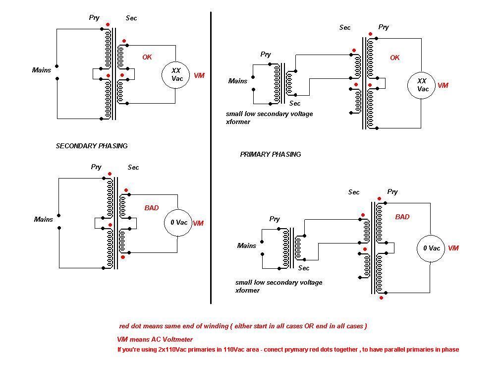

maybe this sketch will help
The left-hand side certainly does, although I'm having a harder time seeing how the right-hand side applies to my situation. It also raises another question; how do you tell what the "same end of the winding" is? If I connect the primaries as I just described, have I done it the way you showed in your left-hand diagram?
The secondaries are a little harder. In your diagram you show them as connected in series, but I'm planning on connecting them in parallel; potentially after the bridges, too. I've attached a diagram that shows the idea.
I am presuming that the two red/black pairs go the same way; that is, either black or red on both should have the red dot from your diagram. But if I have two others that are yellow/orange, then is it yellow or orange that should have the dot to match the red/black pairs? And if I've wired as in the diagram, does it matter?

just go for it
though - you have that flag, while Maine as location
now - you have 18Vac at secondaries, if you wire primaries in series - using which mains voltage - 230 ( UK?) or 115Vac (Maine, USA?)
if latter, when using half mains voltage for xformer, you're getting just half of declared VA, when xformer used on full mains voltage
reason - wire size made for current, so with same allowable current, with half voltage you're getting just half of VA
anyway , if you're in Maine, USA - with some luck, you can feed regular FW jobbie, pulling up to 200VA for two channels, without xformer buzzing and heating
try, why not

Hi ZM,
Thanks!
look at sketch little more - you want to connect xformer ( for good or just to examine proper phasing) so VMeter can measure something, not to show 0Vac
in short - 0Vac on VM means - not good phasing
sketch is made to cover most of often asked questions, so ignore what's not interesting for your understanding
if you're going to deal with paralleling or whatever (with secondaries) after bridges - that's exact way which I can advise , and then secondary phasing is irrelevant, you deal with polarities afer bridges
I would go for dual mono with 4 independent 18Vac secs - using one bridge per secondary, and two of them for one channel, other two for second channel

Yes, I understand. On the other hand it looks large enough to handle what's needed. Also, is current in primary or in the secondary more likely to be the limiting factor? I guess it doesn't matter - it'll either hold up under the (dummy) load when I try it, or it won't...
