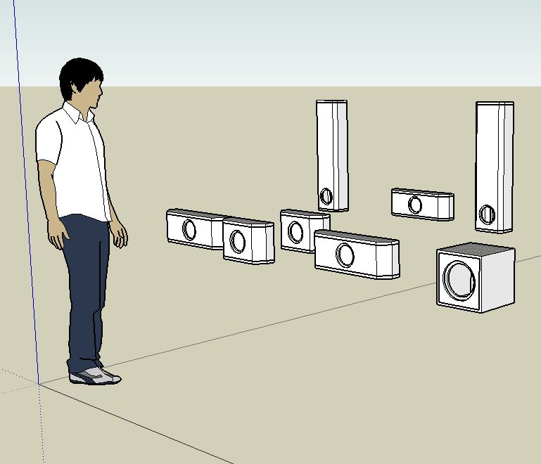

I just put together a wall-mount concept HT built around CHR-70eN.
For on wall mounting you need to deal with the boost that 2pi loading gives & the interference dip from the depth of the box. Widening the box & making it shallow are 2 of the tools for the latter.
dave
dave

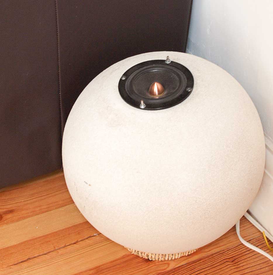

p.s. Another vote of confidence for single-driver HT: I built my HT surrounds using Fostex drivers
[http://www.diyaudio.com/forums/showthread.php?s=&threadid=138195&highlight=] - they are not the cheap option though and I chose a more complex enclosure for the 'fun of it'. A sealed box would likely have worked just as well for this application.
