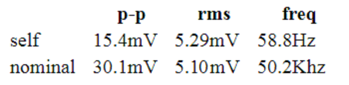

Sorry, should have specified: the measurements were taken at the power supply with the amp on, no input (pre-amp off) and speakers plugged in. As close to nominal use case as possible. Also, Amp was warmed up.
I will check what it looks like at the speaker's early next week.

Ok, the data is pretty simple. Almost no variance between sides, or between inputs (present w/ preamp off, shorted, open), and almost no difference with or without speakers plugged in. I am also including self-noise values for the cheap USB scope (probe attached, but not shorted) for comparison:
attachment.php
My guess is that this is beyond good enough (15mV peak to peak above self-noise, and no RMS difference over self-noise), and that I should put my effort into building speakers rather than building a Power Supply filter. Or saving for a better scope... :rolleyes:
