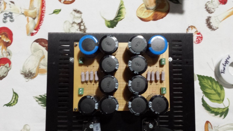

I'm always fond of a standard CRC. About 10mf per ampere and burn a few percent of the voltage in the resistor. If you can get everything at surplus prices, such a linear supply is also cheap.

You want CRC? Most of the normal Firstwatt and Pass amps use this.

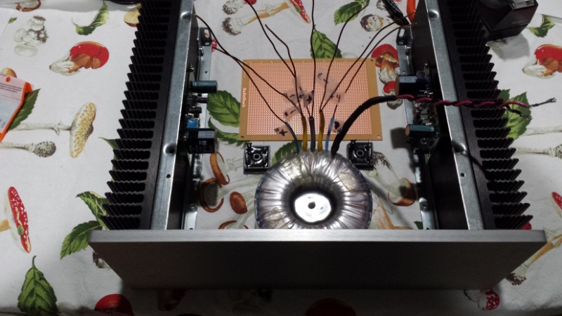

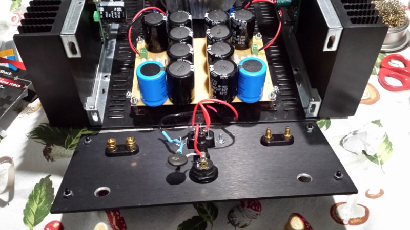

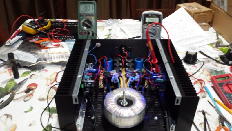

I built the ACA with linear ~19v supply and it sound just great. I can't say enough good things about it.
I have not heard the ACA with a SMPS. I'm sure if you use a well made SMPS, it will sound great too.
ACA illustrated build guide

Some pics.
Great build, looks good! How does the sound quality compare to a integrated/power amps you've had before? Nelson Pass mentions that this amp isn't designed for the best possible sound quality but for easy build. So I'm wondering if I'm better off just buying a cheap power amp like the Topping TP60, Dayton Audio APA150 or something similar.

I have a class D amp and chip amp. Fun for 1 hour, then they get irritating. The ACA is not only an amp for builders that need training wheels, but also an elegant amp that has an interesting output stage and holds its own again anything. I would think a person who likes tube amps would also like the ACA. Very smooth. Somehow has amazing bass.
