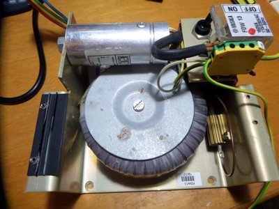

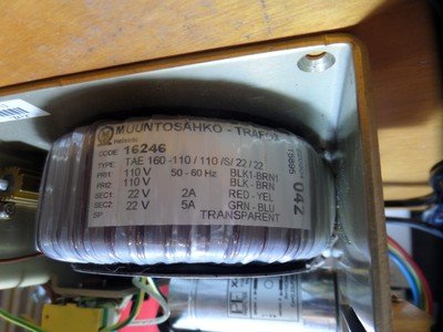

(Probably total overkill but I own it and can't afford any other) A Muuntosahko-Trafox TAE-160. 230v in 2x22v out. (one rated 2amp the other 5amp) 160VA
Seems this Finnish manufacturer makes high spec Transformers for industry and medical.

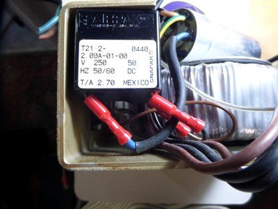

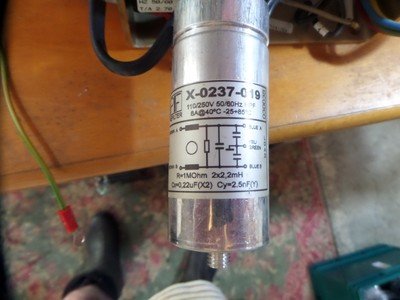

The Transformer and associated parts include a large 'Prefilter" that I am assuming is the industrial version of the noise filter found on many consumer items chassis mount ac input. Yes/No ?
In addition to the input and output wires the transformer has a transparent input wire that is coupled to the ac input cable earth. It is labelled S and SP. What does this connect to/do within the transformer ?.

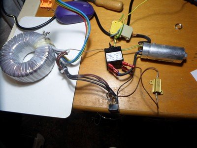

The mains ac cable goes from the Prefilter to the switch. Both P & N are switched with the N going to the transformer but the P going to Power Resistor in series with the transformer. 7.5R @ 25W.
Why ? What does this do ? Can I omit it in my build ?

Can't have a too big transformer...the power resistor is for a soft start it should be shorted when power is up after a short delay. Toroid transformers have very low impedance and pass the short the filter caps are at start up to the line and can pop fuses, etc. Not sure what the s and sp are for, maybe a temp sensor or being medical it might have something to do with isolation sensing.
That was my first thought but there is absolutely no other connections that would facilitate this. All cabling is covered/insulated totally to respective terminals and no evidence of any extra circuits. The resistor appears to be in circuit at all times.
If the S/SP is just one wire, it's likely a static shield that lives between the primary and secondary windings. Its pupose is to reduce noise transfer to the seconday and as you mentioned, it is normally connected to the frame ground.
If it's two wires it could be a thermal fuse or switch used to protect the transformer from overheating.

As for the resisitor, the transformer will work fine without it, and if inrush current is a problem, a better solution is to replace the resistor with an NTC thermistor.

Yes the transparent wire is single so a static shield connection, Never seen one before, though never had a transformer of this quality before.
I guess the S and the SP labels are 'static' and 'static protection' then.
I will remove the current limiting resistor and continue.

Oops... Now that I examine the transformer more seriously I note the primarys are 2 x110v in series so 220v input.
Our mains voltage is 230v +/- 5%. Would the 7.5R 25W resistor in series with the primary be a dropper to shed the 10v overvoltage ? and if so then what consequences, other than a rise in secondary voltage , would occur if removed ? Heating ?
(In years past much of our imported HiFi components were Japan sourced and the voltage selectors only 110 or 220v and worked O.K. though I think the regs have changed since then.)
With the current required by the FE2022, the resistor will do essentially nothing, remove or leave in place as you like.
