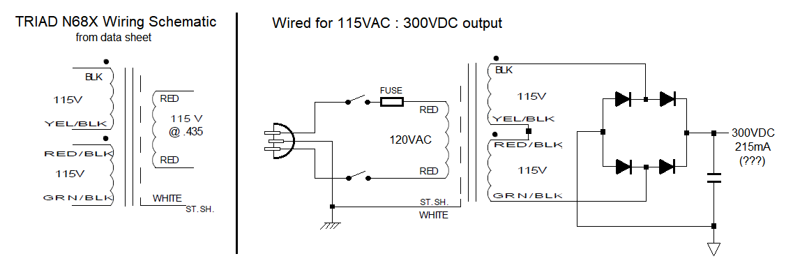

OK, here's another silly idea. I found a Triad N68X isolation transformer lounging around in my junk heap. (datasheet)
It has a dual 115VAC/230VAC primary, and a single 115VAC 0.435A secondary. Rated 50VA.
My silly idea is to use the transformer backwards to get about 230VAC 0.2A from 120VAC 60Hz mains (USA).
I've attached a diagram of how I think that would be wired.
I'd like to use this transformer to provide the DC plate supply for four 6P43P tubes in triode. I figure each will draw about 50mA (250V * 0.05A = 12.5W dissipation).
Do you think I can use this N68X transformer to get about 275VDC @ 200mA? Or is that 50VA transformer simply not up to that much of a load? (I could break down and buy a proper power transformer for this application, but that would mean spending money 😀 ).
Thoughts?

Should do the job. If it can handle 0.435A on the secondary at 115vac it should handle 0.2A on the "primary" at 230vac. You'll get 310VDC or so using a bridge rectifier. Unless it's centre tapped you won't be able to use a regular tube rectifier.

On 2nd thoughts 0.2A @ 275V is 55VA so it's a little borderline but, one way to find out
Good point!
Yes, that is what I didn't consider. I thought there might be something.
Yeah, if there is 300V after rectification (230V*1.3 approx) and I put a 200mA load on that, then that equals 60VA. Now we're 20% over this transfo's 50VA rating.
Answer = Yes it can be done, but it would be borderline, or more likely the transformer will run hot and/or its core might saturate with big bass booms in the program material.

N68X will give you about 200 volts ac under a 30VA load.. I have just ried it last week on a project. (2x15 watt lightbulbs in series)

Most isolation transformers are not exactly 1:1. They are more like 1:1.05. Extra turns are added to the secondary to make up for the losses in the transformer. The exact ratio depends on the size and cost of the transformer.
Wiring it correctly and voltage doubling, you get 2X the (AC peak)
My testing with a N68-X got me about 320 to 330 volts of DC from a backwards N68-X into a full wave bridge made with UF4007's, and 330 to 340 volts when wired in the normal manner with a voltage doubler made with UF4007's. My line voltage runs 123 to 126 volts.
The N68-X will get a good deal hotter when running into a 50 VA DC load than it will when running into a 50 VA pure resistive load. This is due to almost all of the current being drawn in short pulses at the peak of the sine wave on the rectified load VS continuously on the pure resistive load.
I made a little guitar amp that ran a series string 100 mA AC heater (12.5 VA) and 165 volts of B+ at 75 mA (12.4 VA). The N68-X powers this perfectly and gets typically warm after hours of continuous use.
I made a bigger brother for it which ran a similar 100 mA series heater string, but added some tubes so I ran it on the 165 volt DC supply which also powered the output tube screen grids. (16.5 to 20 VA). The amp itself ran on a voltage doubler fed by the same transformer. (330 volts, 75 mA at full crank for about 25 VA, all silicon rectified). The N68-X DID NOT like this, and got quite hot at idle, and too hot to touch after some serious thrashing. That amp now has a 100 VA isolation transformer in it which works fine.

George makes an important point. Because of I2R heating considerations, you can safely access only a tad more than 50% of a winding's VA rating working into a cap. I/P filter. Adding fuel to the fire is the fact that the heating gets worse, as the capacitance increases. The charging pulses do get shorter, but the current in those pulses increases. Square variation divided by linear variation results in an increasing net value. 🙁
"Full wave" voltage doubling the O/P of Triad's N-68X and N-77U is an excellent source of low cost/high quality B+. The N-68X is good for "100" mA. and the N-77U is good for "200" mA.

In the end, it all comes down to common sense and being a bit conservative with your design goals. I like the power transformer to stay only warm to the touch, not scorching.
That seems like a good rule of thumb. I have an N-51X and an N-68X, which I bought for trying with preamp builds. I suppose for this amp I'll get one of those nice Antek toroids. The 250V 100VA toroid costs about the same as an N-77U.
