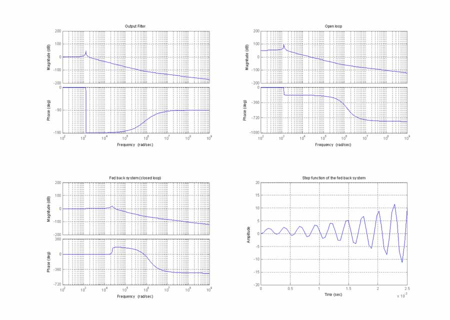

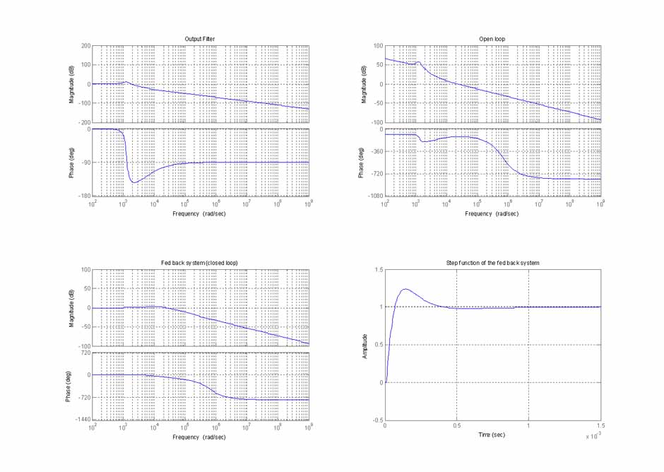

Pafi wrote that a PSU regulator doesn't necessarily contains differentiator zero-pole pair, because of the output capacitor's ESR. I think the ESR is not large enough to provide an achieveable good phase margin at cutoff, because of the modulator's linear phase characteristic, which is inversely proportional to the switching frequency (Fs). So a modulator in a PSU working at Fs=100 kHz switching frequency has -180 degrees phase at Fs. And the zero caused by the ESR is beyond that range (1/(2*pi*Resr*C)). If there is no differentiator zero-pole pair in the regulator, a series resistor could be used with the output capacitor lowering the zero's frequency caused by ESR. But this is not closely belongs to the original issue.
For example, I attached a picture of the control loop characteristics about an Fs=100 kHz working PSU, with Lchoke=100 uH, Cout=6000 uF Yageo LG at the secunder side. The linear phase is approximated with 4-th order pade function. It's easy to see the modulator's linear phase removes the phase margin could be caused by ESR. The regulator utilizes a PD differentiator with fzero=3 kHz, and fpole=200 kHz.
Electrolytic capacitors have a different opinion! 😀 They think they have a pure ohmic impedance at switching freq. Thats why the ESR is so important!

Eg.:2200 uF 35 V elco have an ESR of 44 mohm, so corner freq is 1,6 kHz, not >100 kHz, as you believed! (And this is the low-ESR series!)
Sorry, you are wrong again! PW modulators have insignificant phase shift, because they are "naturally sampled"! (You must have learned something like sampling have a delay, but that's not true! Sampling+hold have a delay assumpted by Ts/2, but sampling itself don't have a shift at all, and in a PWM modulator there is no hold!)
PI-vel nem tudod megcsinálni, mert annak konstans -90 fokos fázisa van
Hát ezt meg ki mondta neked? Mióta nincs valós része az 1/(j*omega)+1 függvénynek?!? Összekevered a tiszta I típusú szabályzóval! Egyébként meg ezeket a "nem tudod megcsinálni" elméleteidet azoknak az áramköreimnek meséld el, amik gond nélkül mûködnek a PI szabályzóval!

So, you are right. I calculated much more faster zero for LG series wrong. I remembered that we learnt about Ts/2 in the "Elektronika 3" subject. But the Fourier series of naturally sampled PWM really doesn't contains it. Maybe we learnt only for overestimate the parasitic delays. For PI I thought about a series P and I, which is really a simple I. Now I simulated the VMC with paralleled P and I regulator and proper ESR value, and it works. Thanks!
You're welcome!
(You still left the "delay" in the simulation. If you removed it, phase margin would be much higher, overshoot would be much smaller.)
Yes, I will estimate the phase delay of the optocoupler, the primary stage, and the rectifier stage and maybe reduce it. But at now there are a lot of EMI problems still in the controller stage. The regulator is unstable at certain pulse widths, and the transformer is chirping when become saturated and current limit occurs. CMC would be better, but I can't measure primary current (at the moment, there is an EMI-coupled current limit sensing 🙂). I should to redesign the whole PCB. But the PI controller works! 🙂 I will send pictures if I will have spare time, but at now I have to learn.
