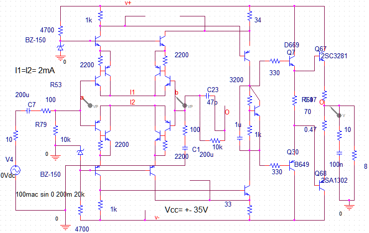

My input stage is a symmetrical cascode diff stage.I use a schematic which you have posted at "hafler mod" etc but i use zener diode instead of 2 resistor
A! I use all 2SC1815/2SA1015
Hi thanh
(sorry for the typo in your name when I respond to post it is sometimes late in the evening after a long day...)
If you use a symetric input stage then you must have also a symetric VAS stage and it is maybe this one or something else that makes the amp to oscillate. Also, have you included the proper essential RC frequency compensation network in the diff stage collector resistors?

thanh said:
Ah! not yet! So how can i do?
See http://www.diyaudio.com/forums/showthread.php?postid=358442#post358442
in attached circuit. R12 + C4, R19 + C5 form the RC network across the collector resistors of the diff input stage. In the refered circuit, R = 220 and C = 1nf when in parallel with collector resistor of 2k2. Of course, this is only typical value that will change depending on the parameters of the circuits forming the amp. The goal is to reduce the gain at high frequency where the phase shift is high.
Or you can also use a miller cap in the following VAS stage.
Good luck
Fab
Hi fab ! this is my current amp . It is too noisy . I added RC network but can't kill it .
Hi jcx ! :) how are you ? :) :) .yes , the unbalance of CFB cause wrong biasing . I added degen resistor ,stopper resistor for cascode . Noise was throw away but amp still ocsilate . I don't want to add compensate cap .So I have just removed CFB .
In the sim input stage with cascode can't increase OL BW and I don't feel the difference of cascode sound in the real world . Perhaps I use 1K collector load at input stage and with 1K OL BW is so wide that I don't need cascode for input stage
