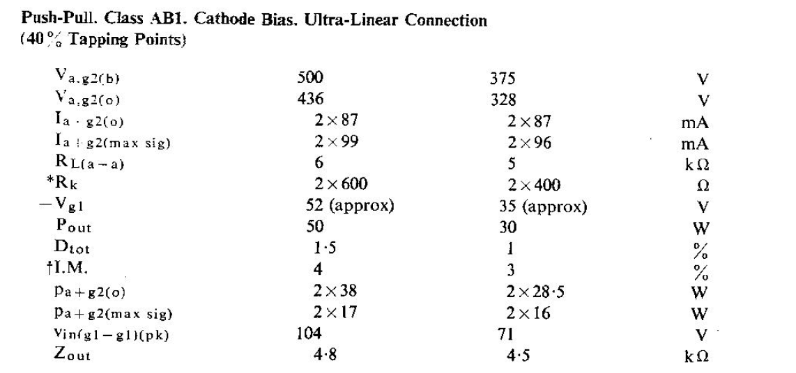

Question, Relation between tube Zout and OPT primary impedance
A basic question if I build an amplifier from bottom up and for example the tube datasheet states K88 Zout (@ 500V) 4.8K and 4.5K (@375V) so is it as simple to match that ?
For the above example if I would have 375 V B+ I would take a OPT with primary impedance around 4.5K ? like 4.3K / 4/8/16 Ohm secondary) assuming the primary current and wattage is ok.
So is it as simple as to match the tube datasheet Zout for a given B+ with primary impedance of the OPT ?
Thx !
Thx Robert ! , so in this case I just take the (for example) 375 Volt , RL(a-a) 5K , so a 5K primary impedance of the OPT would be to aim at ?
Actually just noticed the datasheet lists the example data for Va.g2(b) and not Va ?
Is that the voltage between anode and g2 (screen) so with a 40% UL tap winding the datasheet example means 40% of B+ / Va ?

"Va,g2(b)" is the voltage at the centretap of the OPT. "Va,g2(0)" is the voltage at the anode with no input (music) signal. The difference between these two values is caused by the (assumed) dc-resistance of the primary of the OPT between the centretap and one of the connections for an anode.
Ofcourse the value of Va,g2(0) depends on the actual OPT you are going tu use (the dc-resistances can vary). Don't pay too much attention to this. If the OPT is good enough, than the dc-resistance will not be too high.
If they wanted to be very precise in the datahseet, than they should have given a seperate voltage for the g2 tap. That voltage would be slightly higher than Va,g2(0), but slightly lower than Va,g2(b).
So look at the value for Va,g2(0) as being a practical indication.
Thx Robert, this is really helpful, and if they wanted to be precise should there then not be a graph / curve detailing the RL(a-a) value for a given Va,g2(b) ? , so for a different Va,g2(b) I just lineair make a best "calculated" guess ?
The best way would be to use the last set of curves for 40% ul in the datasheet (page 8 of the datasheet I'm looking at) but to do this for push-pull operation requires quite some insight and labour. I never did that myself; I just followed one of the proposed settings for ul (40%) pp operation in the datasheets.
Edit: I must say that the differences between Va,g2(b) = 500 V (and 375 V) and Va,g2(0) = 436 V (and 328 V) are pretty high (see page 3). With the 500 V it would mean that the dc-resistance of half the winding of the primary is some 735 Ohm. So maybe I'm mistaking over the true meaning of Va,g2(b). But I would not know what it could mean otherwise.

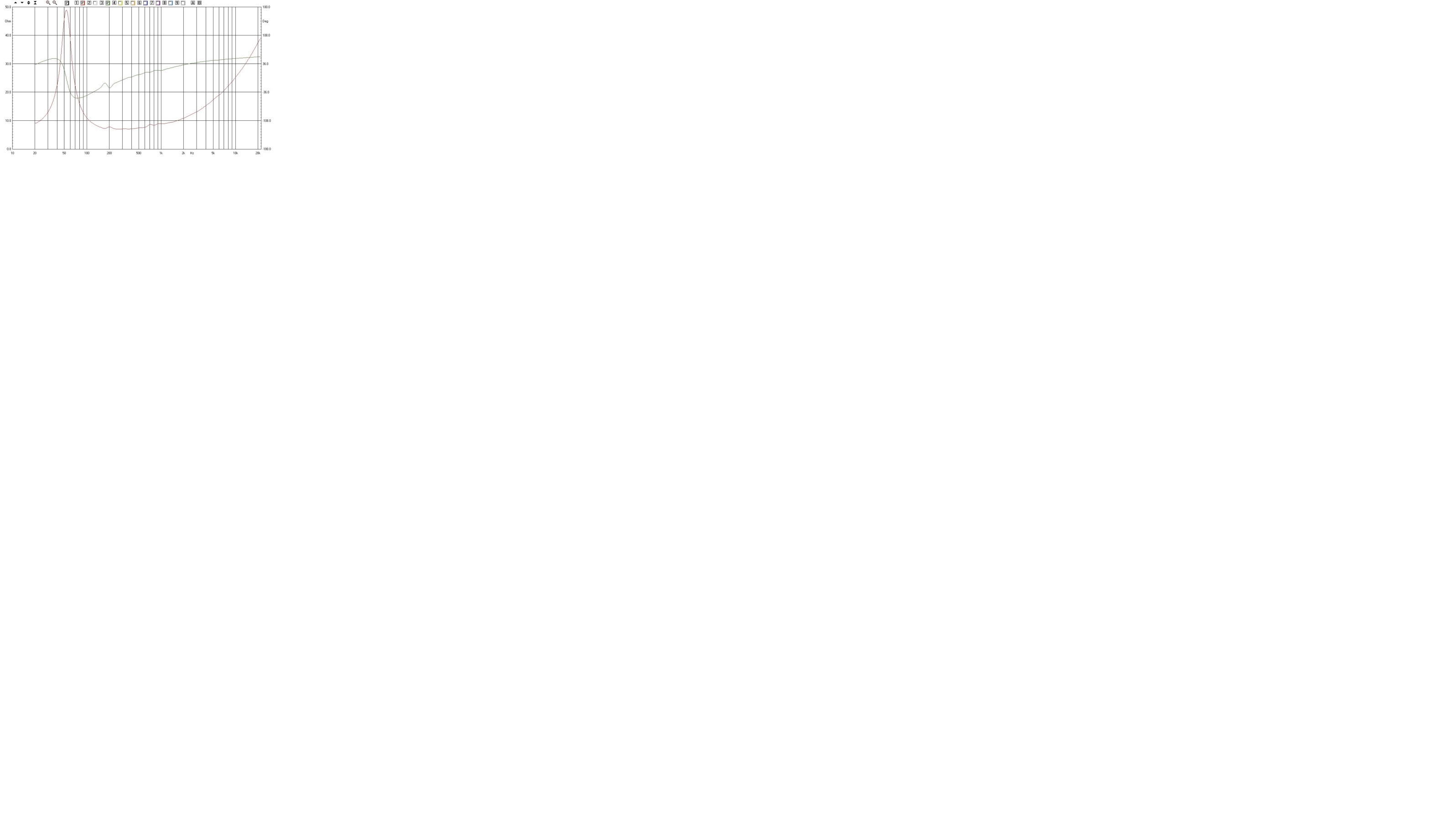

In attach a diagram (from Audioreview site) of the modulus of impedance ( and phase) of a loudspeaker.
In the region where the energy of the sound is important there is a peak where in a little range of frequencies the impedance is changing rapidly.
We start at 10 ohm at 20 Hz, goes at 50 ohm around 55 Hz then fall at less of 10 ohms at 200 Hz.
For the high frequency it tends to increase continously until 20 kHz ( and this a benefit, then I will show why).
If I have a trafo with 20:1 ratio you can understand what will happen to the load line.
In addition you can see at resonance frequency that the fase change immediately ( this means ellipse) from +40° to -40° in the range of 30-80 Hz.
Another consideration.
We can image that at T= 0 there is a signal at 40 Hz and after microsecond ( it is only an example) another signal at 60 Hz, the Z will increas from around 22 ohm to around 48 ohm, more than double. But also phase will change.
Then another signal from 60 Hz to 100 Hz, the Z drop from 48 ohm to 10 ohm
Lot of problems!

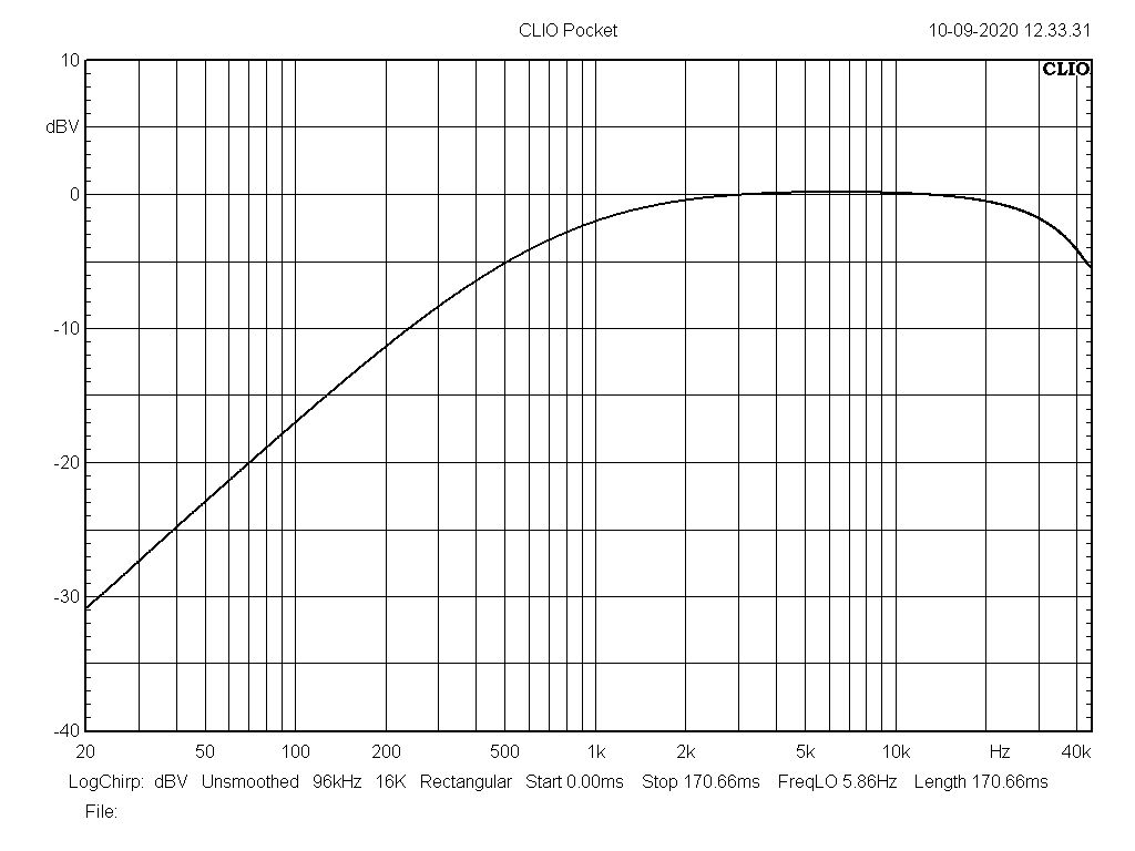

It is a frequency response of a trafo without iron.
Interesting?
We can assume that the iron plays a great rule until, I say, 500 Hz (-1 dB)
But in this range lot of things happen that are heavely respect high frequencies ( under a certin point of view).
