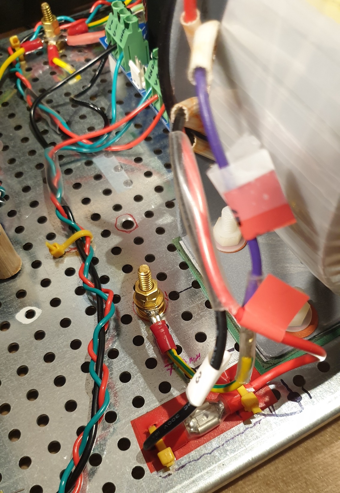

What I have done so far. I very slightly enlarged one of the many holes in the anodised? steel floor of the chassis just next to the toroidal transformer which is mounted vertically. I then sanded the underside of the floor around the hole and inserted a brass bolt 25mm x 4.8mm through a brass washer and inserted it through the floor. I added some star washers and some brass nuts – similar to the diagram below. I then crimped and soldered a ring to the purple transformer shield wire and added it to the post. I then ran a green and yellow striped 17 AWG wire from the green J1 receptacle GND on the Power-86 to the brass post.. Now this is where I have been getting conflicting “advice”. Person A claims that this is all I need to do. But Person B claims that I should not use the brass post at all and that I should discard it and just run the purple transformer shield and the wire from the J1 receptacle GND wire directly to the GND pin on the rear of the fused ON-OFF switch. But when I look at the Design Documentation for the Power-86 at page 18 (for 230/240 V operation) it seems to me that I should be keep what I have done with the brass post and now run say a 17 AWG green and yellow striped wire from the brass post to the GND pin on the rear of the fused ON-OFF switch? See the Screen Grab of page 18 of the Power-86 documentation. Appreciate some advice please.

As a result of the feedback I now have 3 wires running from my brass "grounding post" to:
1. A purple wire from the toroidal transformer (shield),
2. A green & yellow striped 17 AWG wire to the GND port of the green receptacle on the Power-86 J1, Pin 5, and
3. A green & yellow striped 17 AWG wire to the GND pin on the rear of the fused ON-OFF switch.
Now when I place one probe of my digital multi meter (DMM) on the male GND pin at the front of the fused ON-OFF IEC switch and I touch the other probe of my DMM anywhere on the floor of the chassis I get a "tone" indicating a closed loop.
This last "test" seems to me to indicate that the Modulus-86 is now grounded properly?

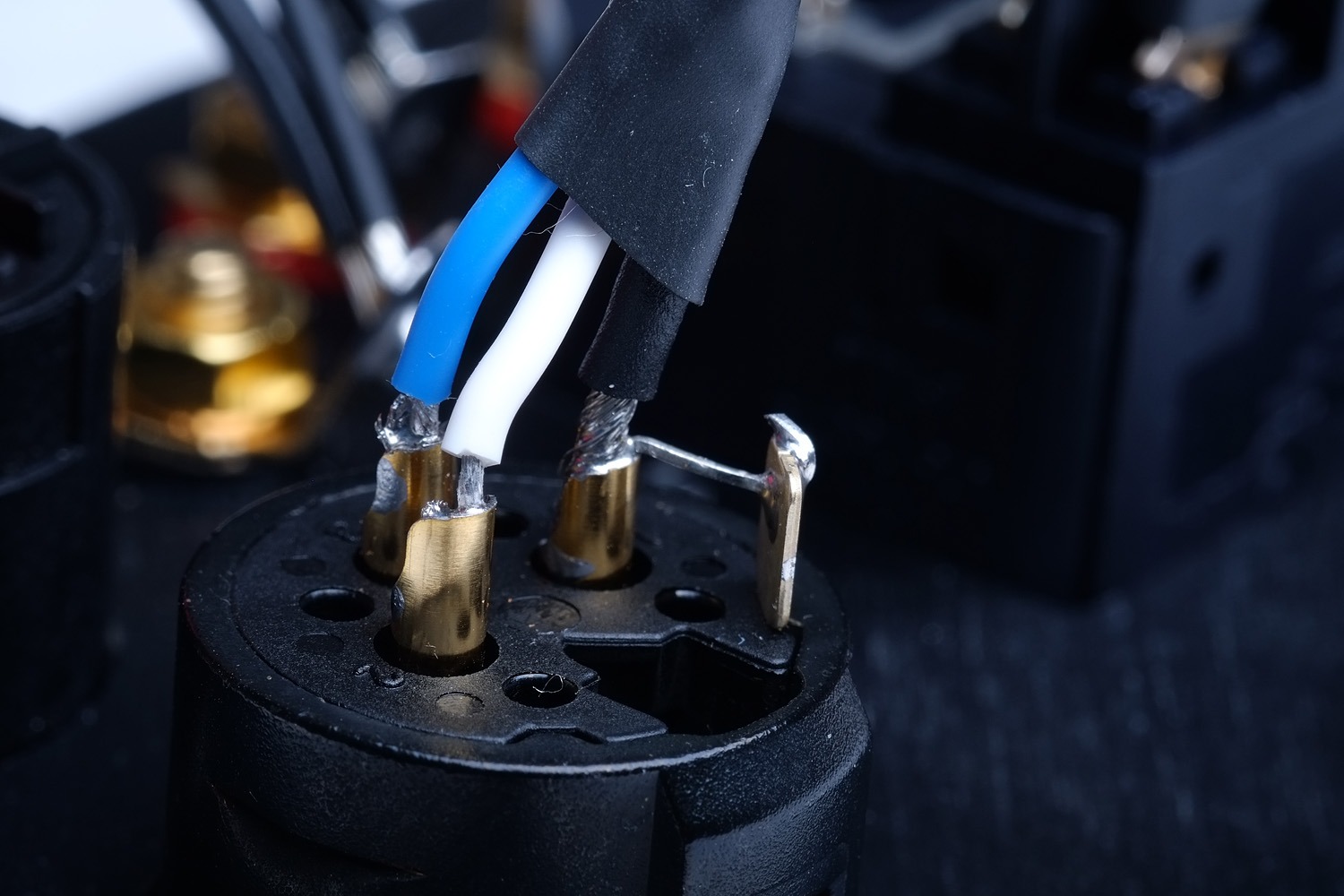

Earthing or grounding the Mod-86

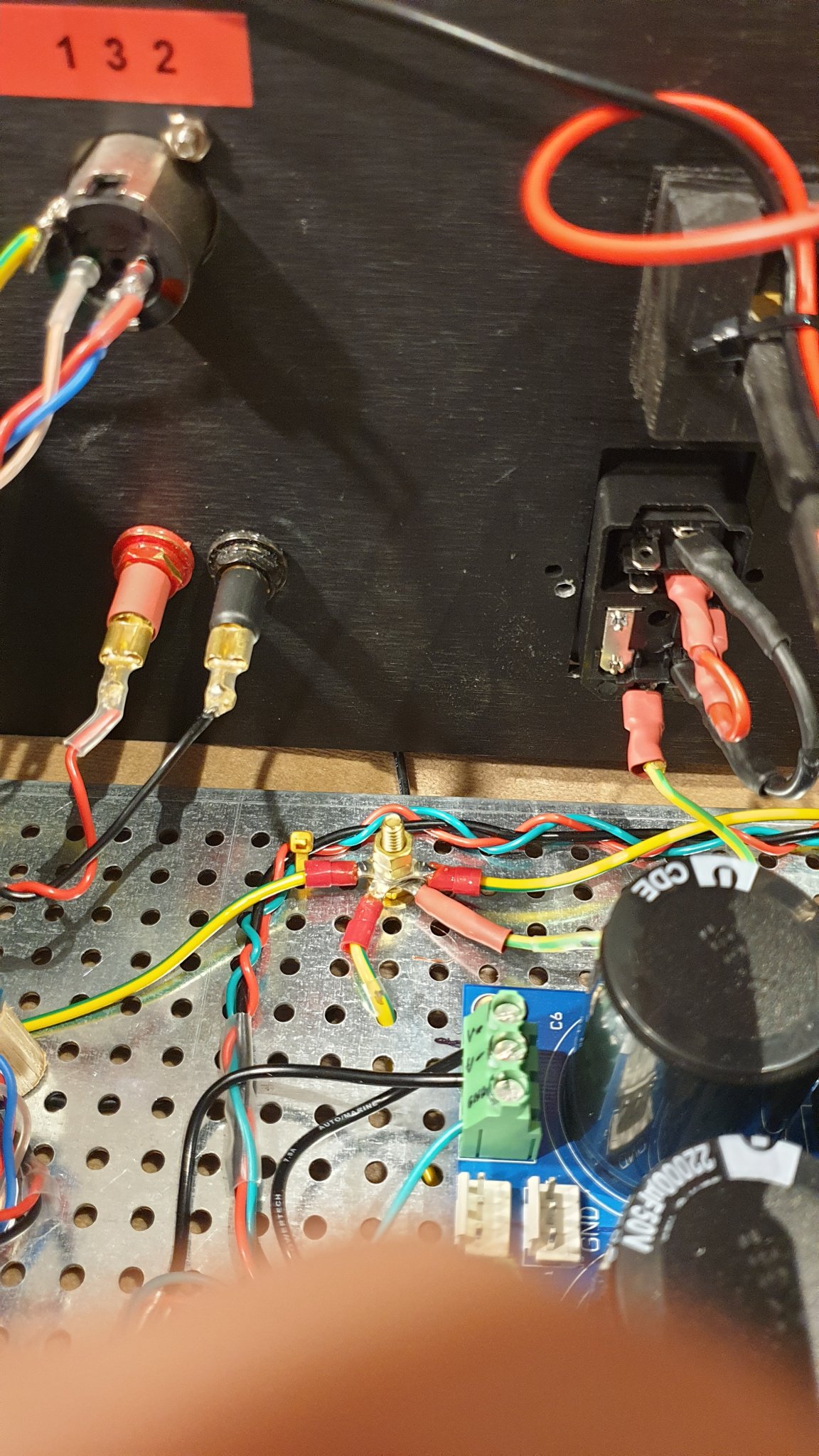

Following the advice I have received I have made numerous changes to the earthing or grounding so I now have 2 brass earth posts (bolts) protruding from the chassis floor.
Bolt # 1 is next to the Antec AS-4218 toroidal transformer (with shield) at the front of the chassis.
Bolt # 2 is about 4 cm away from the rear of the lowest tag on the IEC/Fused/On-Off switch.
- I used a spade crimped, soldered and covered with heat shrink.
B. Another wire runs to the Power-86 board, J1, GND (Pin 5).

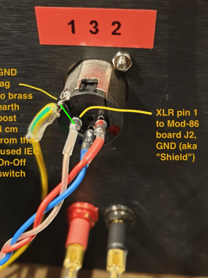

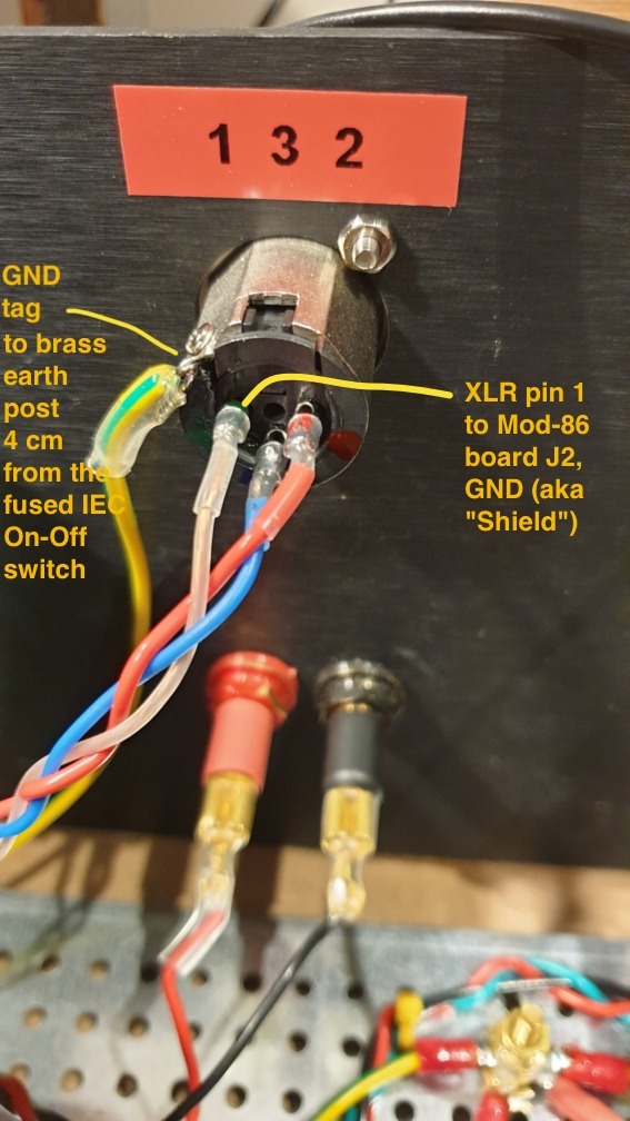

C & D. Two wires run to each of the XLR connectors and these are soldered directly (because I don’t have
any spades small enough!)
- see photo
I have touched one probe of my DMM to the GND post of the IEC/Fused/On-Off switch and then touched the other probe all over the chassis and at J1, GND (Pin 5) and the XLR’s and got 0.5 to 0.6 ohm.
- there are now 4 wires attached to this bolt.
- each wire is 17 AWG Green & Yellow striped.
- at the bolt end each wire has a ring crimped and soldered on.

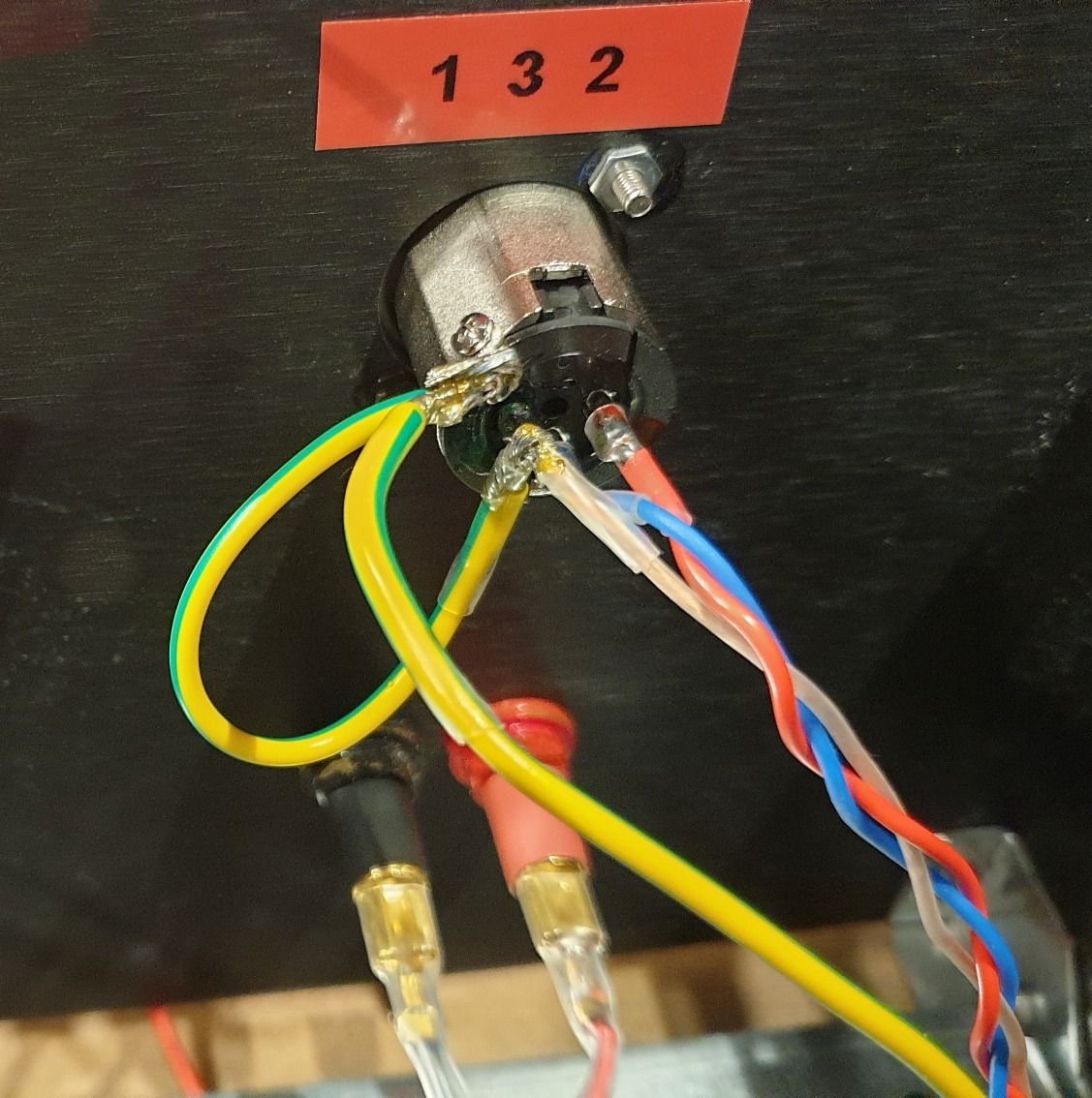

- see photo

Does your XLR connectors not have chassis tabs? Here's what I do:
The mains protective earth and Power-86 ground reference can be on the same bolt.
I think too many take grounding advice as absolutes. The only absolute I'm aware of is that the mains protective earth (PE) MUST connect to the chassis. Even that is only technically a MUST in electrical safety Class I devices, but I doubt most DIYers are able to build to electrical safety Class II where the protective earth can be omitted. So let's just say that the PE MUST connect to chassis.
All metal of the chassis, including metal controls that can be touched by the user should connect together and to the mains PE. That usually happens when you assemble the chassis, but it never hurts to double-check with an ohmmeter.
The Power-86 should connect to the chassis if you use RCA inputs. If you use XLR inputs the audio ground is referenced to the chassis through the connection at the XLR connector. It really doesn't matter how long the wire from the Power-86 to the chassis is, so you can use the same grounding point as the mains PE.
If the power transformer has an electrostatic shield it should (should, not MUST) connect to the chassis. You can leave it floating if you want. Then you just don't get the benefit of the shield. Ideally, the connection to the chassis should be short, so I would recommend using a separate grounding point for this. Again, that's a "should" not a "MUST".
This is the exact same advice I gave in Post #8. I'm a bit surprised that there's still confusion on this.

Thanks for your reply which is as always very much appreciated. I am using XLR sockets rather than RCA sockets on the back panel of the chassis after reading page 7 of the Mod-86 Rev 3.0 Design Documentation. See photo. As far as I can see I have gone as far as I can on earthing/grounding everything.

You do want pin 1 of the XLR connected to the chassis. That's why it's shown with a filled solder dot in the design doc. The figure below is from page 32 (with annotation added).
You can keep the yellow/green wire if you wish but that tab is already connected to the chassis through the connector body. You do want to make the connection from XLR pin 1 to the chassis tab. XLR pin 1 also needs to connect to pin 1 of the input connector on the MOD86. I've shown the necessary connection in green in the image below.

1. XLR Pin 1 grounding
In “a month of Sundays” I would never have picked up that the small solid dot on the XLR wiring diagram had a different meaning than a small hollow dot, but now I do. Steep learning curve. I have soldered a short Green & Yellow striped 17 AWG wire between the XLR ground tag and the XLR Pin 1. See photo prior to applying heat shrink. I am not sure how to test that my soldering has been effective but I have tried 2 methods. Method 1 was to place one multi meter probe in the XLR socket Pin1 (ie. from the outside of the chassis) and with the other probe to touch A - the XLR metal body (ie. inside the chassis), B - the brass grounding bolt, C - the Mod-86 board J2 GND and D – the chassis; all measure about 1.0 ohm. Method 2 was to attach one multi meter probe to the male GND post of the IEC and then repeat A, B, C & D above; they all measured about 1.3 ohm.
