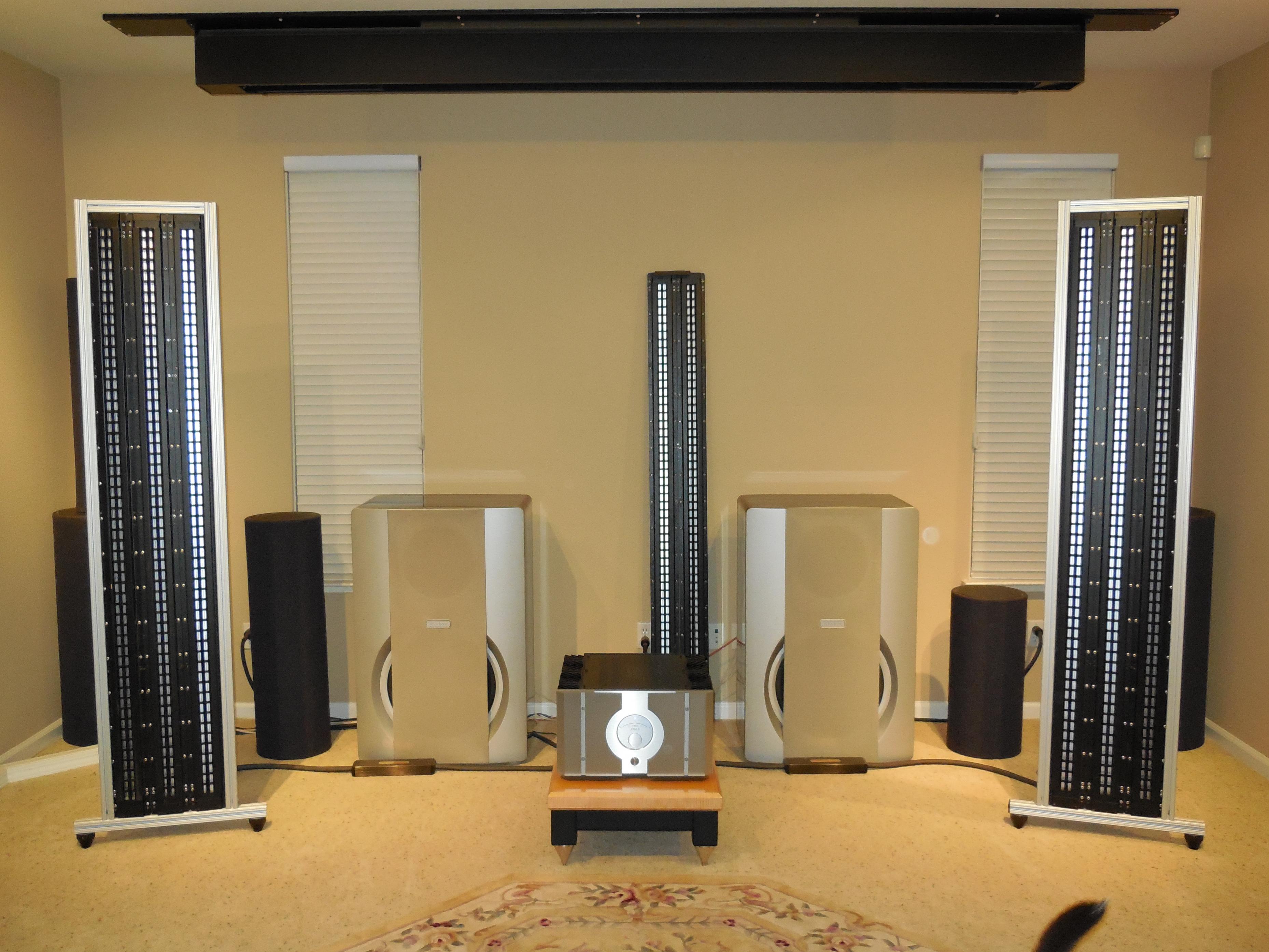

Multiple RD75 drivers
I am currently playing with the same idea (See pic) for the same reason (more SPL's) After a lot of testing, 3 RD75's at 1 degree delta creates a wonderful sound stage without lobing. Any more and impedance gets interesting. I am struggling with mid-base matching with 2 Velodyne Sig 1812. My theory was having many RD75's, I could lower my XO to 125ish without stressing the ribbons. I have 6" wide airfoil baffles that I am going to tune to hopefully get more mid-base from reducing back-wave cancellation. Any comments are welcome, as I am a novice at building speakers. I am after better performance than my Genesis 201's had and the airiness of my old Infinity BETAS.
