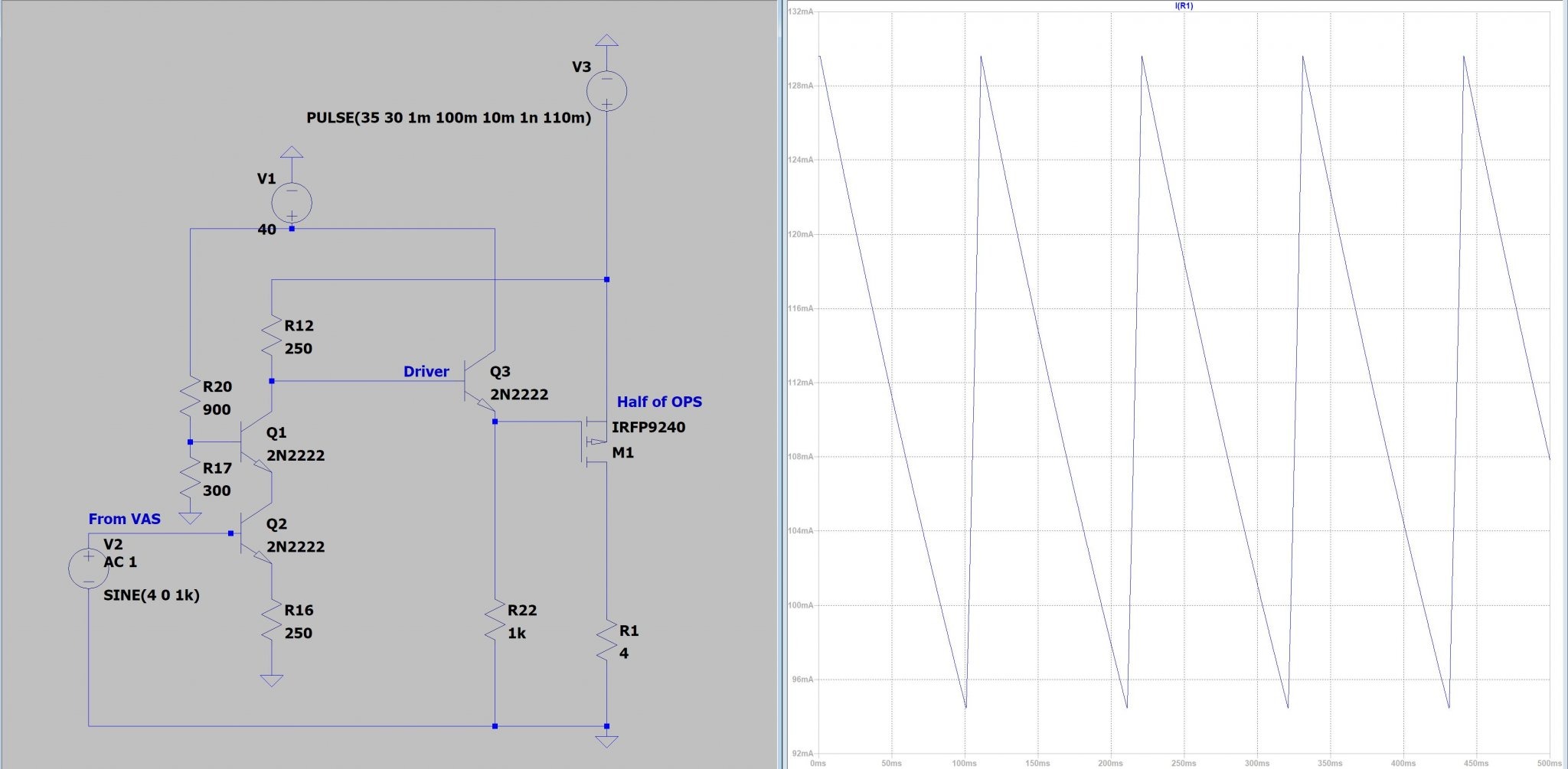

Thanks for the hints! As far as I see, the trick is to drive the fet from a bjt collector with a resistor to the Mosfet supply. This kinda works as a controlled current soure and keeps the Voltage Drop across the Resistor and thus the Mosfet Vgs somewhat constant.
I tried to make up a circuit that incorporates that an came up with this:
To keep it simple its only the upper Half and the VAS is missing. Q1/2 are the mentioned controlled current source. Q2 is cascoded with Q1 to increase its supression of changing Voltages. It reduces the Bias modulation to a 30 somewhat mA range. While not perfect it at least does not selfdestruct directly.
Did I get the idea right or is there a better way of doing this?

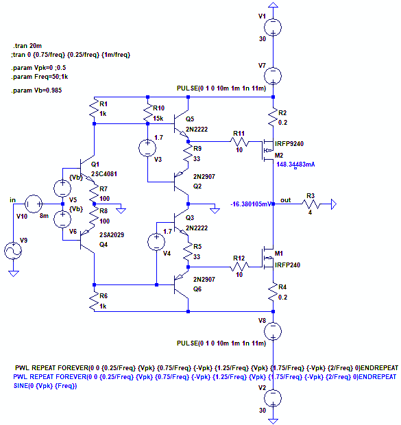

Hi 3eepoint,
Here's what I'd do for common source to your original basic idea

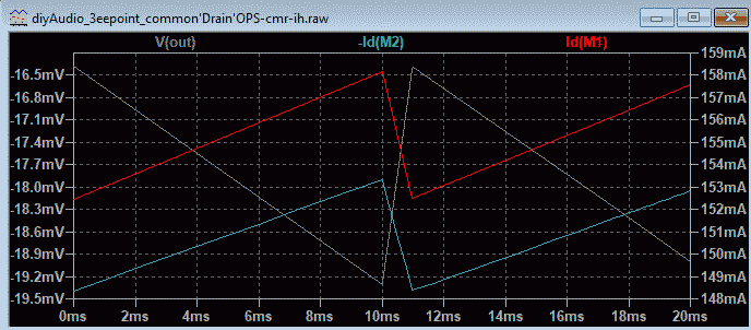

The drivers are made push-pull. Rail ripple is shown below (3mV in Vout and 4mA in drain currents):
The level shifters are Q1 and Q4. The bias voltages (V5,V6) need to be linked to Q1 and Q4. Bias voltages V3 and V4 are not critical for biasing of the MOSFETs.
R10 is optional to trim the gm difference between the p and n-MOSFETs.
With IRFP MOSFETs you need thermal compensation of the idle current. It cannot be done using the level shift bias spreader because of the voltage gain (x10) of this stage giving a way too large temp.co. One option is to add a thermistor across R1 and another across R6 and placed on the MOSFET drain leg. The thermistor value is chosen to give the right compensation - the value depends on the mounting and heatsink arrangement.
