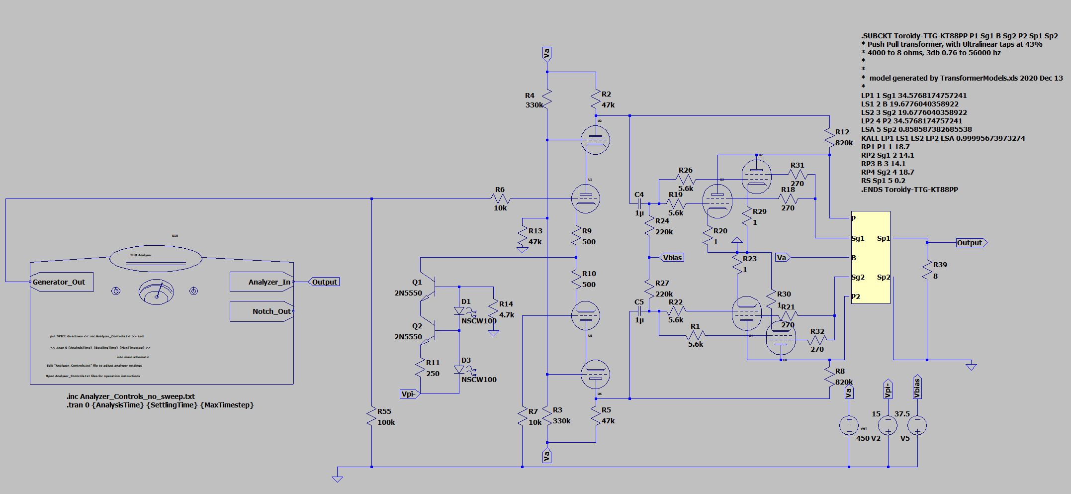

So, this is what I meant:
Local feedback on the cascoded PI, local feedback on the EL34, 43%UL connection, fixed bias.
B+ at 450V, 4k Raa for a quad of EL34 per channel (8k Raa per pair) using the cheap OPT Toroidy TTG-KT88PP ( TTG-KT88PP - Tube output transformer [4kOhm] 2xKT88 / 2x300B Push-pull or similar - Shop Toroidy.pl ).
This is what I get at 40 Wrms:

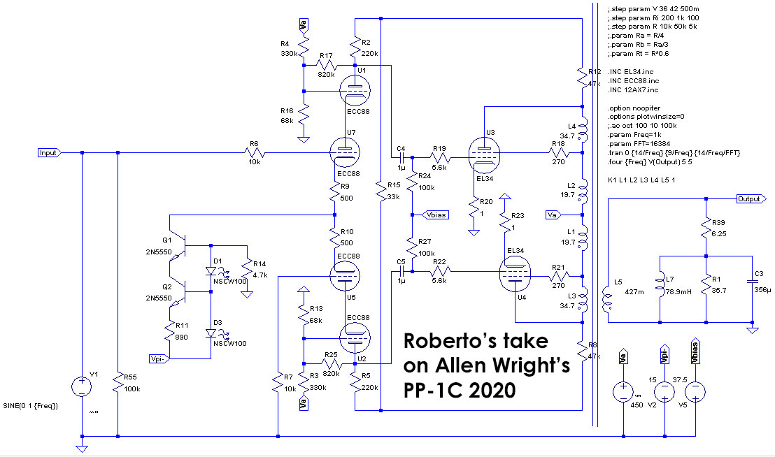

Hi Zintolo,
I took your model, added the second pair of EL34, adjusted the transformer to 4k and used a much smaller time step to increase accuracy for THD analysis. Distortion at 40W is more like 0.4%, not 0.03%. Some observations:
-220k anode resistors driving 100k grid resistors doesn't really make sense
-You are running the ECC88s at very low current and missing out on the gm and reduced distortion available at higher currents
-The cascode output impedance is very high, and so there is significant drop in response at higher frequencies due to the output stage input capacitance
-The "Baby Huey" style of Schade feedback results in relatively high distortion, especially at higher outputs
-I don't think the anode to grid feedback in the top ECC88 is doing much except reducing gain, perhaps helping a bit with output impedance
- The simulation indicates significantly better results by increasing total LTP current to about 8 mA, dropping the anode resistor value a lot to end up with with ~230V on the top anode, and connect it to B+, increasing output stage grid resistors as much as you can within the allowable limits, and adding a touch of normal Schade feedback with a large value resistor from the output stage anodes back to the cascode anodes. See attached schematic - sorry I can't paste the .asc file because it only works with my custom setup.

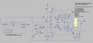

Distortion results below. I adjusted my modified design to have the same overall gain as your original. At the 75W level my design is showing a third harmonic null at the expense of increased higher harmonics, which I don't like, but this is very loud!

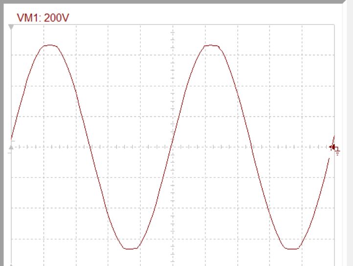

How do you calculate your output power. For me 24Vp on 6ohms is 48W, how do you find 75W?
With 12.45Vp on 6.25 ohm is 12.4w, how 40w?

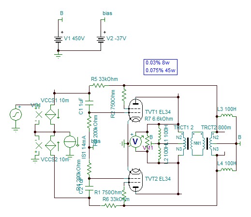

Max swing I get is 830Vp on 6.6k Ra-a this makes 52W. The Rg2 270 ohms looks too low, datasheets advise 1k where the distortion at low levels halves. The best I could get from the output stage alone is 45W with 0.075% and 0.03% at 8w.
attachment.php
Thanks kokoriantz,
Please note that 4k Raa is for a quartet of EL34, not a pair.
Looking at the images you posted, best result you have got is with 450V B+, 35% UL, 33k on 200k anode to grid feedback, 6k6 Raa (3k3 per quartet) with 750 Ohm screen stoppers.
830Vpp means you reach 35 V at 250 mA. Are those THD numbers still valid with grid stoppers in? They are very impressive.
