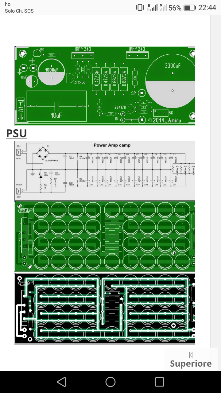

surfing the net I found this Power supply that is in the picture I attached, what do you think?

I don't recommend either the amp board or the PSU board that you show. Neither have any advantage, and they both have problems. The amp board is missing R15, which is used to improve performance. The PSU board makes a common assumption that a lot of small capacitors is better than a few large capacitors, which is not true. It just makes a lot of work to solder all the small caps. This PSU board also uses small traces, and a non-optimal routing for what should be a star ground connection.
You should learn to walk before you start to run. I recommend that you buy the ACA kit from the diyAudio store and use the 24V SMPS PSU that comes with it.

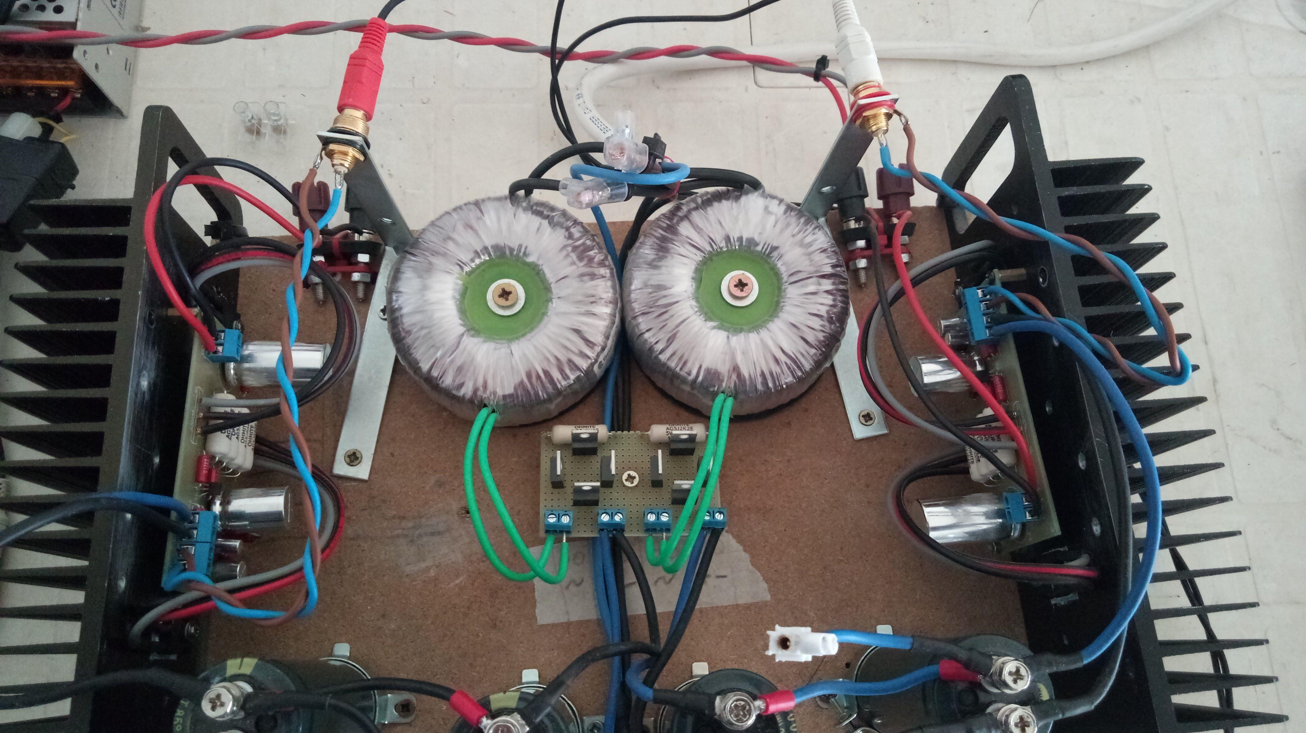

currently my aca is this attachment in photos.
Two Samwha 22000uf per channel, mur820 diodes and a 2K2 Ohmite short-circuit resistor. I'm quite happy with the performance and sound quality.
My question is if by chance there is a Power supply different from mine that can still improve, because the aca deserves it.
Do you think mine could already be a good Power supply, or do you think I have to try some other configuration ??

Now that I have seen the picture of your amp, I would agree with 6L6. You are already on the right track with your power supply. There is nothing wrong with a point-to-point wired PSU, which is what you have. Mounting the big filter capacitors onto a PCB can be convenient, but is not always an improvement to the quality of the voltage supplied to your amp.
The biggest improvement you can make to your amp is to build a proper metal chassis for it. The ACA is a good enough amp that it deserves a good chassis. This will make your amp safer by hiding the high voltage wires and connections, and it may also improve the sound by shielding the circuit from outside electrical interference. When you are routing the wires from the PSU caps to the ACA boards, keep them close together, and away from the input wires from the RCA connectors.
The next thing you could try is making the Vdd (positive) connection between the two big caps with two 0.22 Ohm, 3 Watt resistors in parallel. This will give a small 0.11 Ohm connection between the caps and will filter some more of the switching noise from the rectifier diodes.
Try those things (complete metal chassis and filter resistors), and if the amp sounds good to you, congratulations! You are done.

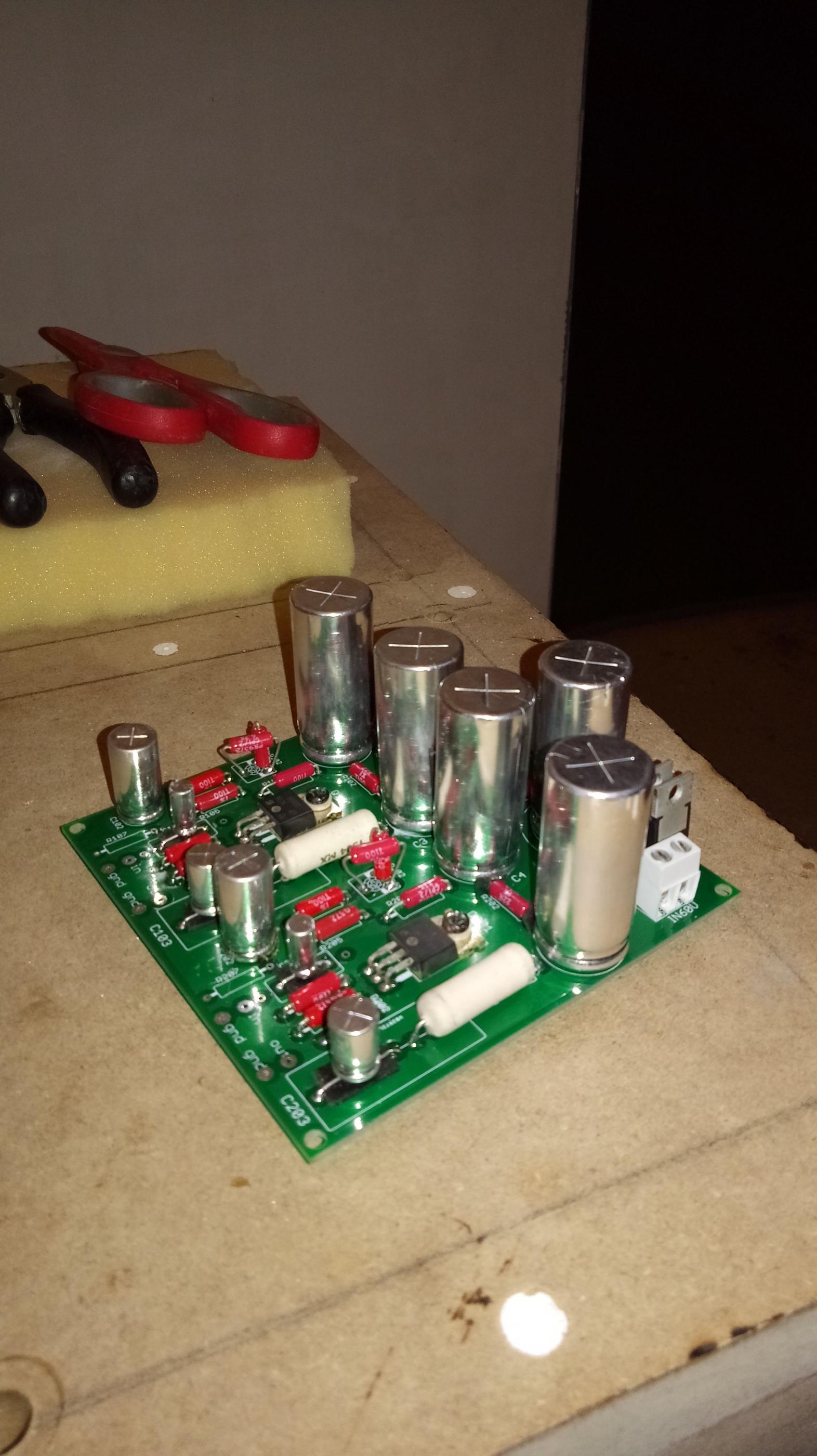

this is my boz ..
both in the boz and in the aca I removed the voltage regulation trimmer.
After setting the voltage correctly, I removed the trimmers, I measured the values and replaced them with fixed resistors of the PRP type, the quality improvement was remarkable, the trimmers constitute a dangerous bottleneck, damaging the sound much of more than a poor capacitor.

Unfortunately, two schottky diodes were burnt on the boz.
It happened about 15 days ago, and after replacing the diodes this morning it happened again, after about 10 days of perfect operation.
I ask you why this happened. Perhaps it may be that the schottky diodes are "weak" in the ignition pulse to charge the capacitors ??
But anyway there is a 1000uf capacitor immediately after the diodes, and then 4 1000uf capacitors after the stabilized voltage at 60V. So there is not a big capacity !!
But there is no short circuit in the PCB, so the only reason I think is that the schottky diodes are very weak at the impulse, what do you think?
(my schottky diodes are 2A / 600V)
