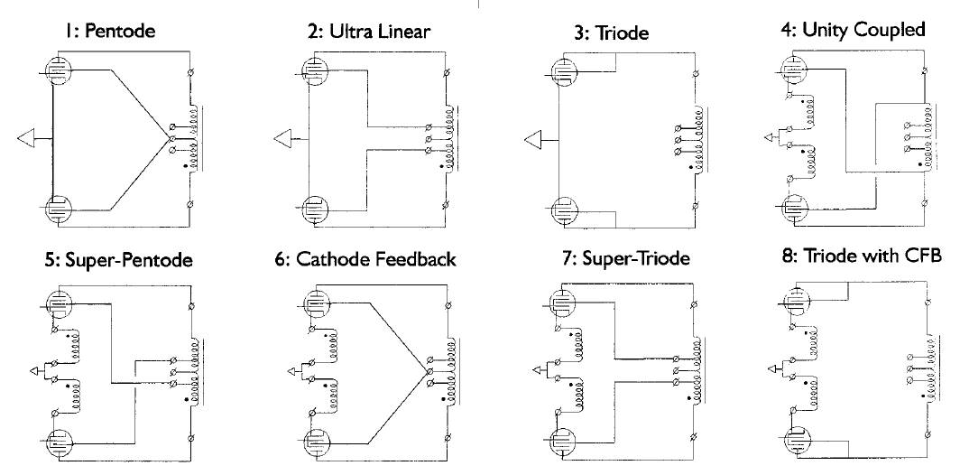

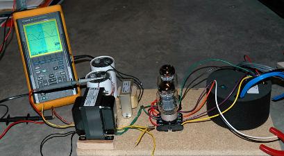

Here's my KT88 push-pull output stage "breadboard" with Plitron CFB specialist OPT.
Power transformer is Hammond 270HX through diodes and pi filter with two electrolytics and a Hammond choke for 400VDC.
I'm driving the grids with a Lundahl interstage transformer as a phase-splitter.
How does it sound? Don't know yet. I'm lucky to have the time to get it working, not even doing critical listening!
Plitron has some fascinating configurations using their push-pull specialist transformers. My KT88 amp will be switchable between 5,7, and 8. Configurations 7 and 8 are traditional. I'm wondering how 5 will sound.
The UL feedback has to take into account the tube's g2/g1 Mu factor. So a pentode with a g2/g1 Mu of 10 say, would need 43% UL to equal 4.3% CFB. Combining both (using a fixed screen supply) with X% CFB would then also have X% UL but only X%/Mu additional effect in equivalent terms to the CFB (so X% + X%/Mu eff. CFB). (X being in terms of a fraction of total primary winding turns, C + P, for all cases here)
The argument is sound but .... way I look at it is that classic UL alters the tube's internal characteristics since it is inherent in the output topology; this is evident from graphs. Applying 'overall' NFB via g1 occurs 'outside' the tube, linearising whatever occurred inside. I have not fully investigated this, but a difference does show between the one and the other manner, using 'equal' degrees of NFB. Feedback via g1 (only) does not change the inherent pentode characteristics, only linearity. E.g. maximum available output remains the same before G1 current starts, but not in UL. But this becomes a little academic; not to confuse Kashmire.
Kashmire,
Interesting experiment ahead for you. You realise that not all comparisons would be 'apples to apples'; in some of those configurations you would be exchanging quality for maximum output, always a difficult choice. But I look forward to your findings!
