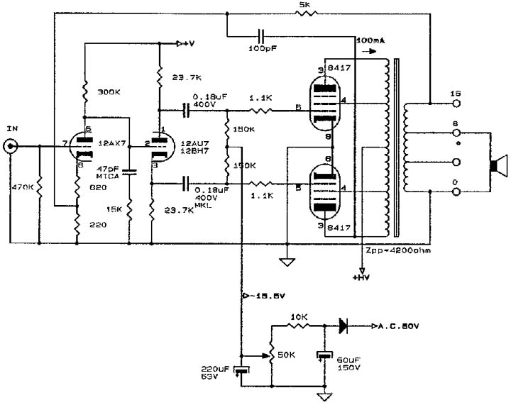

On my garage Quicksilvers I measured the voltage on pin 3 at about 475 and pin 4 at 475. I was under the impression that it was supposed to be 43% on pin 4. Am I just not understanding this correctly or is there a problem with them? Its a converted 8417 running KT88's.
The 43% for UL taps refers to the screen tap being at 43% of each side of the primary winding from the center, or B+, point. If you think of each half of the primary winding as 100% from the center (B+) point to the plate connection, the screen connection is 43% of the way to the plate connection. The is makes for a voltage differential between the plate and the screen in AC terms. For DC, all that counts is the DC resistance of half of the primary and there is a little less resistance from the screen tap to B+ than to the plate connection. Usually, the screen is just a little bit higher in DC voltage than the plate but it sounds like your transformer has a fairly low impedance primary and/or is wound with fairly large wire. This could give the same voltage reading on both pins. Hope this helps.

What he said. UL is hard on screens and it is common to have a 1k resistor between the screen and the 43% tap, to drop the voltage a little. It also helps to suppress parasitics if soldered ver close to the screen pin.

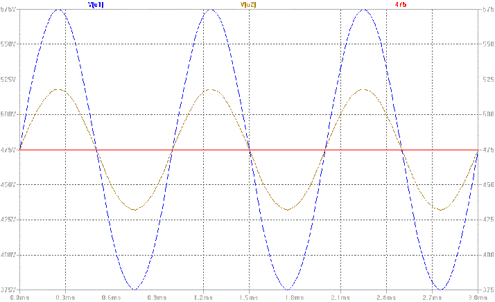

Can I have a diagram with voltages?
Is this what you mean ? The red line is the 475 volts dc you measure on plate and on screen. The blue is the total voltage on the plate, consisting of 475 dc plus 100 peak volts ac. The orange is the total voltage on the screen consisting of 475 dc plus 43 peak volts ac. 43 is 43% of 100.

Thanks for the diagram. It makes things clearer.
