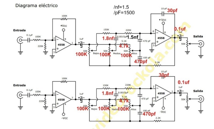

Im still pulling my hairs out trying to get some boards I purchased to give a clean signal out. Last night I had this thought maybe its in my approach.
Im feeding a signal say 1V 1Khz into the input and tracking it thru the circuit.
So far only one board has given me a clean output signal.

A schematic would help.
What sort of circuit is it? Preamp? Phono Preamp? How much gain? Which opamps? Are you getting noise or oscillations? What is the level of noise/osc?
Opamps have fairly high PSRR so unless you are running very gain, a noisy supply should not feed through to the output, unless the supply is horribly noise to begin with.
Opamps oscillate when the output phase shifts 180° and finds a path back to the non-inverting input. Opamps with very high GBW products can exhibit this at a frequency before the open loop gain drops below unity. If you are using them as unity gain buffers, make sure to use opamps that are unity gain stable.
Put a load on the output that the circuit is designed to operate with (not a speaker, not even a small one). Most line level stages are designed to work into 20K or higher. If the load has excess capacitance or long cable length, you may need a series resistance between the opamp output and the load.
Run the circuit on batteries to eliminate the supply as a source of noise.
But radiated interference can still be picked up. A load is not usually necessary.
Keep the good circuit as a reference and compare the others to it.
Since you know that this design can work, look for bad connections, wrong or bad parts, etc.
Unless you are highly experienced, such problems are par for the course.

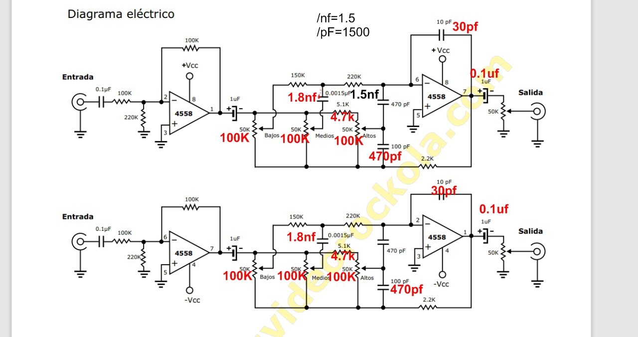

Here are the circuits.
  • bluejay with mid.pdf
Quantifying Noisy is you send in a clean 1Khz signal. And on the output you dont get a clean wave form. Its either much thicker wave form a kind of ringing. Or a distorted wave form. i.e. its not a clean sine wave you see on the output.

There is, it's just that preamps and active filters/EQs are normally not sensitive to the load. Peramps shouldn't be at all, and EQs/tone controls shouldn't be either as usually the last filter stage serves also as a buffer... unless it's some special tone control, like ones meant for guitars, which are passive... but otherwise, you should be able to measure them without being loaded... the only way they are sensitive to load is when you overload them (like if you'd short them to 0V "ground" through 4ohm resistor... but you don't need to measure them that way, as that's not the way you are going to be using them... they are supposed to be connected to some high impedance inputs.
Also, if you'd want to load them anyway, then 10K sounds more reasonable than 1K... 1K is bit too low / may be annoying for some opamps in some configurations.

Something like a preamp, tone control should work fine without a load. It would not harm unless you go too low. So lets say something like 4.7k as a nice compromise. If your circuit has trouble with that, then it has a design problem.
But having an input "load" would be a good idea. If you leave the input open, then anything that is picked up is also sent through the circuit and comes out the other side. So a resistor at the input of something like 1k is a good idea. Keep that resistor as short as possible, no alligator clip leads.
Then there is the point of hooking up a scope. How and where are you hooking it up? If you are using a long ground lead at the other side of the board then you are picking up noise that isn't really in your circuit. You should use a ground lead as short as possible.
Oscillations are most likely a result of the circuit itself (too much loop gain) or the layout of the pcb or wiring and not the PSU. Noise can be a result of the PSU but with modern components it should not be the case. Batteries can help checking that but even batteries have noise (but likely much less than a switched mode PSU).
