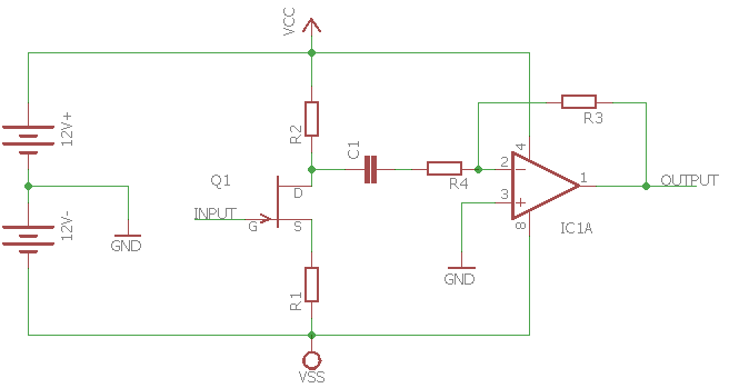

Been working on various experiments with different kind of amplifiers and hybrids and whatnot and ive come to wonder how to use planes properly
Ive included a rough simplified sketch of a example circuit. There is a class-A jfet amplifier and a inverting opamp. My question is how would i use planes on a 2-sided PCB with this?? With the jfet i would go for using a plane for the -12v, but for the opamp i would use the GND as a plane hence my dillema:
Do i:
  • Choose either the GND or -12v for the entire pcb?
  • Give both -12 and 12v planes and use traces for GND?
  • Section the parts on the pcb with each part having it's own plane?
  • Not use any planes at all?
  • Just use whatever is convenient, it doesn't matter cause AF?
  • Something else?
Any insight,advice or resources to read would be appreciated. When i start to transfer one of my projects to PCB i want to do it right.

It's best if you post the complete circuit, including how the input and output are connected.
There also must be decoupling capacitors.
The most important thing is the power rails.
Is it really two 12volt batteries or are you going to use a transformer, rectifier and smoothing caps ?
The charging impulses to the smoothing capacitors can really upset the audio ground.
The input (rectified ac and zero volt line) to the smoothing capacitors should come from rectifier and the other side should go out to audio circuit.
I got caught out with a mixer with that, just laid it out any old way and got 1VAC of hum on output with input shorted !

It's really is mostly like the example. A simple class-a input amplifier stage with possibly high impedances and a opamp handling line output. Yes there is naturally decoupling between the stages and the input/output.
Just want to know what i should consider in general. How i should use planes and whatnot in audio where you got different parts that use a different reference. not looking for a circuit specific solution, Just looking for overall information so i can learn. 🙂
I own a book on EMC as part of electrical engineering study so i know how to be carefull on layout and avoid putting sensitive stuff near the power-supply and such. I'm just sadly missing on info in regards of combinations of planes (pure ground or gnd+supply and so on) in circuits in the AF terittory.
That is the specific info i'm looking for. Is there a preference? should i section the planes (so GND pour around the opamp,-12 around the jeft)? just use a GND pour? Only use pours on the area where it's usefull (so no pour around the JFet). That kind of info.
Thanks for the help so far 🙂
I put copper pours connected to zero volts around all the audio.
I don't put copper pours around the power supply so I don't get smoothing capacitor charging impulses modulating the ground pour.
This is quite a simple circuit so my comments should work well.
Much of the function of power and ground planes is to allow bypass capacitors to function as well as possible,
without increasing component lead inductance. Also, ground planes allow image currents to return directly under
the signal lines, minimizing circuit loop areas.
