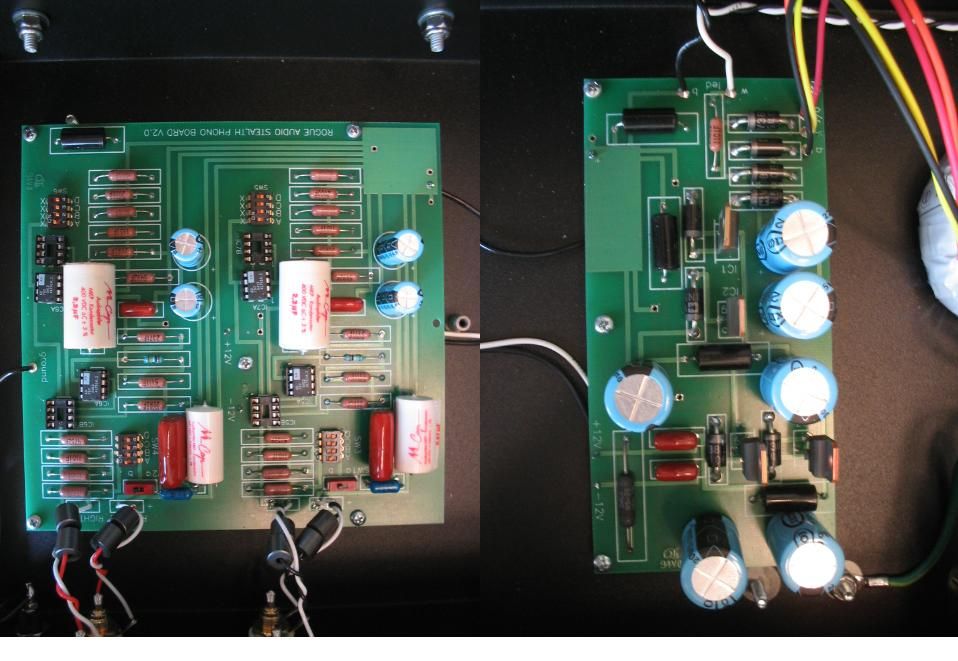

Okay,
There are 14 total caps in the rouge (6 on one board and 8 on the other).
6 electro caps on one board are Xicon 2200uf 25v
4 electro caps on other board are Xicon 100uf 100v
2 coupling M-Cap?? (Audiophilier MPK Kondensator) 400VCD 2.2uF
2 couping M-Cap?? (Audiophilier MPK Kondensator) 630VCD .47uF
Does that help you out?

Yes the electrolytics are quite cheap and definatly worth replacing. I know the 25 volt ones could easily be replaced with a 35 volt rated Elna Cerafine or Nichicon KZ, though I'm unsure of exact available values. As for the 100 volt, you would have to look around, but again, I believe there are plenty available. Those caps are definatly worth replacing and the options I gave would be a clear upgrade with a small cost. If you are willing, Blackgates are said to be better, though I happen to disagree that the stander series are any better than the Elna's mentioned. On the other hand, the bipolars are quite good and worthwhile if you can afford it.
As for the film caps, Those are the bottom of the line Mundorfs. They are quite good, and you may want to leave them alone. However, there is better. Those cost about 3-5 dollars each. You could replace the .47uf with a teflon from someone like V-Cap, Relcap, or Sonicap. The 2.2uf could be bypassed with a .01uf but only if its not in the RIAA cuircit. It will be far too expensive to get a very high end cap in that value, so I would either leave it alone, or upgrade it to a better one, but not so good as teflon. I believe that 2.2uf would be far too large a value to be in the RIAA cuircit, and so bypassing it with a .01uf teflon is a fine option. Otherwise, I would consider the Mundorf Silver in Oil or Oil and gold caps. Sonicap Platinum or GenI or Gen II would actually be an upgrade. Relcap also has some selfbypassed polystyrene's that I happen to really like and would also probably give at least a change in sound, if not an improvement.
Now that I know it has Xicon caps, I would also begin questioning the quality of the resistors, which can play a role in the noise floor of a low level device like this. They also can impact sound, arguably. I find them to be the biggest PITA to replace, but worthwhile if you are going all out. I would look at those, you won't know the brand, but depending on budget, I would consider replacing the critical ones with Cadocks, Vishay's, or possibly Riken's. Also, certain ones worth replacing are the RIAA stage resistors, but only for accuracy purposes, to ensure as accurate a curve as possible you want to match the resistors in each channel as closely as possible, and as closely to the specified values as possible. This is where a schematic will come in handy if you can get one.
Before I forget, power supply mods are always worthwhile in my opinion. More than likely the 2200uf caps are power supply caps, and I would recomend bypassing them with a film cap rated at .1uf and atleast 35 volts, but most film caps are rated quite a bit higher, so thats not a major issue. Some would argue that increasing the power supply capacitance will improve sound, and it might, but I think that giving a low impdenance current source is more important than capacitance in low level devices like this. I would say its worth increasing if you could tell me more about the style of regulatin being used, but without knowing that, I would be concerned with increasing it. None the less, its also an area worth looking at. Also, check to see if the opamps are bypassed, if not, bypass the power supply rails directly on the opamp. I recnetly did this with a .1uf Wima film and foil cap. I highly recomend it, its cheap, easy to do, and made a noticable improvement.
Again, look at the regulators, find out what the voltages are being regulated there, and look into upgrades. Depending on your financial situation and ability, its worth upgrading. If you can make a Jung regulator, consider that, if not there are lots of good prebuilt tables. Consider the Burson regulators or Audiocom. I think they really can offer an improvement over the single IC based regulation used on most mid priced components.
Beyond those mods, the only others worth maybe looking into, and I would do these last, and only if you really know what your doing, would be to have a custom wound transformer, say from Plitron, that has the voltages you need, but at a higher VA rating. It's probably not worthwhile, but if the transformer is not very large, it could potentially impact sound. Also, mounting all of the AC components in a seperate box might quiet things down. Basicly I would take the transformer and mount that in a seperate box, then using as short a cable as possibly, also move the rectification to that seperate box, and have a DC line going straight to the phonostage. That is only something I would do after doing everything else. Also, without seeing your phonostage, that may not be as easily done as I just said, but it could quiet things down.

Bypassing does not mean replacing, it means you parallel it, basicly. In the case of the power supply cap, you don't replace it, you parallel a film cap onto the power supply cap. The idea is that it will become a path of least resistance within the all important frequency band, while still allowing the larger cap to filter out everything out of band you don't want. That band depends on the application, which is why I'm using very generic terms here.

Honostly, if you replace the film caps with better ones, replace the power supply caps with better ones, bypass a few, maybe upgrade the internal wire, it will make a worthwhile difference. Beyond that I would say then start looking into replacing the regulators, it will make a difference, but one of diminishing returns. Obviously I hope you have considered or already have tweaked the tubes, that will make a very large difference, on par with replacing opamps, if not more so. Given the sensitivity to microphonics in a phonostage, use as low a microphonic tube as possible, and maybe even consider a tube dampener of sorts.

I don't really do much in the way of mods for other people, at least not as a business. I have done it for friends. Honostly I think I would not feel comfortable, so I would say, find one of the many other moders to work on it for you.
None the less, that is a very simple and easy to mod design, in my opinion. Its a really good setup with some realyl good parts in key places, so these mods wont make the kind of huge differences that some would.
First thing I would do is replace the diodes with FREDS, I like the IXYS brand, but lots are good. Telefunken makes a nice set too.
See the TO-220 style chips on the board, there are 4 of them, I believe those are your regulators. Those are the chips to change, more than likely all 4 of them for best results. Again, I would do that last.
Replace the power supply caps on the board, as I mentioned, that will make a difference I think.
Biggest difference will come from the film caps, replace those with something better. The higher end Mundorfs are excellent, as are the V-caps. Teflon would be very expensive, but also very nice improvement. I like copper foil caps like from Jensen, Audionote, and VTV. I'm also a fan of polystyrene caps from Relcap, and would recomend those. I would also consider bypassing the larger value film caps with a much smaller value teflon cap, such as a .01uf or so.
Beyond that I don't think there is a lot more you can do. I mean, you could try a discrete opamp like the burson, but honostly, I don't know if it will improve things, and it might become noisier. The resistors are good quality I wouldn't touch them unless you just want to change the sound, inwich case I would use Cadock for a cleaner sound and Riken for a warmer sound. Let me know if that helps give you any idea's at all.
