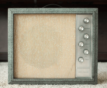

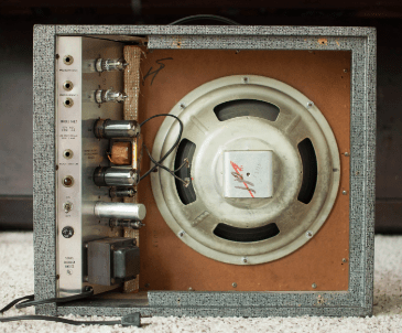

I want to use the mic input as a guitar input. what optionss do I have. It is not worth much as a guitar input the way it is.

Based on the schematic you posted, all the inputs are identical. There is nothing to change.The only thing I am looking to do is make the Mic channel usable as a guitar input.

Just a 68K resitor is needed to make it identical to the instrument input, small mod, just a resistor between mic inputjack and the wire..

Add a 68K 1/4W resistor in series with the jack + (tip) and the grid of the tube.I want to use the mic input as a guitar input. what optionss do I have. It is not worth much as a guitar input the way it is.
The only differences between the channels is the grid stop resistor.
Considering the OP may only want to do minor component mods, without doing extensive circuit changes. If the mic input is not usable as a guitar input "not worth using"..but really no indication of what they want it to sound like. What can be modded? You can change the anode resistor on the input triode, change the cathode resistor, or add a bypass capacitor across the cathode resistor. Change the capacitors on the tone control or coupling capacitor at the output of the first stage triode mic input. Everything else will be starting into a major refurbish of the phase splitter and power amp circuit.
So you have only the input stage triode for the mic circuit to play around with.
When someone says it's not worth using, then I would ask what the problem is? is it crappy sounding, weak or noisy? Has the amp been properly serviced and all the tubes have been checked and/or changed? Start with a proper going over the amp, and evaluate exactly what the issue is before proceeding.

Between Single tone control in pre.
And however the speaker sounds
is most the voicing you get.
If looking to stay original.
Can really only change the tone control caps.
Likely fine as is, unless it sounds in very odd place.
otherwise you would just increase gain.
and add high pass like any other guitar mod.
But for something like this. adding gain
kinda silly.
